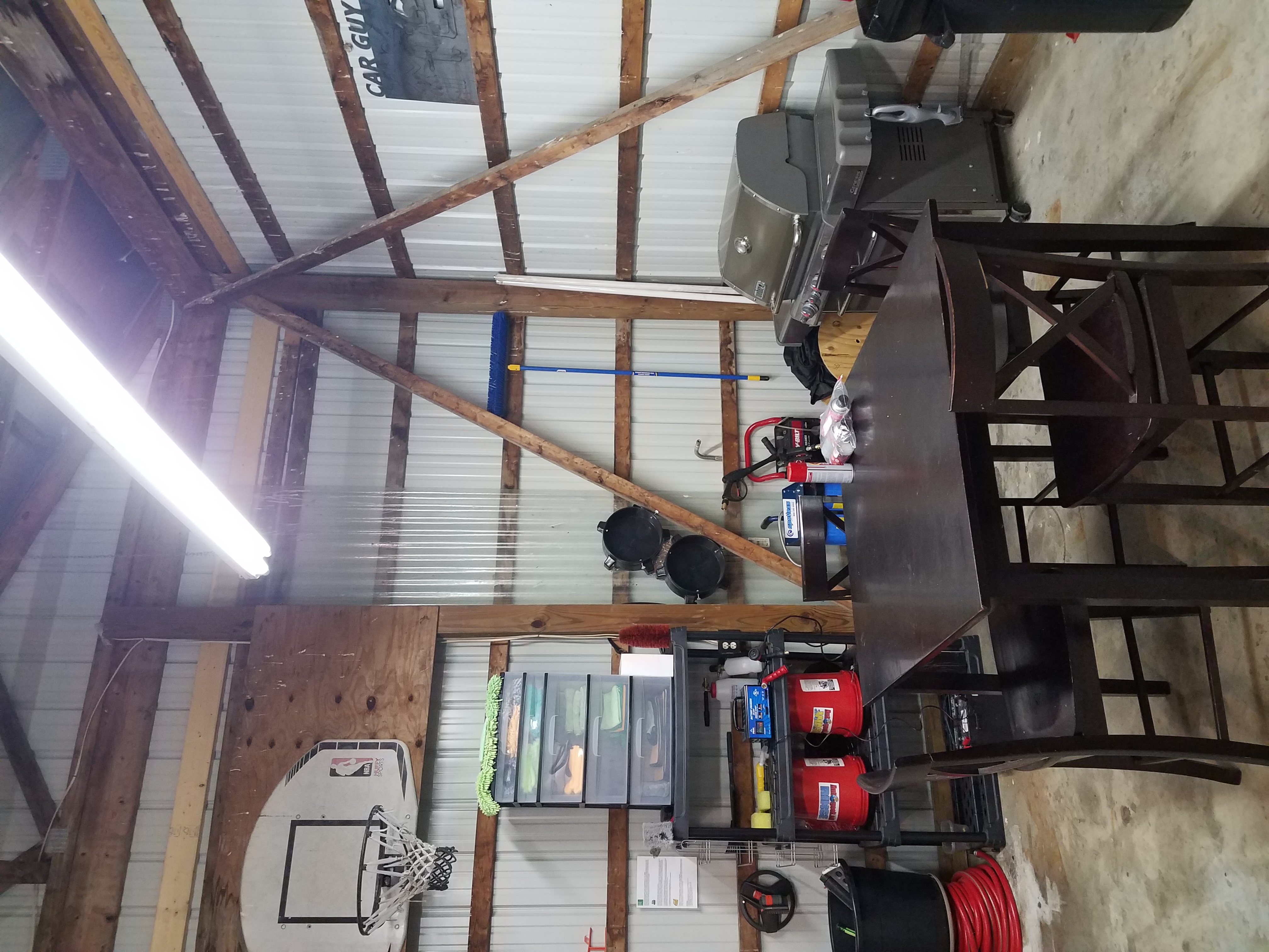

Here are some pics of what I'm working withard. Looking up, it's perlins, foam board taped tohether, then metal roofing. Foam on both sides of board. Attached are some pics of the walls as well. Not sure why the corners have those long 2x4s.
/ Heating Ohio pole barn
#20
My plan is to add an actual ceiling. Would I still need to change the current roofing structure?
