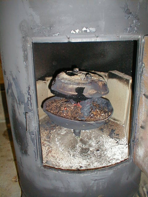

   / Heating with waste oils #25
I used an electric one. A gas one does have the pipe already in, but it is attached to the tank so all work on that part would need to be done through the door, which on mine is 10 by 12 inches. My pipe is loose and can be lift up with the funnel, giving access to the burner, which does need some cleaning from dirt in the oil. I also attached the burner assembly to a steel plate that is in the sand of the tank. Easier to remove and work on if needed. Planned ahead just in case. I have only cleaned mine once in about 15 hours of burn time. Yes I did cut it down to 3 feet, the plans said they used a short tank. Does a long one make any differance, don't know.
Made the holes in the top pan larger to 5/16 instead of 1/4 inch. Smaller holes were getting plugged with residue from the oil. Since then they seem to be keeping open.
The flue was oval because tank is only 16 inches in diameter. Next one will be aleast 20 inches
Leaving the burner alone would be a personel issue. It could get burning to much and get out of hand. I don't mind leaving it go for an hour or so but I like to keep an eye on it.
The straight kerosene question, not to sure on that.

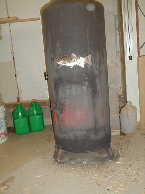

   / Heating with waste oils #27
Here are some photos, One shows how hot this will burn, sides were this red hot after about 40 minutes after start up. Let the flow go full just to see how hot it would get. I backed off at this point. The other one is burner assembly inside stove with funnel lifted up showing residue after about 6 hours burn time.

   / Heating with waste oils #28
here is the burner
   / Heating with waste oils #29
That fish ought to be well done./w3tcompact/icons/wink.gif
   / Heating with waste oils #30
Hope you don't mind a couple more questions, so here goes:
1. Did you say you cut the tank down? If so, how were you able to reweld it. These tanks are pretty thin. Did you have to do something special? Where did you cut it?
2. Your door frame looks awfully neat! Does it seal well? Did you follow the "Mother's" instructions on this for the door framing or attach something more or different?
3. Do you think most of the flame is occuring on the burner, or is the oil splattering enough that the entire lower section of the stove burns?
4. Your earlier photos shows a lot of red in the lower portion of the stove. It even looks like the section you have blocked with firebrick is red. Is this the case or does the brick pretty much stop the area behind it from getting too hot.
