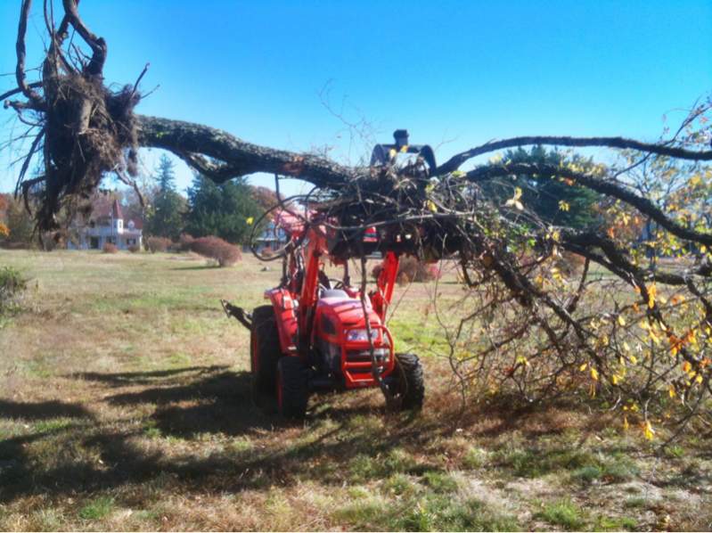

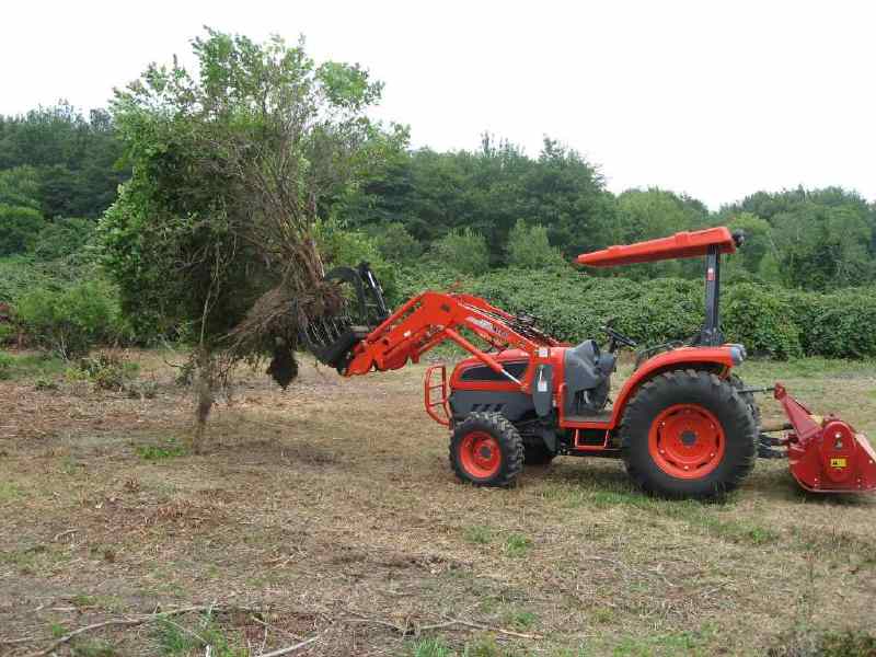

Here is my latest capture with my 48 inch Millonzi (weight 280lbs). I could only lift the stump this high and as my loader is rated for 2700lbs to full height at pivot pins, I'm guessing this stump weighed something close to 3000lbs. If my grapple weighed 500+lbs, I probably would not have been able to lift it and move it.

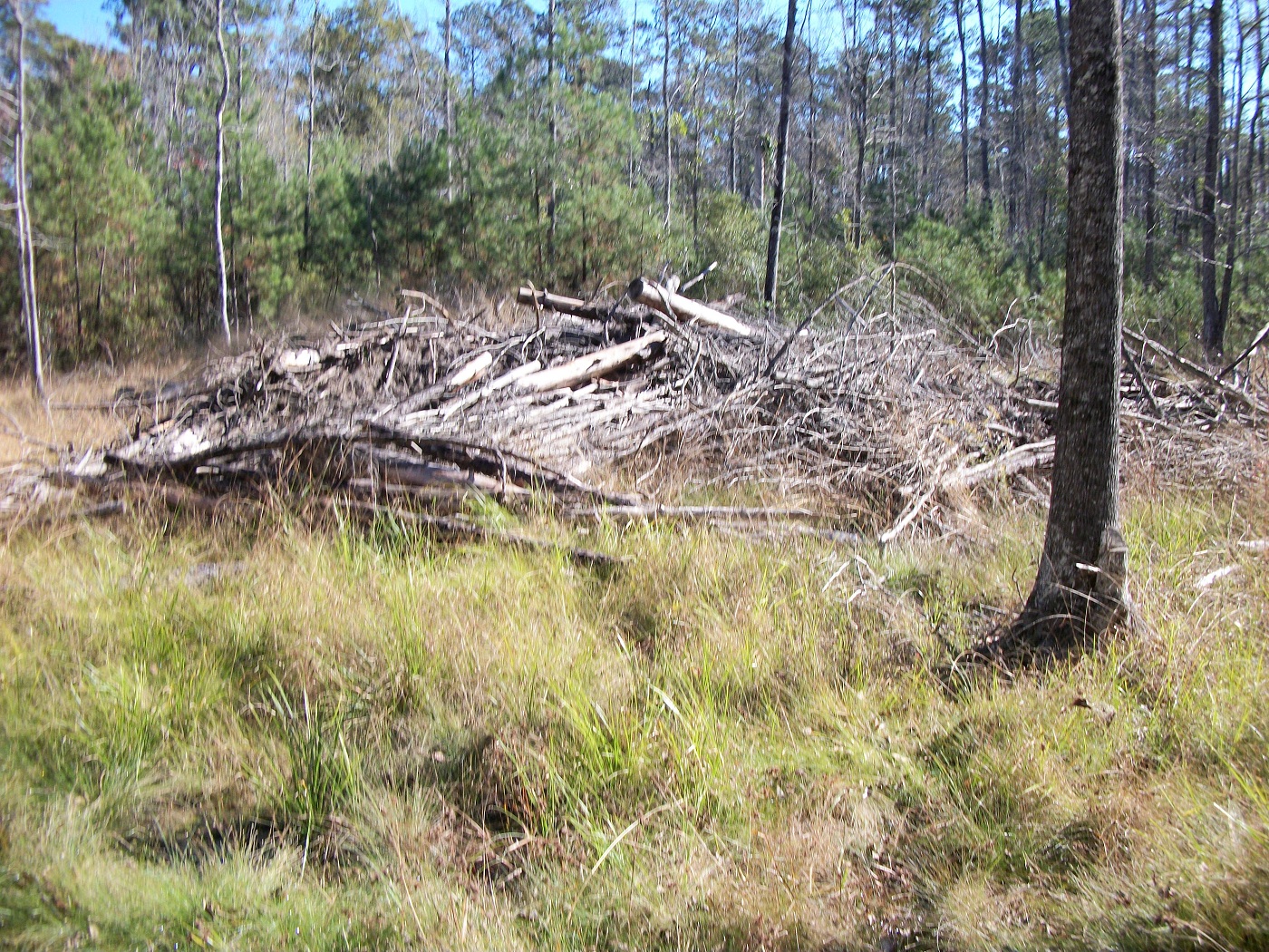

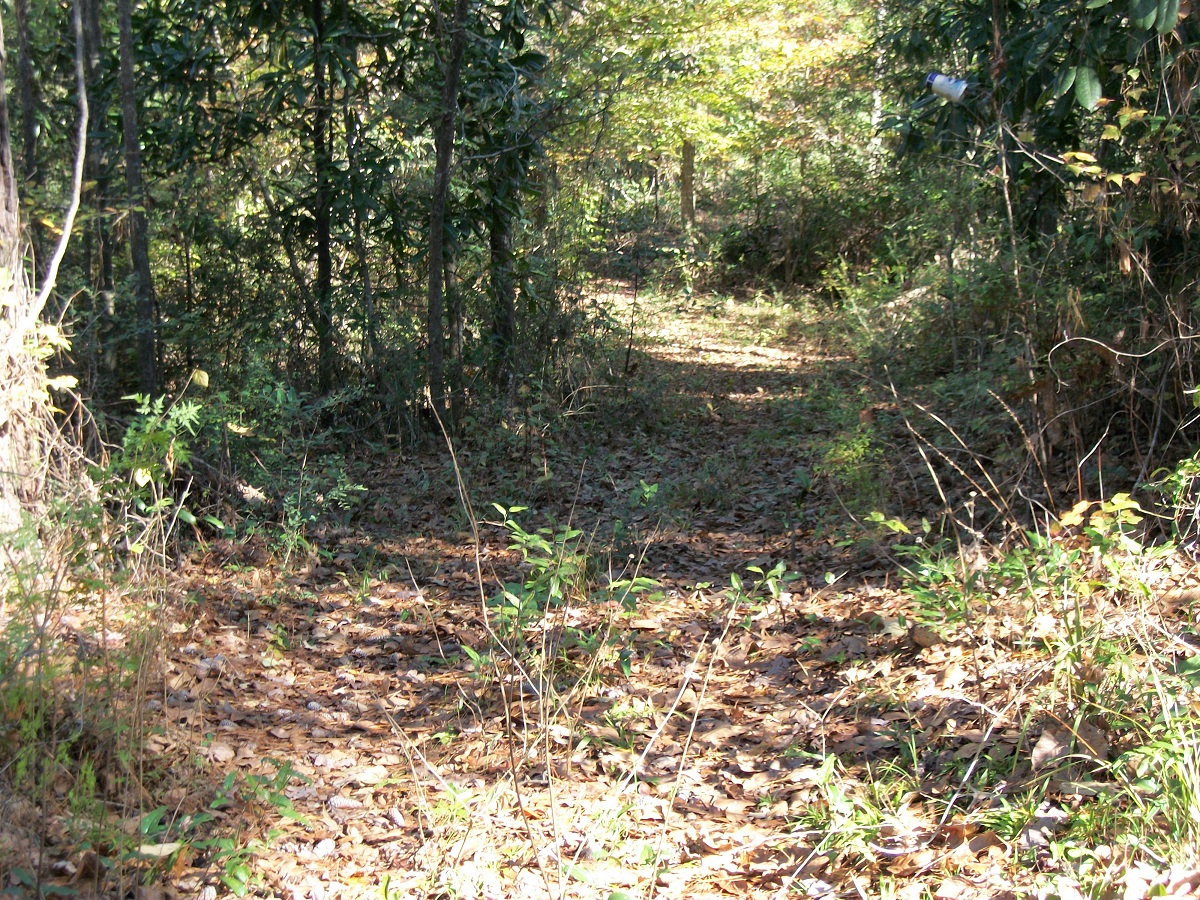

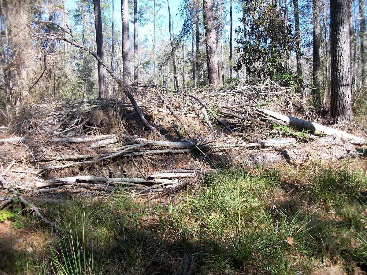

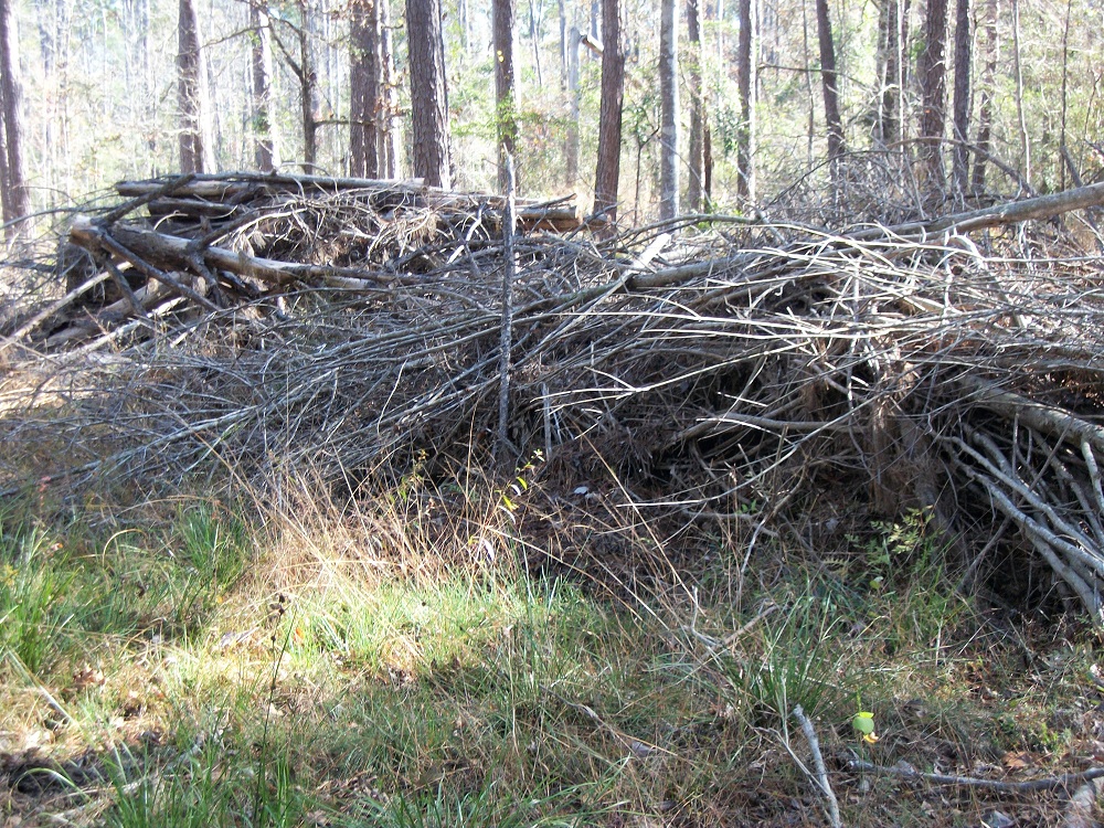

Hey IslandTractor, i've hear ur the "goto guy for grapples" The land, I'm working on is riverfront..soil conditions are soft..flat..and no rocks. i'll be picking up mostly dead pines,clearing small brush which pushes up with just the bucket and clearing trails throuhout property..trying to post pics of brush piles to give you some idea of what i'm dealing with. Your opinion would be greatly appreciated!
I would use a light duty 48" grapple for that work. Benefits over larger grapple are clear: 1) cost 2) manuvering in wooded area, 3) brush sticks together in a grapple so you can lift and transport a six to eight foot pile of brush even though the grapple is narrower, 4) net lift capacity with a light grapple is higher, 5) none of your tasks suggests strains or wear beyond the capability of a light duty grapple, 6) small is beautiful.

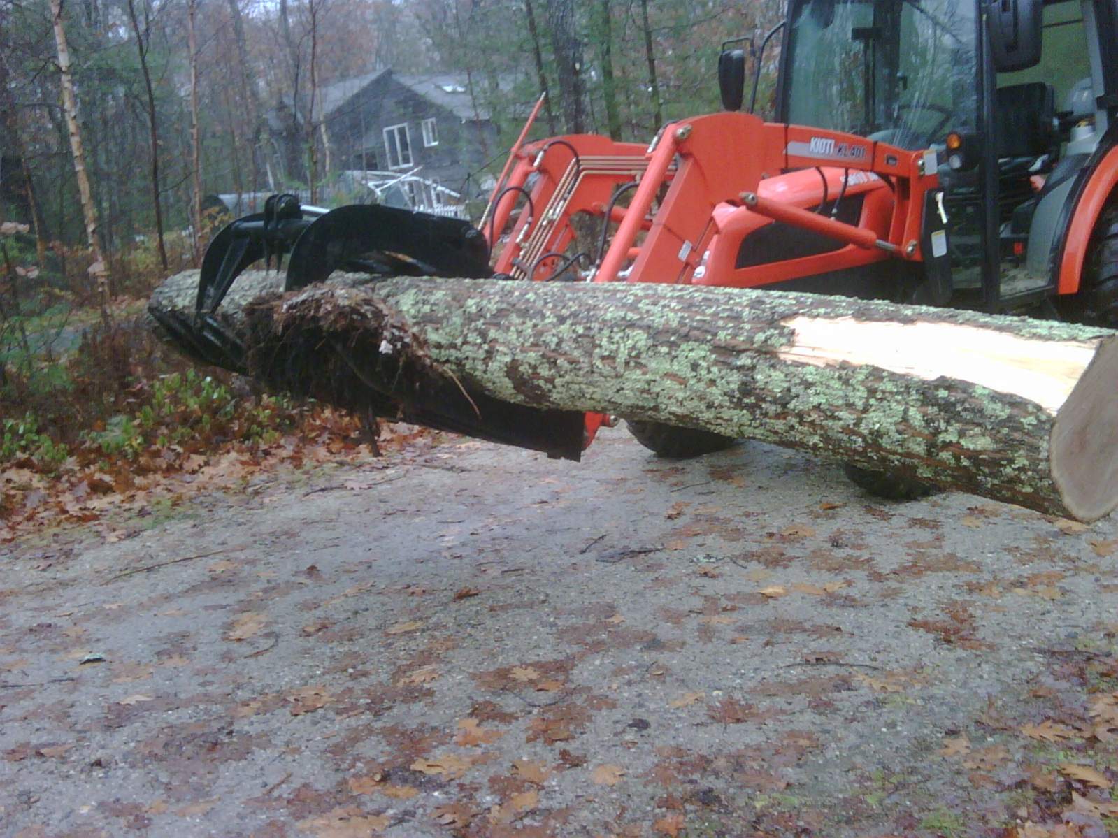

I purchase the Gator 60” light duty, which I believe was a good compromise between 48” light duty grapple and a heavier grapple. The 60” Gator grapple is the larger version of IslandTractor’s 48” Markham grapple (Markham was sold to Gator). If you decide to purchase a Gator grapple I highly recommend you contact Jim at Jeb Supply Co. (717-729-1056 or jebsupplyco@pa.net ). Due to their volume purchases from the factory you can normally get a better price then going direct to the factory. You can also find Jeb Supply on Ebay.
To give you an idea of the strength of this grapple I attached a picture of a large log in the grapple. This red oak log is over 18' long and greater then 24" in dia. I have also moved many loads brush, logs, and stumps using this grapple. I had no problems getting stuff in my tires. Due to the distance I need to travel to dump debris I normal move large loads which requires me to keep the load low. I have used the grapple to rake roots and the soil in my area has a lot of clay. Raking did not work well until the rear tire were load. I do recommend adding extra tines to the rear of the grapple to prevent logs and brush from poking through and possible damaging your tractor. I definitely prefer a single centered thumb over two thumbs. The single thumb and the small custom teeth Gator add to the thumb makes it easier to grab the end of a log or tree and back out of the wood in to a cleaning for easier cutting and loading. If you add the small teeth make them thicker, not so pointed like mine are. After several weeks of use the small teeth look like a red neck in need of a serious set of braces.

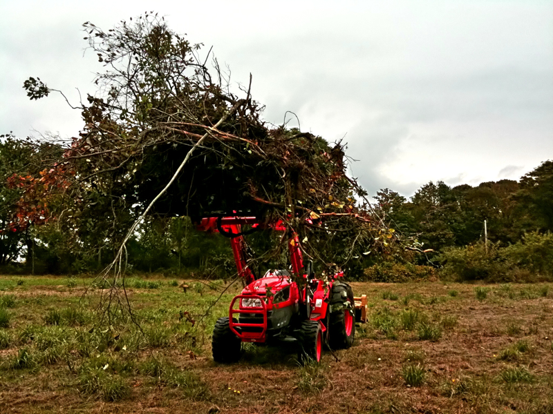

FYI, my grapple is a Millonzi, not a Markham. Note the curved lower tines. Otherwise construction and weight are very similar but I like the better engineered design of my lower tines better. Not sure why Markham/Gator don't do that as they clearly use CNC cutting equipment.
Jake is partially right about the width and visibility. If I take a really large load that I have not bothered to compact, it can have 6 or more feet of dangly brush hanging out either side. The vines sometimes will catch the tires and that pulls some of the brush out of the grapple so I just lift it higher. A wider grapple with brush hanging out the sides would probably not do that except when you made a turn. I only move brush about 200-400 yards so I just lift it and look under the grapple at where I am going. Even with a fully enclosed (nothing hanging over) load of brush I need to raise the grapple to be able to see anything 20 feet in front of the tractor so I routinely raise the grapple so I can travel with better vision. I don't think a wide grapple would be any better for that issue.
