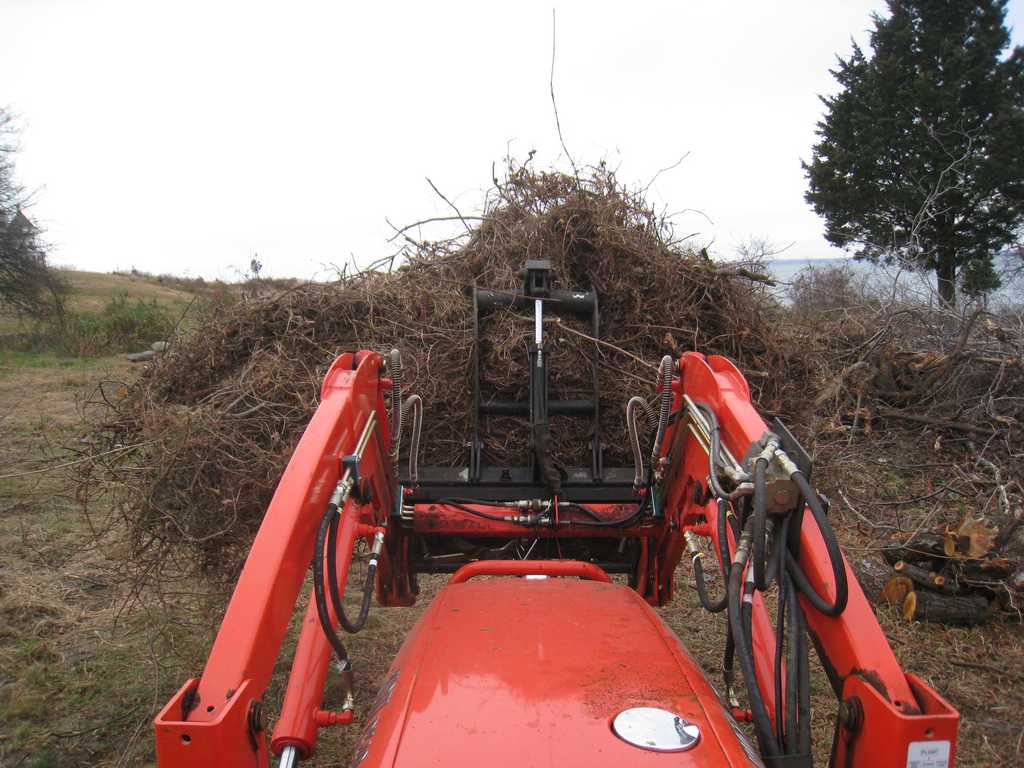

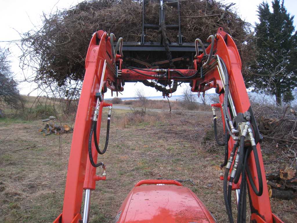

Regarding Jake's point about needing to raise the grapple to travel...here are a few photos that demonstrate what I was talking about regarding needing to raise it to see regardless of grapple width. With a full load of brush you just cannot see where you are going unless you raise the grapple. I don't raise it high, just to the intermediate position. If I am on a slope I keep it low and peek around the front tires to see where I am going (slowly).
As usual everyone's situation is different. I do not need to raise my loads high because I'm driving down a tree lined path or driveway so I don't need to see immediately in front of the tractor. As long as I am between the trees I'm on the path. Also the path and driveway are somewhat smooth so I do not need to be concerned about uneven ground catching the grapple. Because the load is low I can see 75 feet in front of the tractor so I can avoid the random drunk moose! :D
