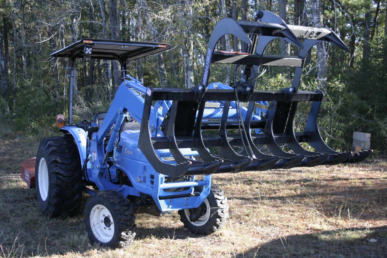

About a month ago I bought a cheap light-duty Versatech grapple at an auction for $600. It kinda looks like Island's Millonzi, but is 66" wide. Haven't got to test it out as I still haven't installed the SCV kit I bought last summer. From the beginning I assumed I would cut off the 2 outer tines to convert it to a 48" grapple to save on weight on my little 28 hp CUT. Maybe now I'll just leave it as is to see if the weight is really that much of a problem. Have to admit though that I find Island's arguments for a smaller grapple to be pretty compelling and see a likely modification in that grapple's future.
I think you'll be glad you waited on the torching, I am.
