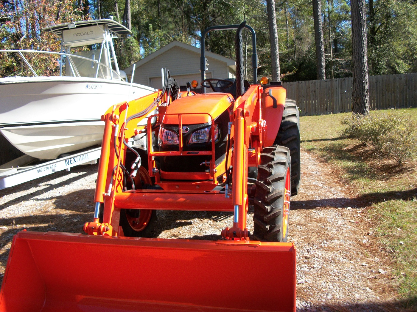

The new tractor has made it home but... i have yet to pull the trigger on a grapple. In my prior post... weight and lift capacity were slightly off...okay a lot off.
Lift capacity at max height 2469 lbs
Lift capacity at 5 feet 3210 lbs
weight of tractor with FEL 6681 lbs

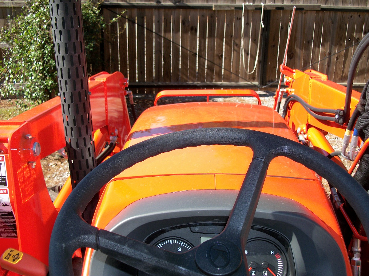

Are there any disadvantages with a 48" grapple on larger tractors as for as being able to see the grapple?

   / heavier grapple or not #83
The grapple size is not the issue here but rather the distance and height from the grapple tines from the operator station. I could see better with my smaller Kioti CK20 than I can with my DK40se but it is due to the size of the engine hood not the grapple.

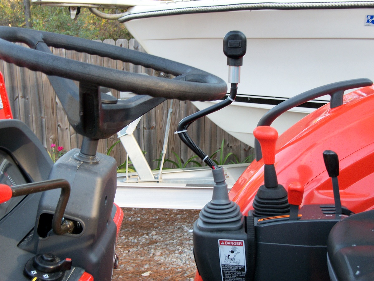

   / heavier grapple or not #84
Nice tractor. What happened to your loader handle??
#85
It's just a Kubota engineering Oops...The bend in the loader handle gives clearence for the gear slector handle. However, the new location of the loader joystick is much better than the old placement...which makes the operater reach forward for the joystick.
   / heavier grapple or not #86
The visibility of the grapple tines from the operators seat are somewhat of a challenge when operating my tractor. I can see the outer tines fairly well on either side of the hood and will get along ok for most work so far. But....I constantly have to shift from one side of my tractor hood to the other to get a look at whats happening out front.
But, seeing at the center (of a bucket or grapple) requires standing up...which shuts down my tractor (and requires me to remove my seatbelt). :mad: It's worse with a bucket for me as you cannot see through it...as you can with the grapple.
Something I wish for is a button to temporarily over-ride the seat shut-off switch....while I stand-up to have a look. And....maybe another button to replace my seatbelt? ;)
In years to come we will all have camera's and screens to let us have a better look. :thumbsup:
