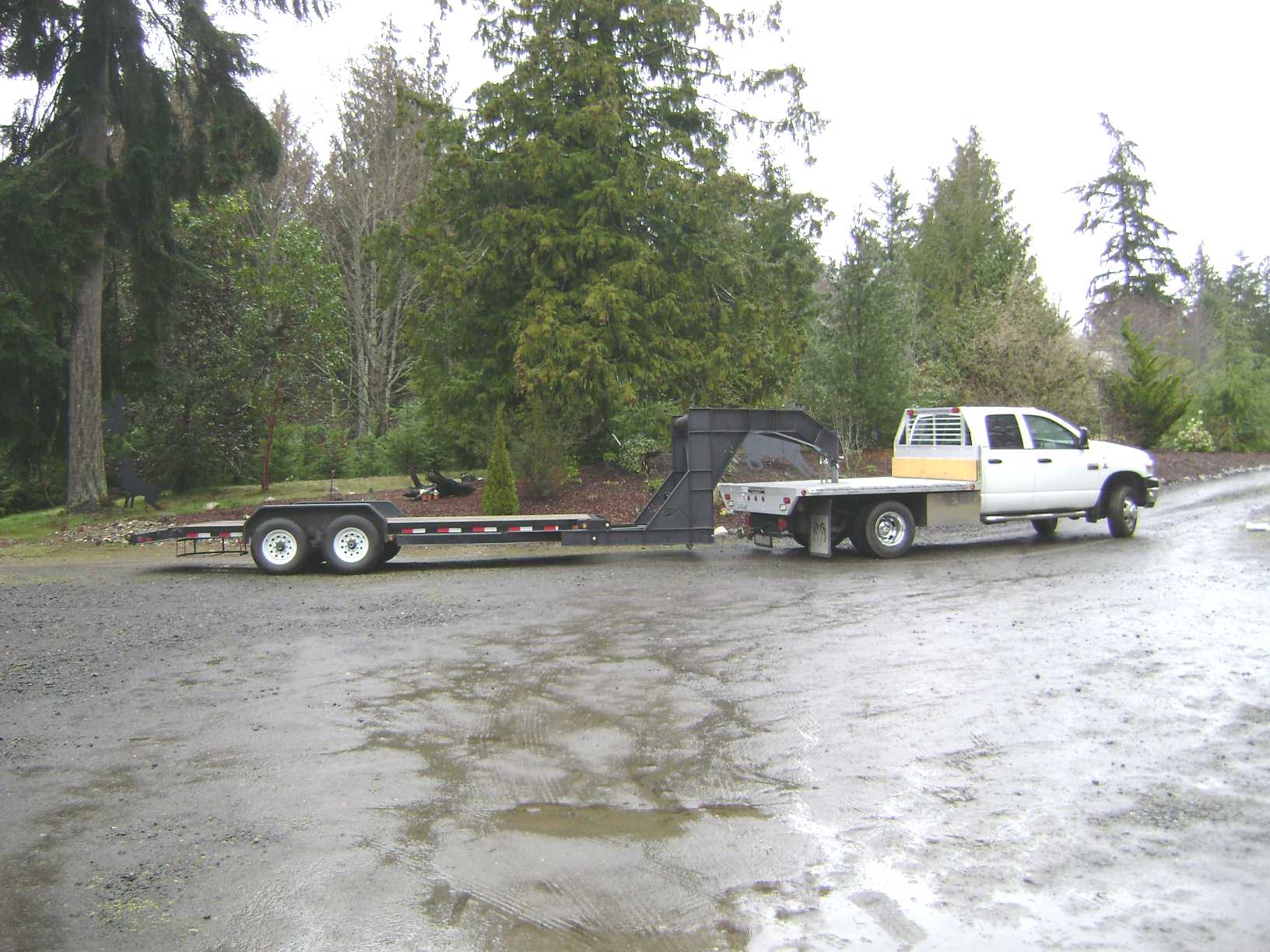

What do you end up gaining other than better weight distribution and turning radius?
They do turn nice and tight. Another big advantage is you can put so much weight on the rear axle of the tow vehicle.
