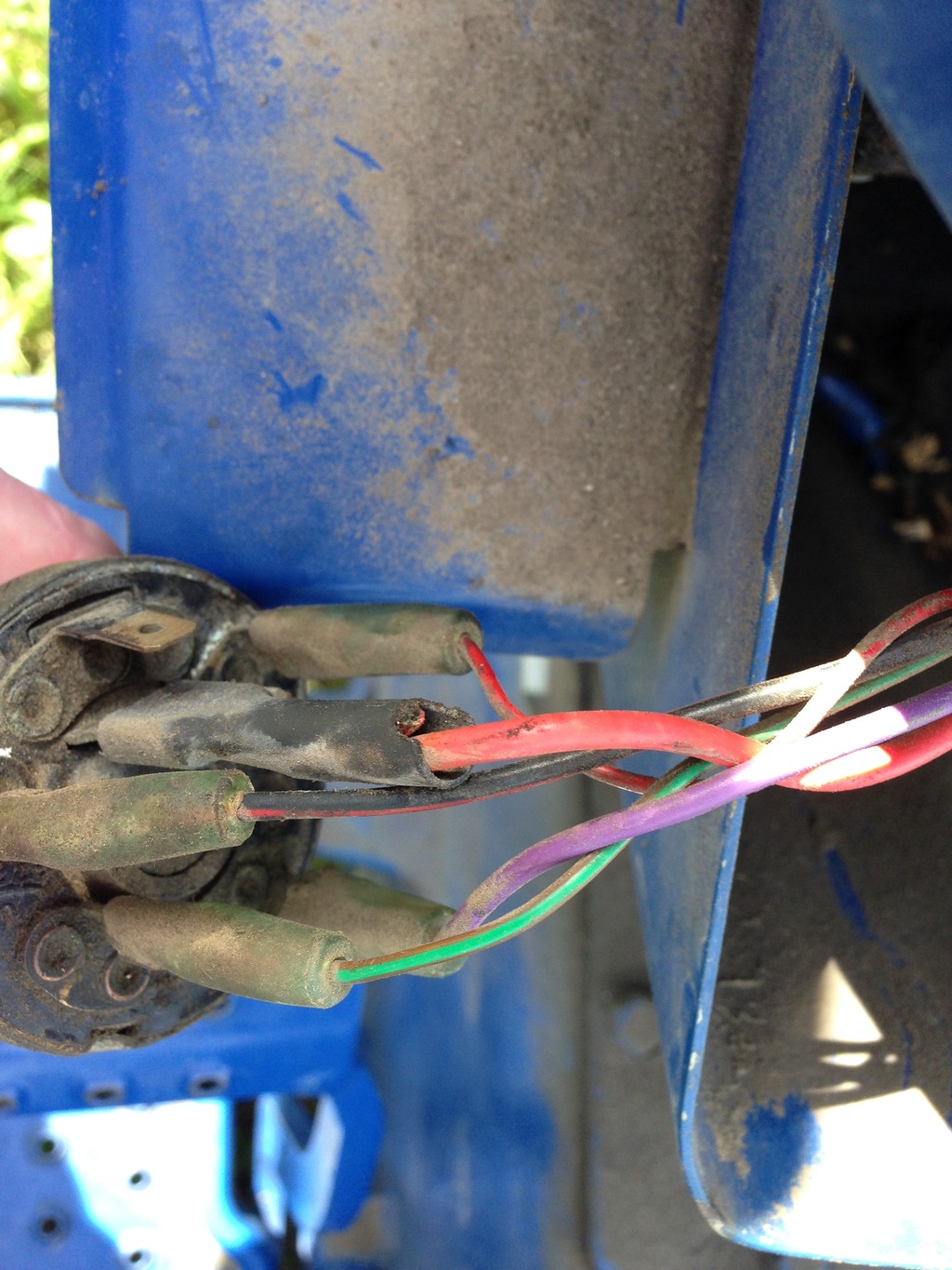

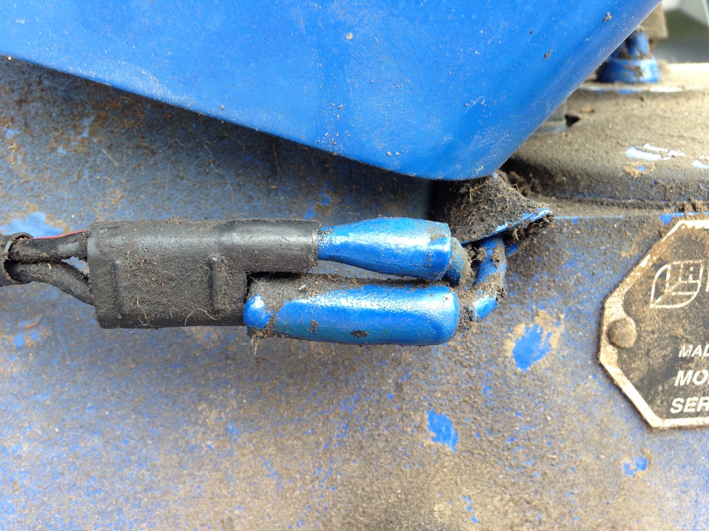

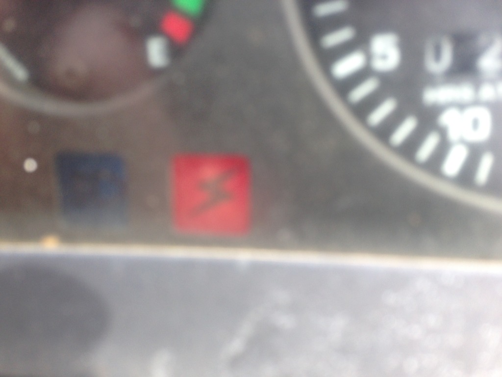

I have some pictures. Now, I have no photos of the starter/cables because I don't want to pull the filters and break loose the steel lines until I've tried everything else. Trying to diagnose an electric problem AND bleed the system is too much to deal with, right now. But it may come to it. IDK if these pictures will help, but I've got a little more information to add, also.
This is the NSS. I pulled the leads off and tried cranking. Nothing. I jumped between them. Nothing.
Ignition switch doesn't have any external signs of problems. That cut wire you see flush with the boot on the IGN hot wire was like that-and I bought the tractor new. So, that shouldn't be a problem. Guess there was a universal harness that didn't require another wire for this model.
The only light that illuminates. None of the working lights work.

You may have clutch & brake SSes too but NSS seems not the prob. If any of the connectors on the IS can be pulled loose easily with two fingers they could stand to be tightened up. (slide back cover & pinch slightly)
Battery ground cable can be loosened at frame or engine, squirted with Kroil or Blaster & re-tightened to be sure of good contact. A 'star'-type lock washer can be added & the connection greased once tightened. There may also be a start relay to check, but if the solenoid can't be jumped I think we're past that. (suggests batt gd vs pos fault)
Ignition switches can wear out. Hoping a new one is your answer. :thumbsup: Still here if not. :)
