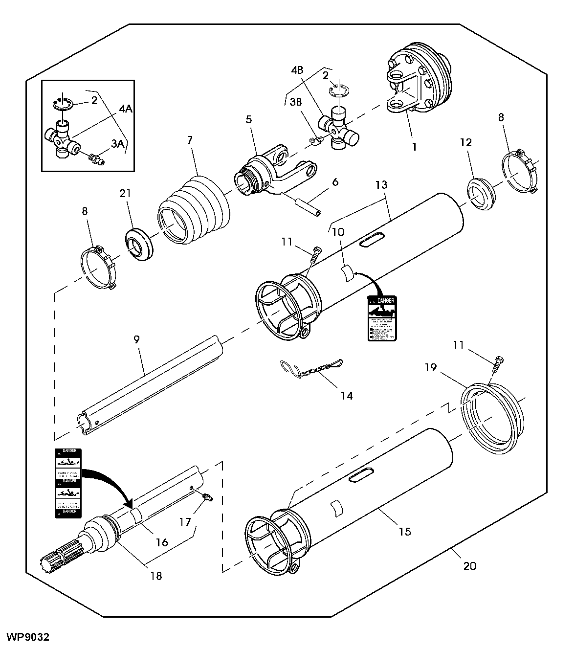

Does the bolt go through a notch, or is it merely tightening the yoke around the shaft?
One might be able to add a large fender washer around the PTO shaft as a spacer between the yoke and the guard provided it had something to ride against (is that the part 15 spacer?)

Are these all original parts? It looks like they have replaced the yoke or forward drive shaft with the wrong one. I think the bolt hole in the yoke should be further forward. Is there any movement, forward or backward, of the shaft in the pedestal? Maybe there is a spacer, key 15 (1st drawing), missing or installed wrong?
I totally agree about the spacer! I was just looking at jdparts.com like 20 minutes ago investigating. No movement anywhere I can tell. I think this explains the squeak I heard, too.
I'm going to try to go to our land this afternoon and I'm just going to take off both shafts and the pedestal and take the whole shebang to the dealer tomorrow AM. I'm pretty mechanically inclined, but with the 14mm nut missing by a third I wouldn't know where to begin fixing this in the field.

The bolt with the sheared nut is tightening the yoke. Not sure what you mean by notch?
Look at key 18 in the drawing. By notch, he means a groove cut all the way around the shaft. The bolt will go in the groove and this keeps the yoke from moving forward or backward on the shaft. Then yoke will not come off by just loosening the bolt, you must remove it.
Thanks for the clarification. I bet it goes through a notch.
I just got back from my land and I took off the front pto shaft, the plate at the top of the pedestal with the bearing, and the front half of the rear pto shaft all in one assembly. After riding home in my truck bed I looked at it again. Now the bolts and nuts that were shearing each other have plenty of clearance!
Something must have shifted on the bumpy ride over. Now I can see the spindle between the front yoke and the bearing - I see no sign of a bushing (#15 from above diagram) between them as the diagram would suggest. Just the splined spindle. I may be wrong bit ill take it to the dealer first thing in the morning.

It was the missing bushing/spacer! Picked up my driveshaft today. The service manager wasn't there and the guy that I talked to didn't know what was done. I told him what had happened and I pointed out that there was obviously now a bushing on the spindle where there wasn't one before. He agreed.
Mistakes happen I get it. What's more important is what the dealer does about the whole situation. We will see. Ill try to put it on in be next couple of days and may sure it's working right.
