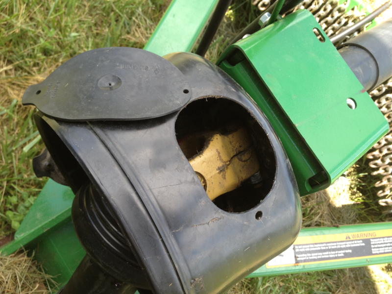

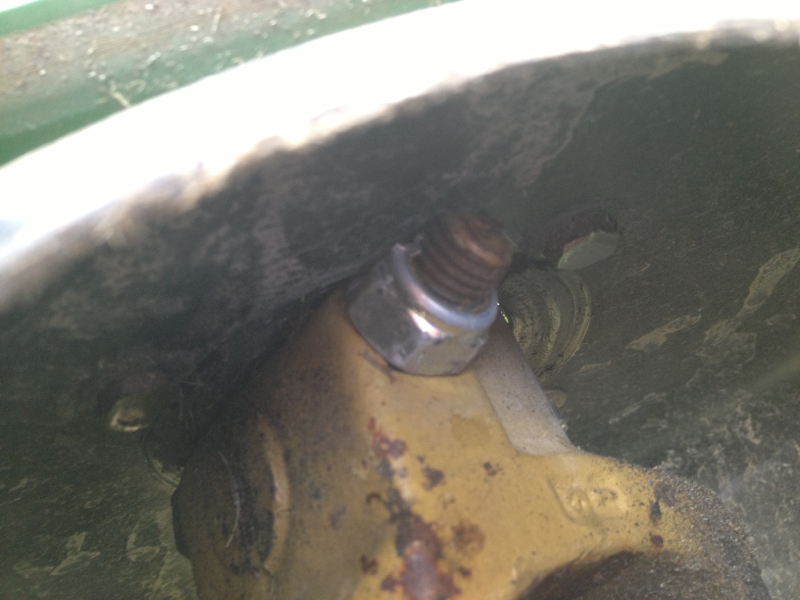

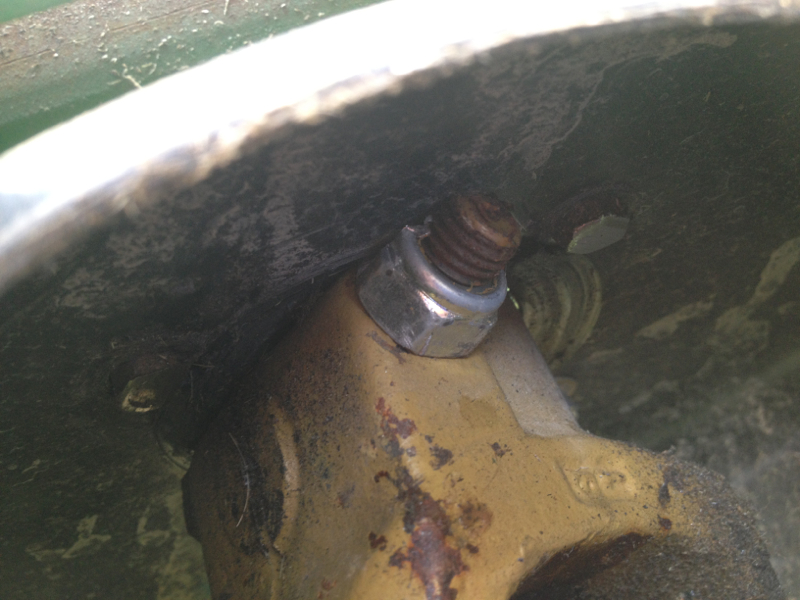

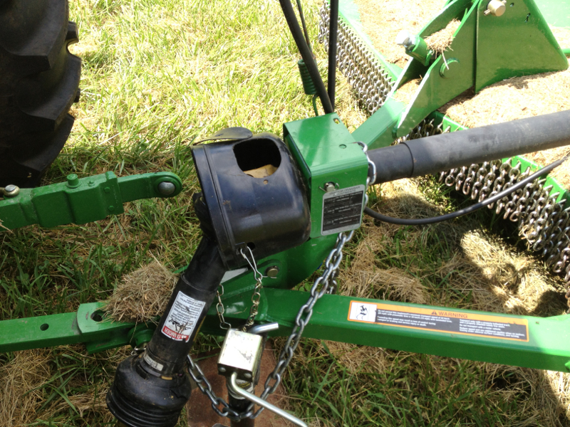

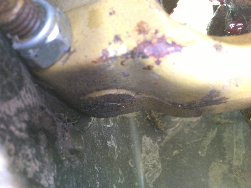

The saga continues. At least the saga with the pto shaft on my cutter. I started noticing an intermittent squeak while using it last weekend. Today I finally had a chance to investigate. I'm not sure if this is the source of the noise but its definitely a problem and I couldn't go any further.
It looks like the bolt on the pto shaft that squeezes onto the spindle was too close to the heads of the bolt that holds on the plastic guard. As it spun around the nut and bolt heads wore each other away.
It seems to me that this shows incorrect installation when they repaired my pto shaft earlier this month. Is there any possible way I could have done this?

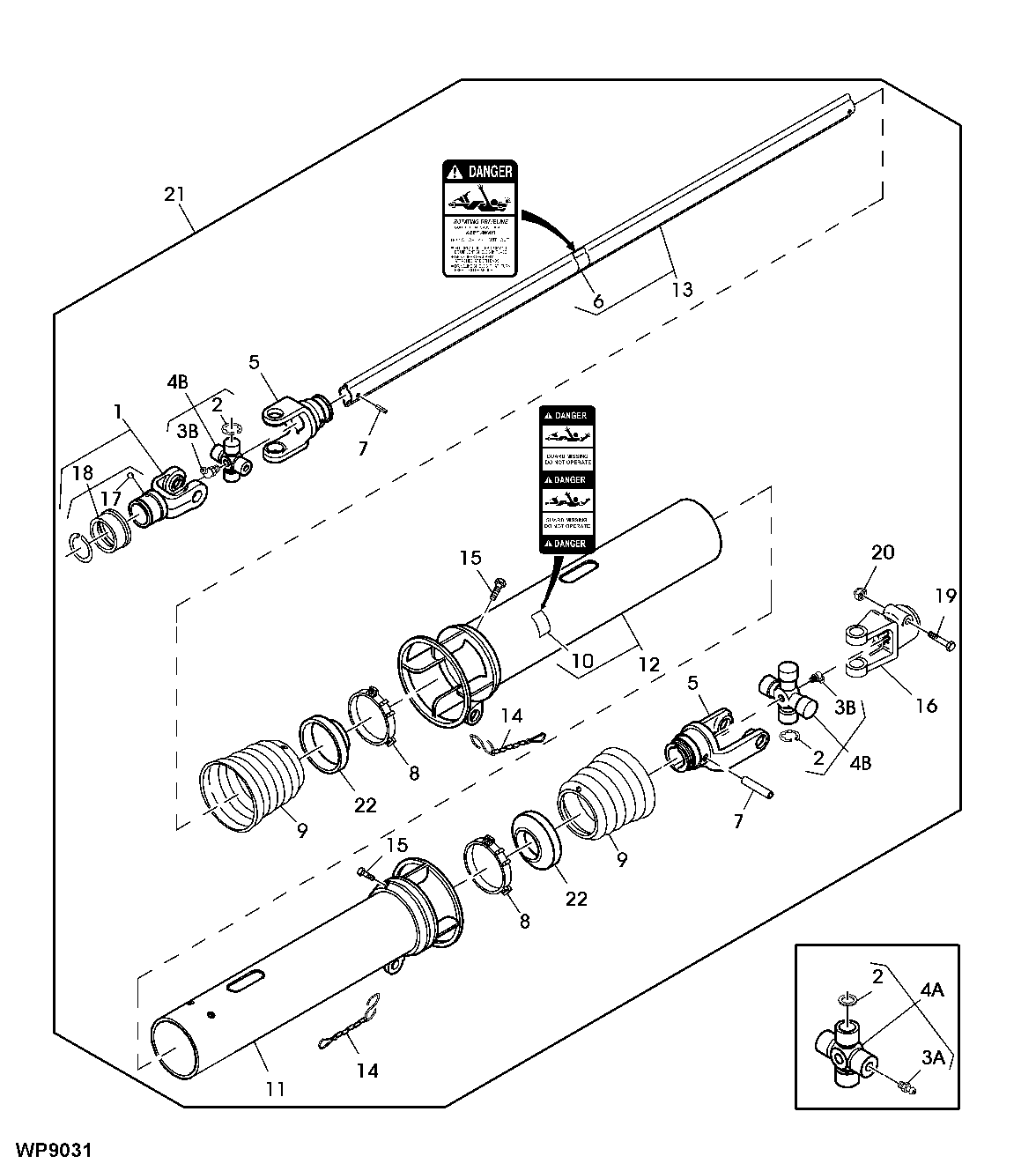

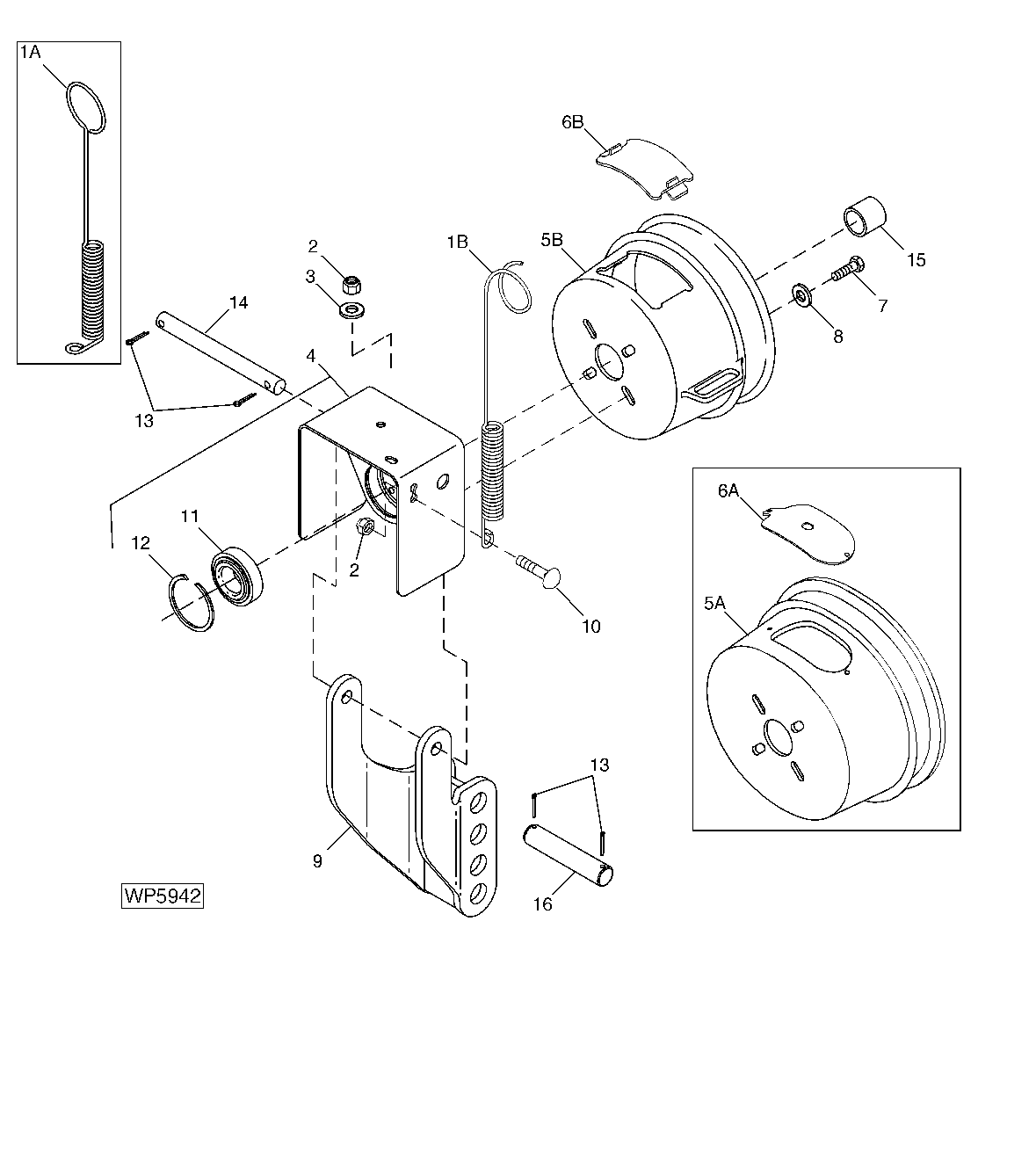

Are these all original parts? It looks like they have replaced the yoke or forward drive shaft with the wrong one. I think the bolt hole in the yoke should be further forward. Is there any movement, forward or backward, of the shaft in the pedestal? Maybe there is a spacer, key 15 (1st drawing), missing or installed wrong?
