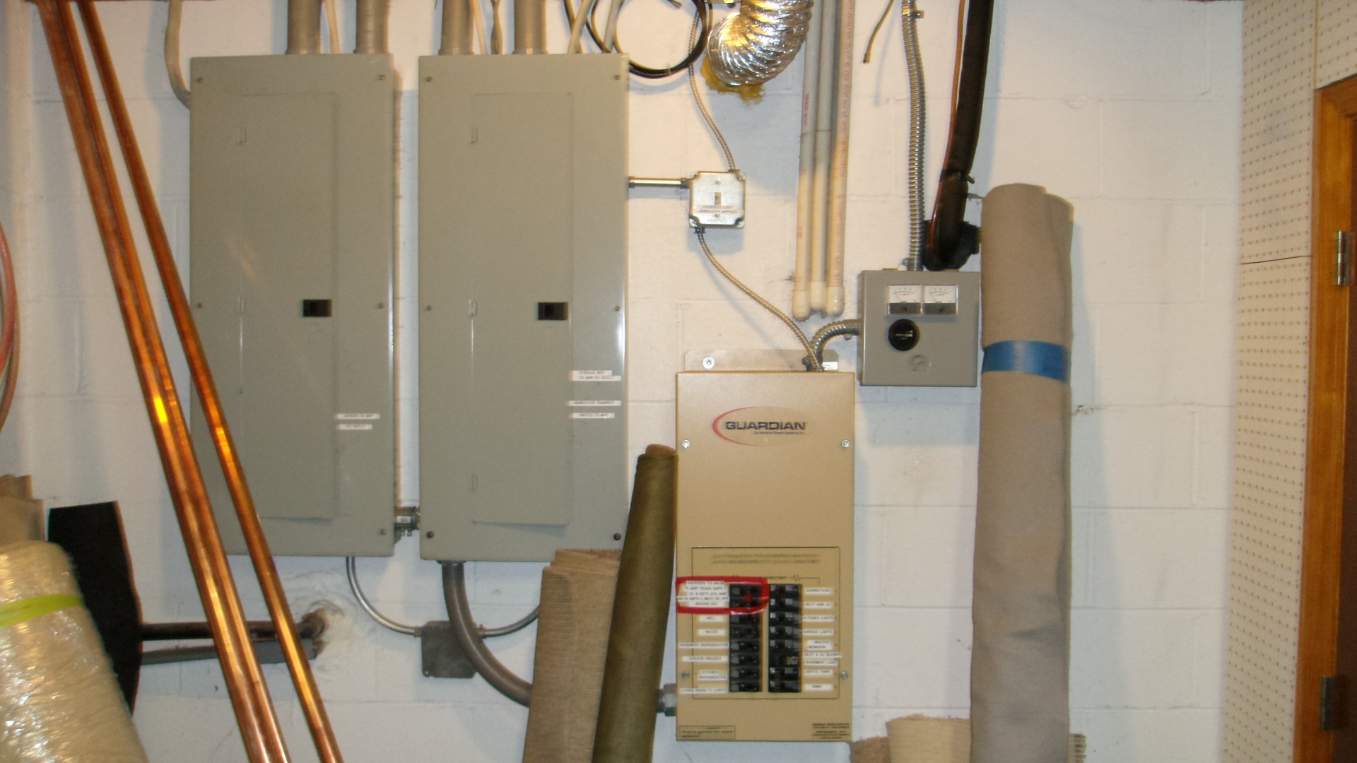

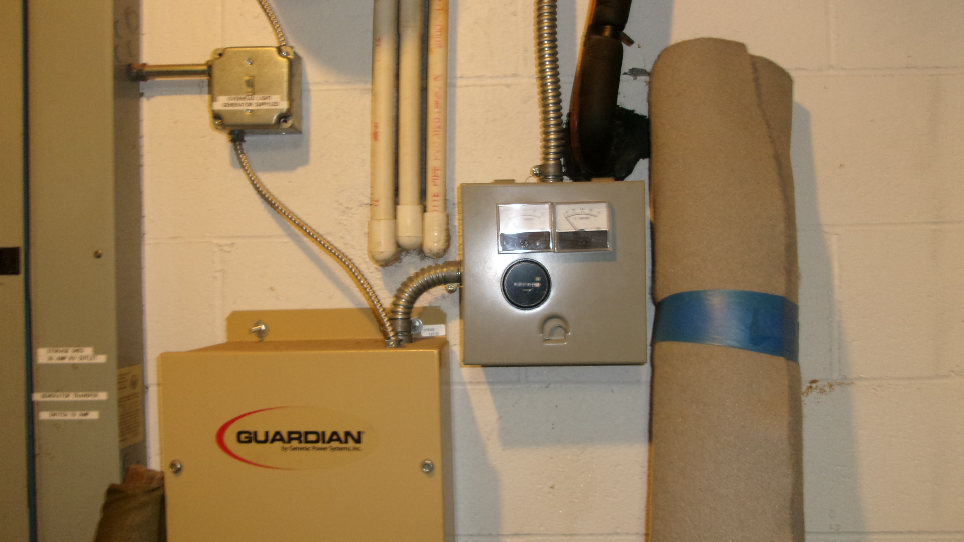

One way to balance load on each leg from Generator. Also includes hour meter for Generator.
