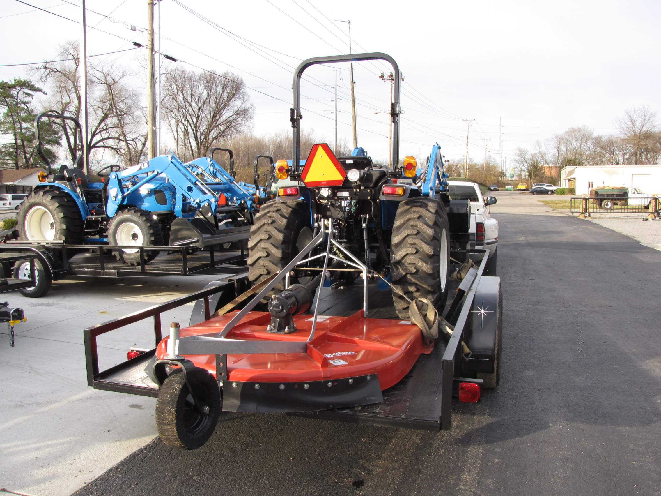

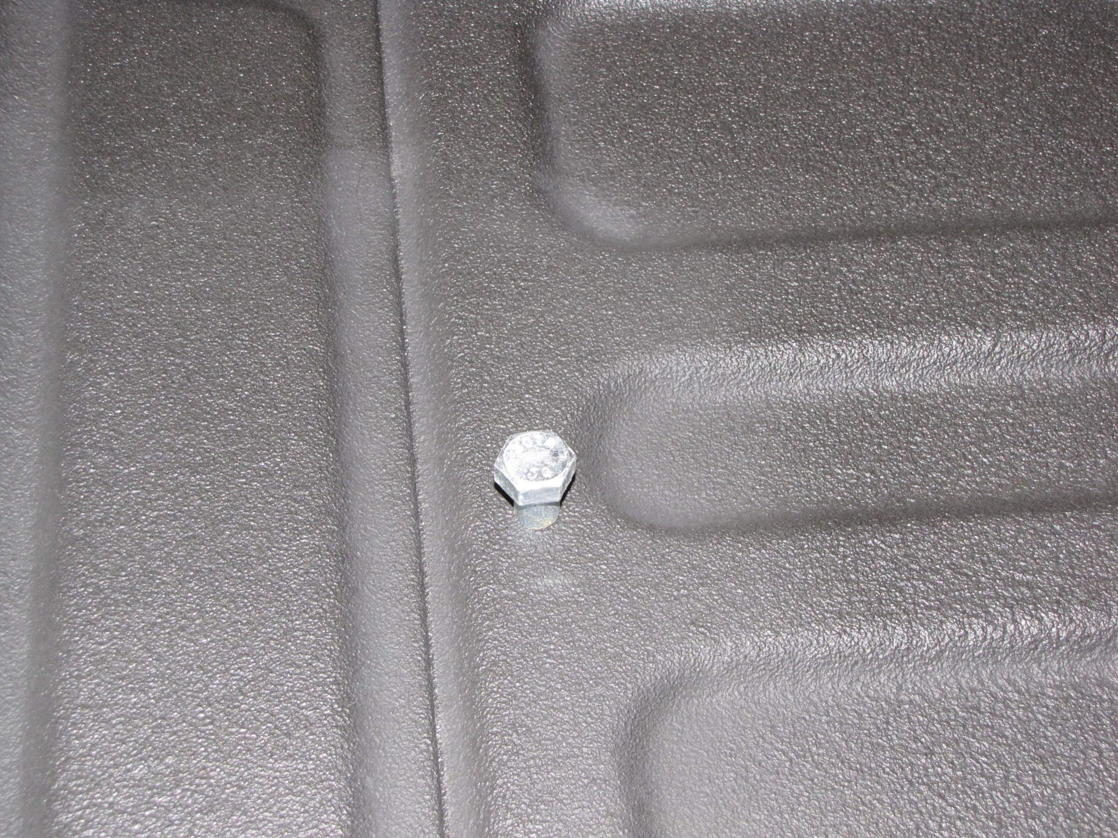

Ran the bush hog ( mdern ag ) 5' cutter for a short time. The shear pin broke. The top of the bolt ( pin ) says 307A and JG. IS this a common part and how hard is it to change?

I'm guessing this is the Bolt that attaches your drive shaft to the gear box on top of your bush hog. I use low grade bolts from the hardware store and have had no problems with them. I guess I will pop one every couple of hours of use, especially when I'm in a new area of the property. Takes maybe 5 minutes to change.

It sounds like your bolt is metric, based on the letters on the head. A standard bolt will have lines. 3 lines = grade5 5 lines= grade 8 (just to name a couple). Anyway, get the correct size bolt and you should be good to go. Make sure the bolt isn't threaded where it goes through the yoke and shaft or it will wear the hole goose egg shaped.
/ Help Broken Shear Pin #4
Softer bolt has fewer lines. Softest bolts have no lines.
/ Help Broken Shear Pin #5
Count your lines, add two and that's the hardness grade. This only applies to standard bolts. Metric will have a number, like 8.8.

Pretty true. No lines is considered Gr2. 307A is softer than grade 2 :eek: Bound to be a nuisance as a shear bolt. Grade 5 is often substituted to make the implement useful. ... Slip clutch even better.
