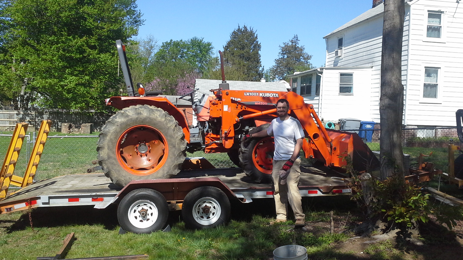

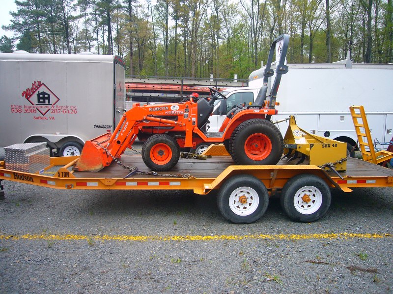

Unfortunately many of us buy "quality" only to find out years later it doesn't spec to new equipment. I bought my B7610 with a Hudson trailer in 2009,
fully expecting I would need a trailer big enough for a 40 HP tractor later on.
Only to find out it's a little small for the 50HP M4700 I bought in 2013.
