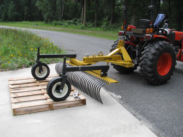

There are Box Blades, there are Rear/Angle blades, there are Landscape Rakes and there are Land Planes. Pulled by tractors, all are used in dirt/gravel road maintenance.
The cheapest of these implements are Landscape Rakes.
An increment more expensive are Land Planes. Land Planes take the least expertise to operate effectively.
The most expensive are Rear/Angle Blades and Box Blades, which need to be HEAVY per UNIT OF WIDTH in order to cut. Work most effectively with optional hydraulics installed on the tractor. Box Blades and Rear/Angle blades take many hours of experience to operate well.

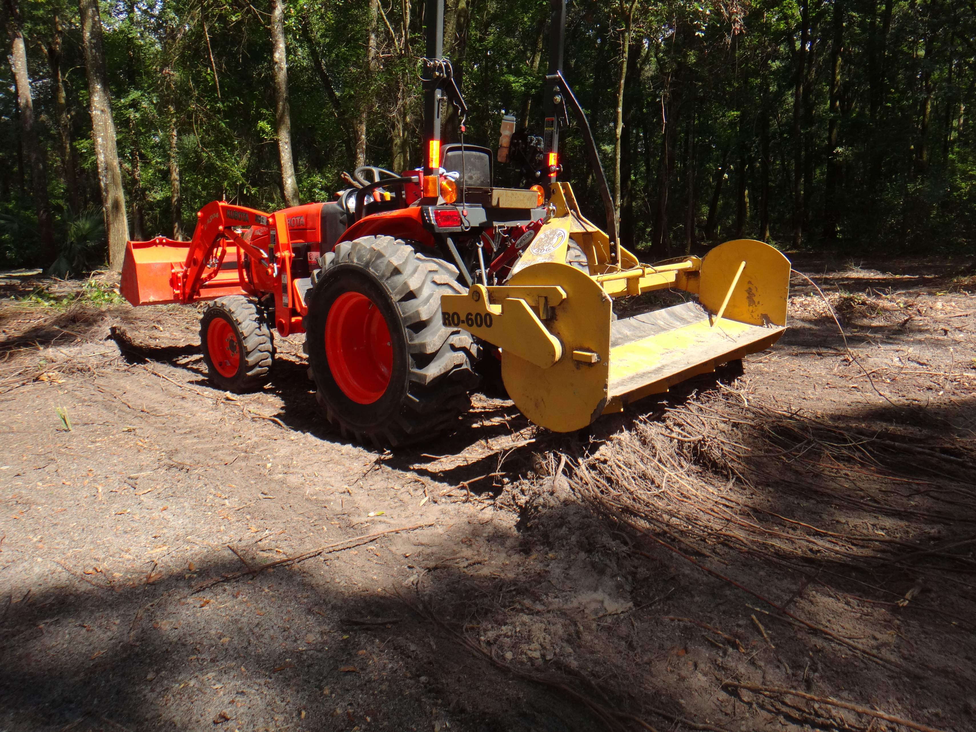

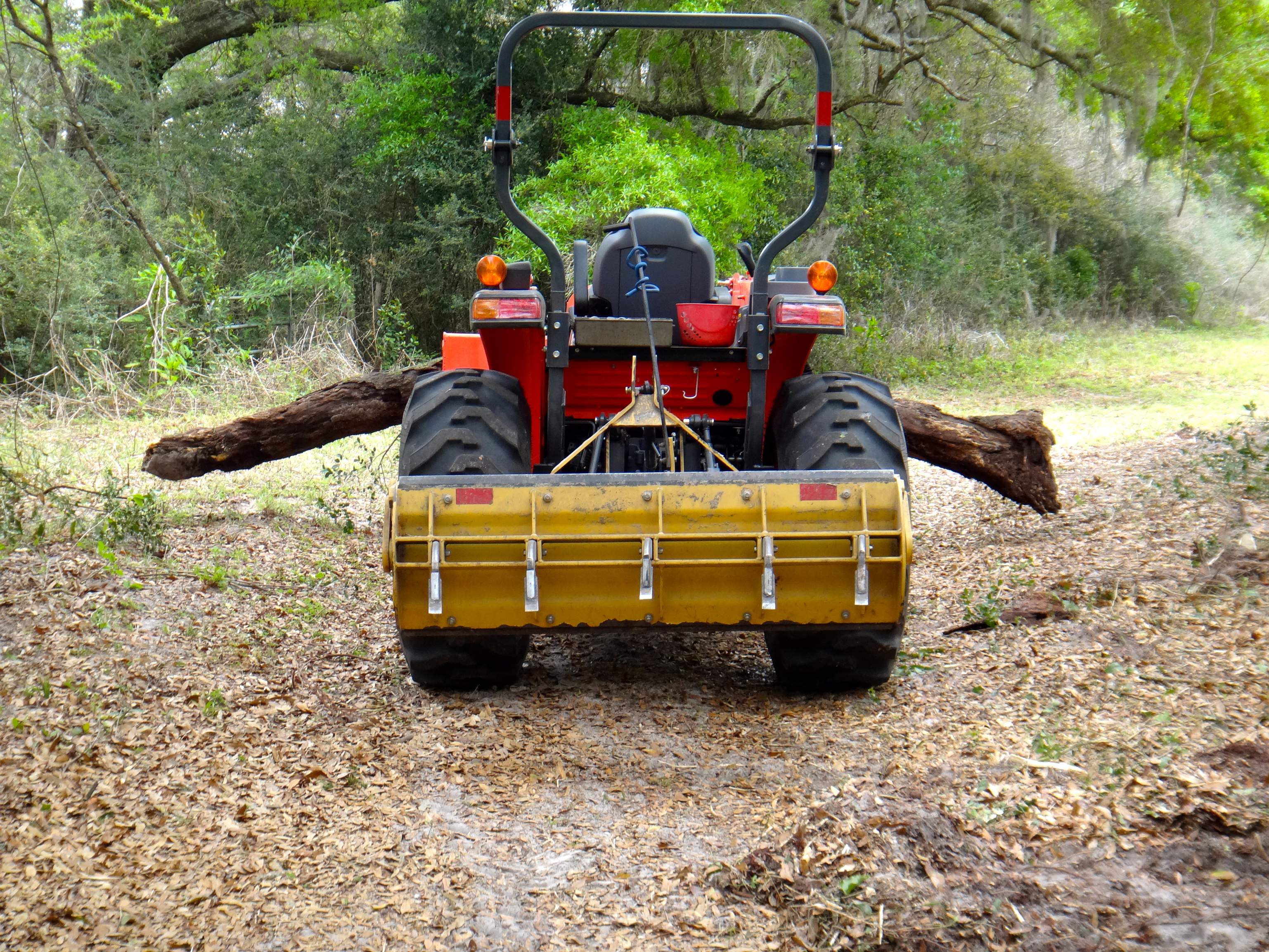

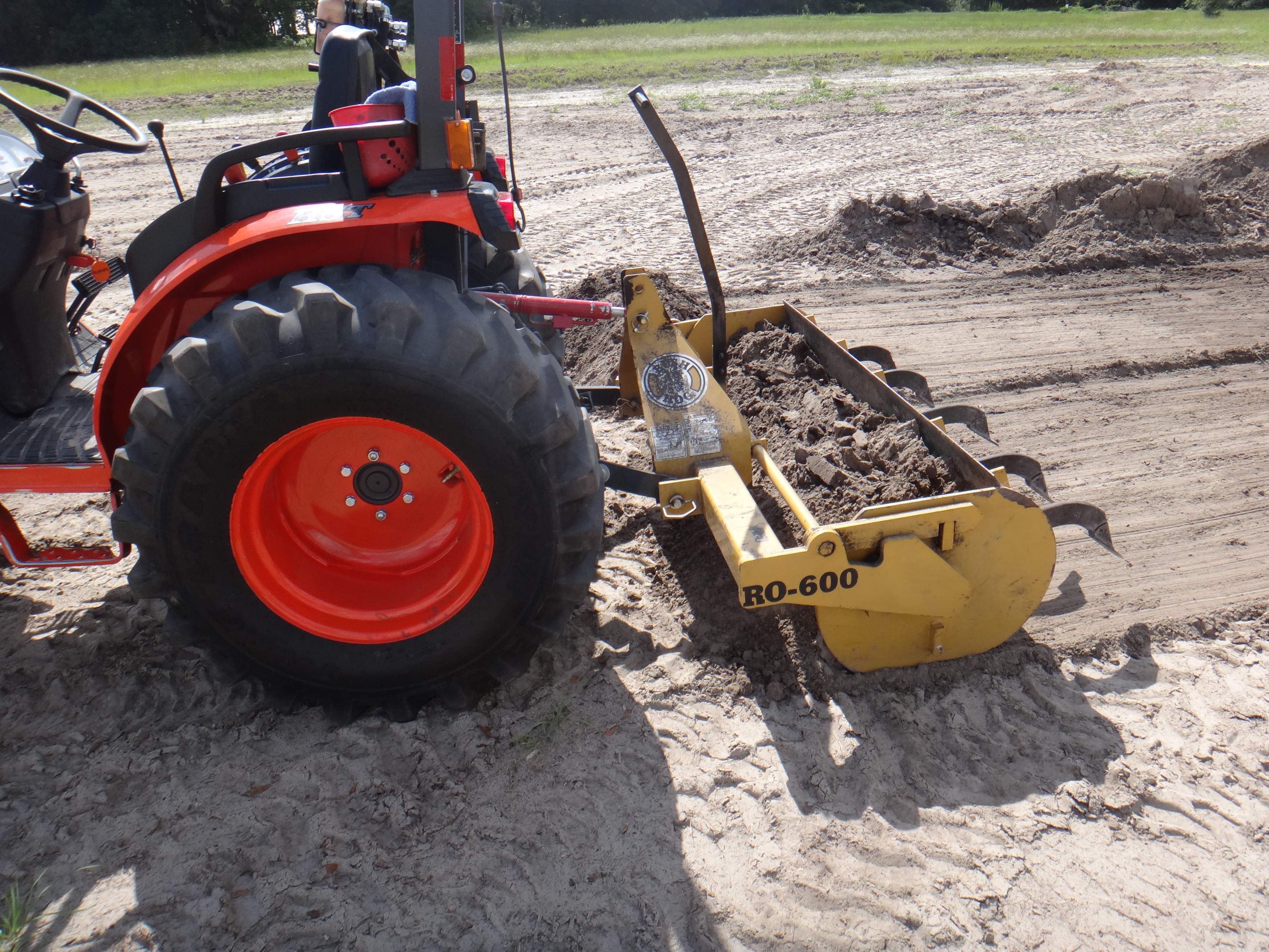

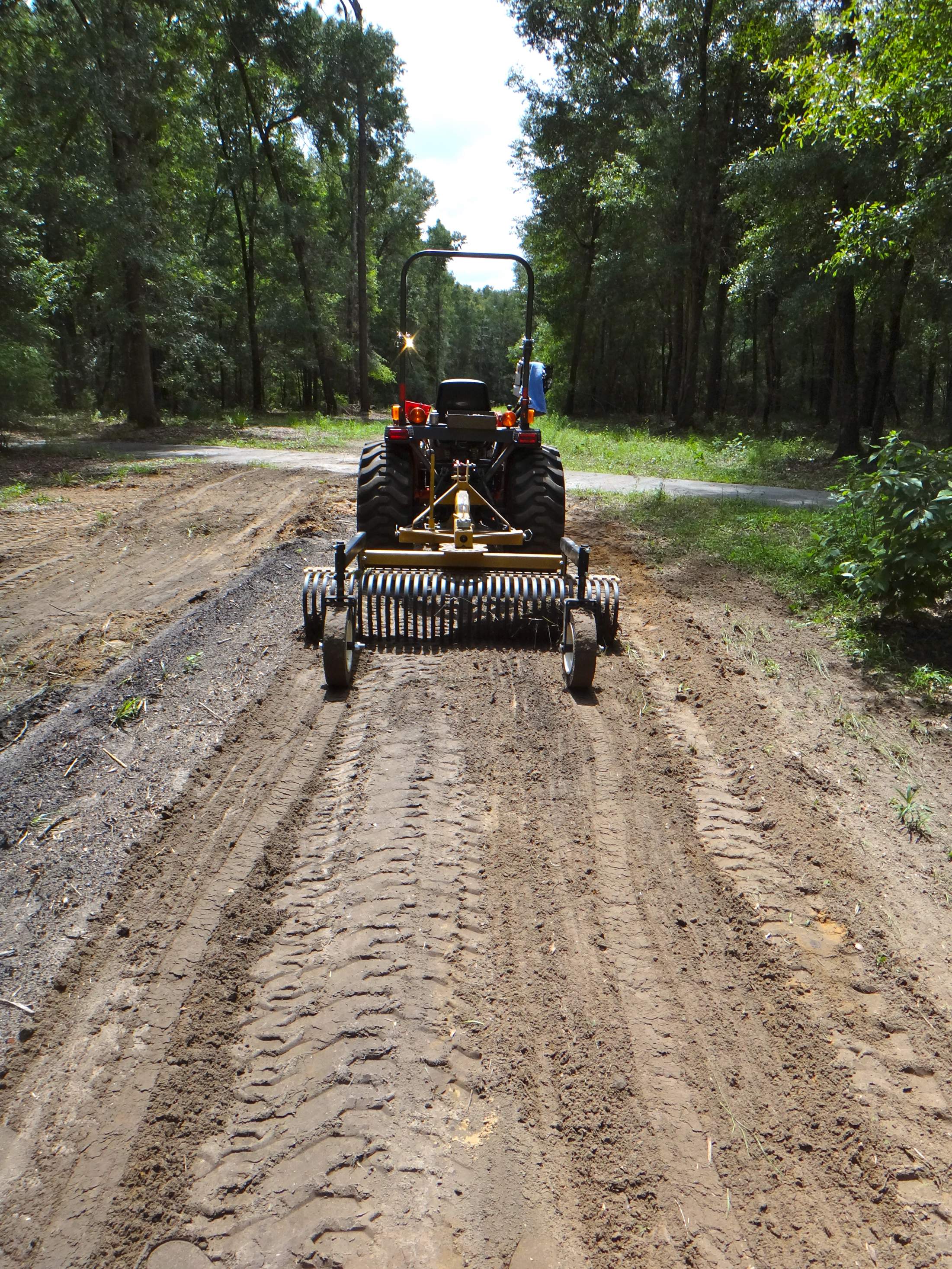

Box Blades and Rotary Cutters are the two most common implements used as Three Point Hitch mounted BALLAST for Loader work. This because they are heavy and because they protrude considerably behind the hitch, leveraging their nominal weight as ballast.
Photos #1 - #2 ETA Landscape Rake with optional gauge wheels. Fine rake, so-so gauge wheels.
Photos #3 - #5 Bush Hog (brand) 60" Rollover Box Blade, weight 625 pounds.
