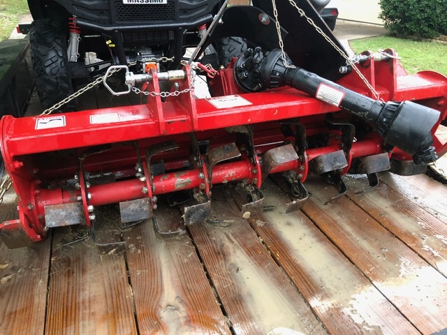

Since you're asking for help to clear the tiller and not criticism.... have you tried a power washer?
That値l be the easiest.
No operator error involved. Just very difficult material to work up.
   / Help! Clay packed into tiller tines #12
I clogged mine doing a neighbors garden spot I told him was too wet to till, and then hit a REALLY soft spot in it. A long handle crowbar using the pointed end dug mine out without too much problem. I had mine on the tractor, lift up and every so often fired it up to help sling the stuff off.

If the mud is still dry, hook the tiller up to the tractor, put the pto in neutral, lower the 3-point hitch all the way down and go for a ride. Go fast enough to get the tiller to bounce enough to loosen the dried and caked on mess. If it is dry enough, most the clay will bust apart and fall off. If it is still a little moist, this won't work nearly as well.
Oh, and drive a straight line and raise the tiller when turning. If you make any turns with the tiller on the ground, the tines will dig in and tear up the grass.
Try it, it works for me.

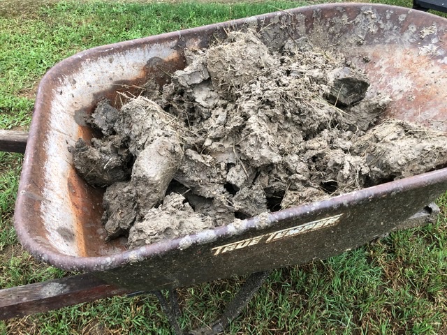

Thanks everybody. Got it clear today. (I had already tried the “dry tilling” and no luck). It took 3 hours to do the 2-1/2 center cavities that were still packed. I used a 0 tip on my pressure washer along with a wrecking bar hammered into the notches. From that I have about 150# of rock hard clay in my wheelbarrow from those compartments alone.

I bet that was a messy job. Was there much spray-back? I'm guessing that you looked like the wheelbarrow by the end of the wash.
