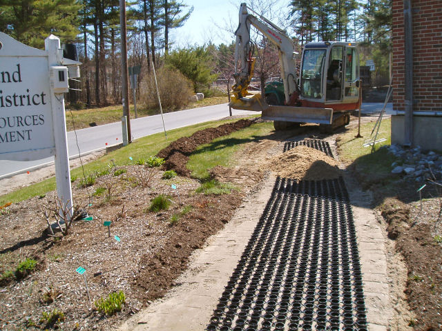

VACHESTERFIELD, lol, I had to chuckle when I saw your link. I do a lot of erosion control projects for The Portland Water District. Here's a link to my web page with some pics of some work I did at their at their Ecology Center.
Shoreland Preservation / Repair
And a pic.

Thanks everybody! Nice work there atgreene. You're obviously a professional, which I am not.
   / Help from Road Builders #19
Nope, just willing to listen, learn and try new stuff.
