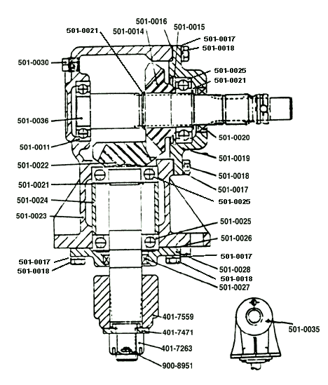

OMNI Rotary Cutter Gearbox
Part No. 401-0171 $245.00 Wt. 50.52 lbs.
Desc. GEARBOX, 35HP SC OMNI 250002
Details: 35 hp, 1:1.47 ratio, 1 3/8 6 spline input, 12 spline output, 4 bolt mounting, 6 3/4 diameter bolt hole mounting circle, hub 401-7559 shown for reference only order separately

Assembly Parts
501-0023 HOUSING, GR BX MAIN 1 $ 194.43
501-0024 SPACER, O/P 30HP 090000 1 $ 19.40
501-0021 SNAP RING, 30HP 200000 1 $ 1.93
501-0022 O/P SHAFT 15th 12SPL 030002 1 $ 129.00
501-0011 BALL BEARING REAR I/P 207K 1 $ 9.84
501-0036 SHAFT INPUT S/C 35HP 040003 1 $ 129.04
501-0030 PLUG, UPPER, NPT 1 $ 2.42
501-0014 GEAR,I/P 22TH 030003 1 $ 97.02
501-0016 GASKET,I/P SHIM 070002 4 $ 2.42
501-0015 SNAP RING, INPUT GEAR 1 $ 1.28
501-0020 SEAL 1 $ 4.85
501-0019 INPUT CAP 020002 1 $ 49.22
501-0018 BOLT, 3/8x1 HH NC 1 $ .55
501-0017 LOCKWASHER, 3/8 1 $ .49
501-0025 BALL BEARING 3 $ 10.50
501-0026 GASKET,OUTPUT 070001 4 $ 2.42
501-0028 LOWER BEARGING RETAINER 020003 1 $ 51.49
501-0027 SEAL 1 $ 5.13
401-7559 GEARBOX HUB SM 12SPL 210000 1 $ 40.47
401-7471 FLATWASHER 1 1 $ 4.41
401-7263 CASTLE NUT 1 $ 6.22
900-8951 COTTER PIN 3/16x21/4 1 $ .28
501-0035 PLUG, LOWER, 1/8 NPT 1 $ 1.87

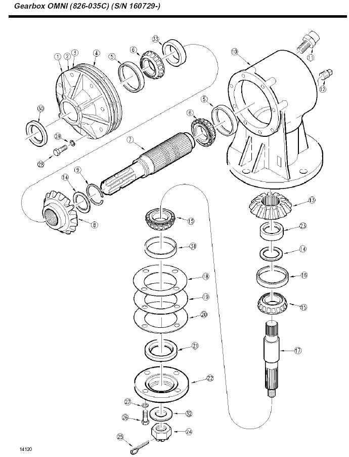

OMNI Parts Breakdown
Ref. Part No. Part Description Comments
10 826-035C GEARBOX RC71SS 1:1.46 INCREASE
10
1. 020162 OMNI INPUT CAP
2. 070142 OMNI GASKET 0.10MM
3. 070141 OMNI GASKET 0.15MM
4. 070140 OMNI GASKET 0.30MM
5. 050013 OMNI BEARING CUP - LM 603014
6. 050012 OMNI BEARING CONE -LM603049
7. 040135 OMNI INPUT SHAFT
8. 030040 INPUT GEAR - 17 T., OMNI
9. 200003 OMNI RETAINING RING
10. 010112 OMNI HOUSING
11. 140033 OMNI PLUG VENT 1/2"
12. 140017 OMNI PLUG PIPE SQ HEAD 1/8"
13. 030041 OUTPUT PINION - 14 T., OMNI
14. 090073 OMNI SHIM .25
15. 050008 OMNI BEARING CONE - 368
16. Ä À Ë 050014 BEARING CUP - 362A, OMNI (S/N 107994+)
16 Ê 050015 BEARING CUP - 362, OMNI (S/N 107993-)
17. 040112 OUTPUT SHAFT, OMNI
18. 070145 OMNI GASKET 0.10MM
19. 070144 OMNI GASKET 0.15MM
20. 070143 OMNI GASKET 0.30MM
21. 060004 OMNI OUTPUT SEAL
22. 020005 OMNI OUTPUT CAP
23. 090055 SPACER, OMNI
24. 803-095C NUT HEX SLOTTED 1-14
25. 805-017C PIN COTTER 3/16 X 1 3/4 PLT
26. 802-091C HHCS 1/2-13X1 1/2 GR5
27. 804-015C WASHER LOCK SPRING 1/2 PLT
28. 802-079C HHCS 3/8-16X1 1/4 GR5
29. 804-013C WASHER LOCK SPRING 3/8 PLT
30. 060005 INPUT SEAL, OMNI
31. 050015 BEARING CUP - 362, OMNI
32. 804-070C FLAT WASHER 1 SPECIAL
33. 090055 SPACER, OMNI
IMPORTANT: When ordering gearbox parts, be sure to have the I.D. tag number off the gearbox and the serial
number off of the cutter. This is important in knowing which gearbox your cutter has.

   / HELP HELP WITH A BROKE BUSH HOG #17
JM3,
You never cease to amaze me. Where you come up with this technical info and drawings I'll never know. This gives me an idea of what I'm getting into at least. Now if I can figure out if it is an OMNI or whatever it is.
