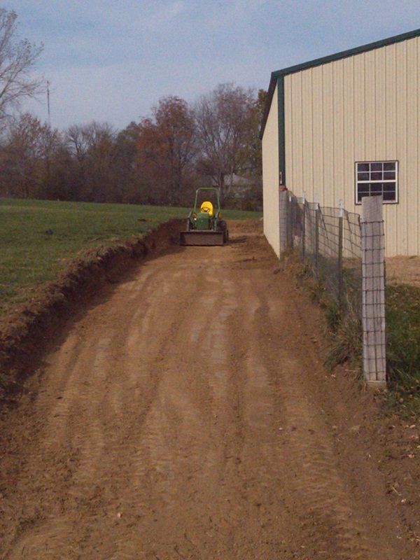

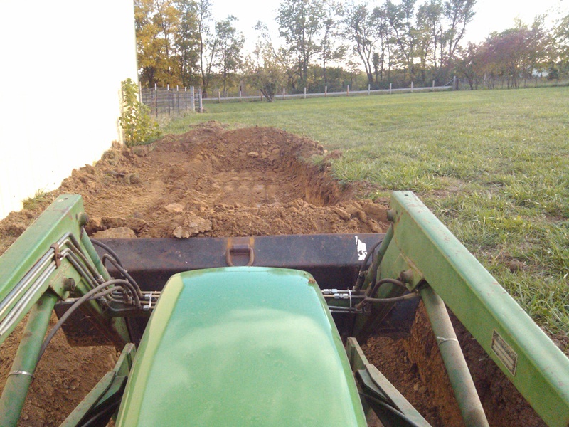

It's not too difficult if you have the skill to make dynamic bucket adjustments on the fly. I can tell you that you won't be able to much of anything without a toothbar on your bucket. The "trick" is start scooping up some dirt and dump it on the low side of your "launch pad". It doesn't have to be finish graded... just build up the low side. Drive over it a few times to pack it down. Keep doing this until you have the bucket sitting at the slope (or level) that you want the finished grade to be. Whatever angle the bucket is at when you start determines the angle of the finished grade. Now that you have established your grade... have at it.
Here's a couple pictures of my first ever dirt moving project with a FEL. In the first picture you can see the rolling, sloped terrain that I started out with. The second picture shows the area dug out and leveled. The project is not finished in the second picture but it shows the once uneven terrain nice and level.
