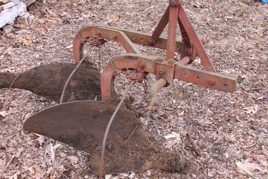

Need help to identify this plow: (their is no tag or numbers I can find)
Also need advise on proper set up. Currently have JD4700 rear tires in their widest position. Plow needs clean-up repair to one of the leading points. (there is a 1.5" hole) Can I weld material into this area?
   / Help Identifying Plow
#2
Here is the picture

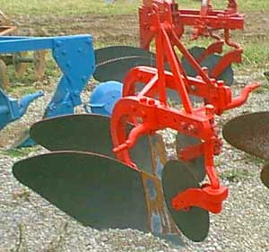

   / Help Identifying Plow #3
It is a Ferguson plow. I show one in the pic below that has the 3 piece setup. Some were only 2 piece (no wear shin in front of the moldboard) Ken Sweet
Thanks Ken. What are the rods, which are out to the side of the moldboards used for? (turf cleaners/cutters?) I also was interested in what the chains which are attached where these rods are connected are used for. Appears this may be an adjustment point.
   / Help Identifying Plow #5
The rods are for thick weeds to help roll them over with the sod. The chains look like they would be for missing jointers
edit: picture is worth a few words
