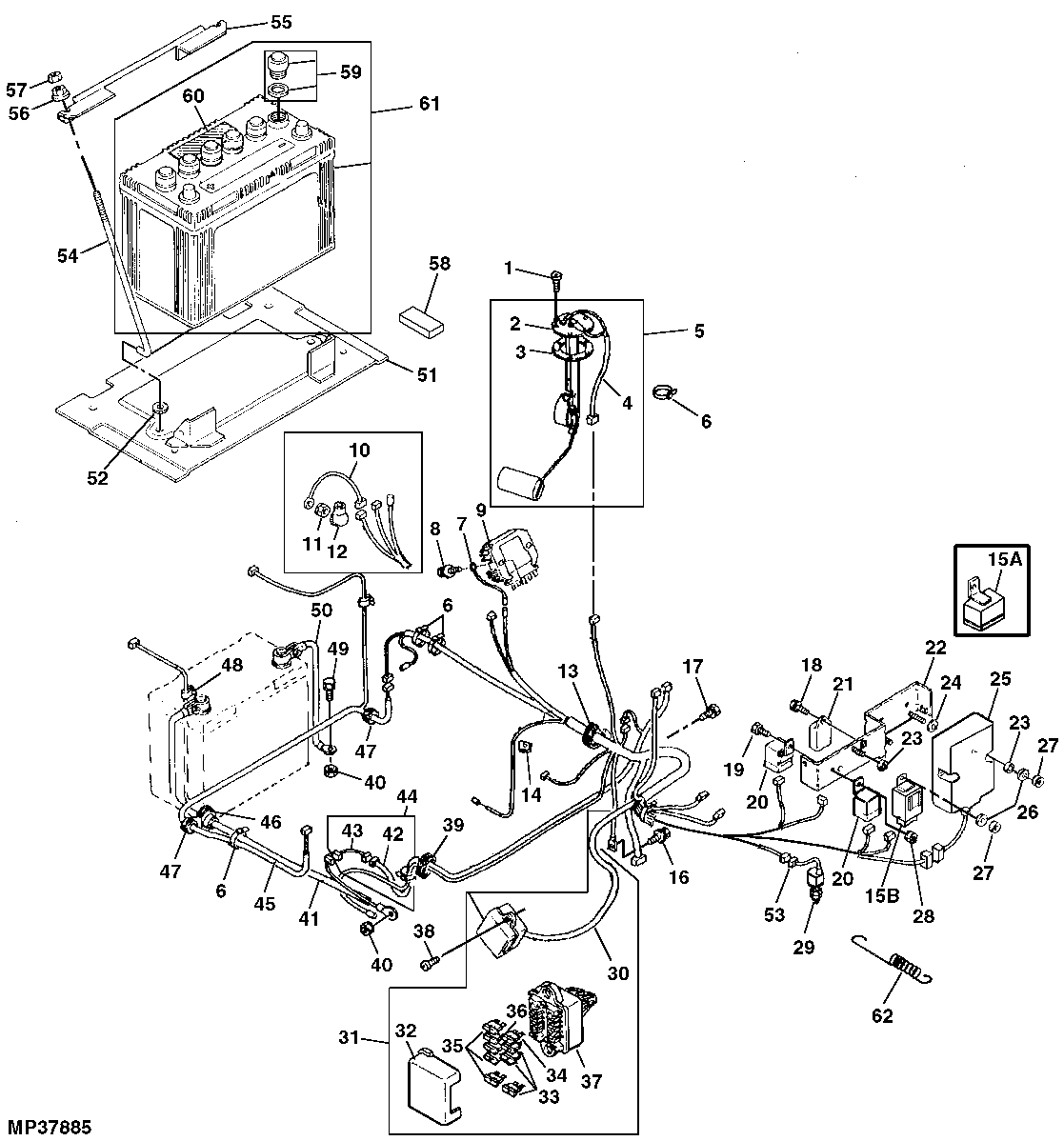

Like you I too thought the pull winding was bad, no such luck so yes, I'll have to get the Wiring Diagram in-hand and start following voltage upstream :reading:...... Interesting "Bad Ground" concept, as someone not skilled in this space I'll work thru this and for years to come other people not so skilled like me, they will be able to take small steps to achieve a bigger goal, get the tractor moving again.......:)

A nice little box of electrical connectors to make a jumper between the tractor harness connector and the solinoid connector, would allow easy access to each wire without damage to the connectors. I'll try to post a picture of what I'm talking about sometime tomorrow.
truckdiagnostics, dieselcrawler Good Morning, finally some rain here, albeit slight..........:raincloud:
truckdiagnostics, I see my use of the term "coil" was improper when referring to the Pull-In and Hold-In mechanical properties or "Windings" as you appropriately called them. One test I did not perform which I'll head out to do, From Battery to Solenoid Connector's White & Black Wires (only) for Pull-In Function. It's beyond me that the 12 volts coming thru the Harness (as measured) to the Pull-In didn't retract the Plunger but direct power simultaneously to both the Pull-In and Hold-In did.
Not understanding the properties of the Windings, :scratchchin: can there be bleed over so-to-speak from one circuit to another, Pull-In vs. Hold-In and that extra voltage in combination provided the needed voltage for a worn (if they even wear down) Pull-In winding.....As you can tell I'm talking out of school on this.....
So, if I apply direct voltage just to the Pull-In circuit and it works then not not enough juice (technical term) voltage coming from the "J" Junction of the A1 Time Delay Control Module or maybe connections faulty..... Looking at the K2 Fuel Relay, I wouldn't think that would affect the 12v going to the # 651 Wht/Blu to the Solenoid's Wht Wire.....
dieselcrawler - It will be interesting to see your lash-up jumper cables, I will certainly look at the voltage readings under load, especially the mystery "Pull-In" measurements.

dieselcrawler is going to show me his jumper set-up to do for further testing. I'm using some wiring I had laying around but hard getting it to stay rigid within the connector, something like alegator clips if easily inserted into the connectors would be much easier. Per your previous post:

Jumpers shown, x3, easy to make up, and allows testing and/or Jumpers while things are hooked up properly. Any auto parts store or hardware store would have the crimp on ends shown, take your solinoid with you to get the right size blade male/female ends.
Install jumpers between factory connectors, make double sure you keep them going to the matching positions.
