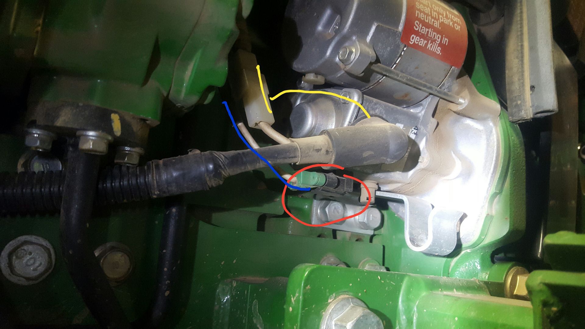

Finally... hope this works... refer to post #12 for reference.
Dieselcrawler, A bit slow on the uptake but I got it, yes I see the same lead..... Did some reading :reading: "Selenoid Operation for Dummies" and I see the trigger, as Zebrafive referred to it is the #105 Wht Wire. See if I have the logic - By pulling that connection it deprives the selenoids ability to connect the 12V to the motors windings and hence "No Crank" Just what I've been looking for. Additionally, I will be able to continue with Zebrafive's Voltage Checks and be assured no issues upstream and lastly, after reconnecting the Selenoid's connector to the harness, finally closing out with your physical inspection of the plunger retract...... could you just give me a thuimbs-up with my blue text and is there anything I should observe other than a simple retract of the plunger...... AGAIN, THANK's FOR THE HAND HOLDING...........
/ Help Interpreting Wiring Diagram & Using Multimeter #27
Yer set... blue text is spot on, starter can't engage, check for plunger to pull in... it's that simple.

Sorry for the delay getting back to this thread. The starter relay is key 20 in the drawing. Just unplug it for your test. OR you can disconnect the "trigger" wire from the starter Solenoid, if that is easier. Same result, starter will not work when key is to "Start"
There is a difference between a relay and a solenoid, but no need to get into that here.
Good luck!

Don't forget to try to push the plunger in manually if it doesn't pull in on its own. It may hold in, but not until after the key has been in the start position.
Starter disabled, stop solinoid out, plunger accessible. Key to start position should draw in plunger, and hold in with key in run position. After key has been in start position, plunger should stay retracted if manually pushed in before key off.

Good Morning Dieselcrawler and Zebrafive,
Per dieselcrawler's skillful guidance I disconnected the # 105 Wht Wire from the Y1 Starting Motor Solenoid. :thumbsup:
Per Zebrafive's previous post (highlighted below) In the "RUN" Ignition Position vs. "ON", I performed Zebrafive's Voltage Check , at # X5 Connector for "Hold in" = Within Range, A-OK :thumbsup:
Went on to Zebrafive's Voltage Check at X5 Connector for "Pull In" and as I turned the key to the "RUN" Position, not yet advanced to the "START" Position, I noticed the voltage spike to 12 Volts for One Second. :thumbsup:
OBSERVATION FOR ZEBRAFIVE - Not sure if that Ignition Position is significant but since I successfully had both the "Pull In" & "Hold In" voltage to the # X5 Connector I plugged the Y2 Fuel Shutoff Solenoid back in, advanced the ignition to "RUN" and the answer is = NOT-TA, Nothing, no plunger retract. :thumbdown:
dieselcrawler and Zebrafive, Would you agree the Y2 Fuel Shutoff Solenoid is Bad, or, is there perhaps another anomaly at play......... :scratchchin: Any thoughts would be appreciated......THANK YOU..........
