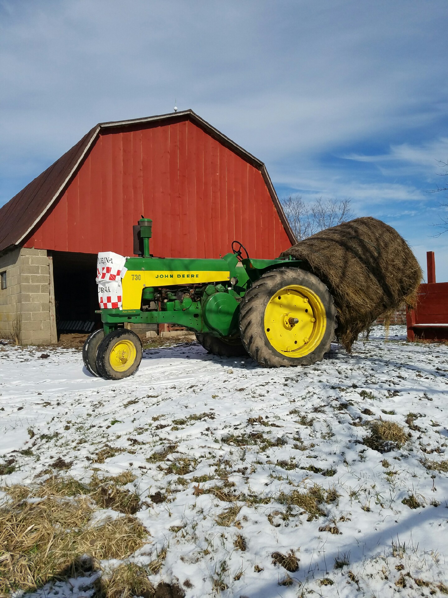

/ Help! Looking for tractor.
She still earns her oats some days. Haha.
/ Help! Looking for tractor. #7
And a little dog chow too? Or does Purina sell oats? :D. Beautiful tractor !!! Very nice.
