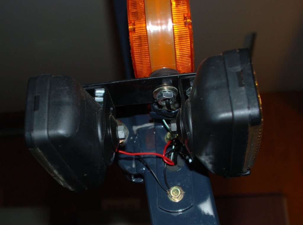

I probably invested about $60 (including lights, wire, waterproof switch, and mounting plate) and added 4-55w work lights to my ROPS.
Jay

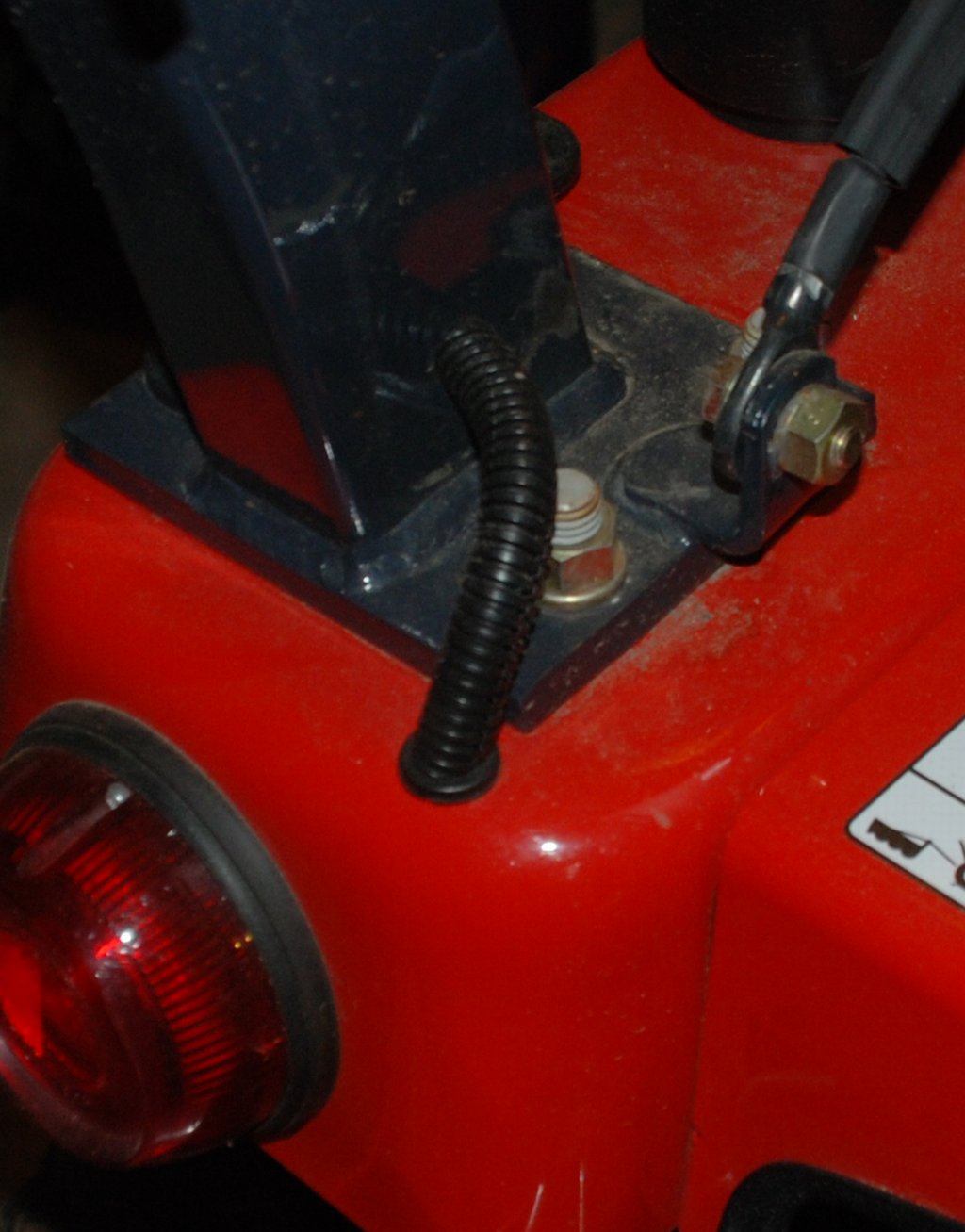

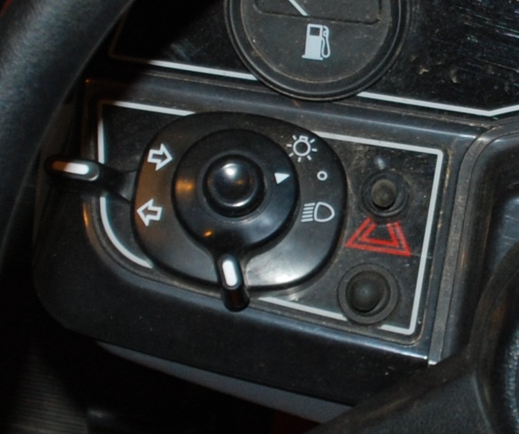

Jay, could you give me a little more info on the switch you used? Did you need to use a relay? Did you run the wires inside the ROPS or clip them to the outside? Where did you pick up hot and ground?
As I think about this, I wonder if it would be possible to add a relay to the headlight circuit and then just have the auxiliary lights come on with the headlights? Something to think about...
   / Help me buy my Massey GC2410 #29
If it's the same as the 2310, there is a spot just above the 4-way flasher switch that has a cut-out in the metal and is only covered by the decal. I bought a waterproof switch at Tractor Supply that fit right in that spot.
There is also a power wire that has been run from the fuse block to the rear of the tractor. Take the BH off and look under the left fender from the back.
So all I had to do was run a wire from the fuse block to the new switch, then from there I picked up the wire that was pre-wired to the rear. I ran power wires through the inside of the ROPS and tied in to that pre-wired connection.
As for the ground, the lights are mounted to a metal bracket that is bolted to the 4 way flasher bracket - so it picks up the ground through the ROPS/frame.
Attached are a few pics to give you a better idea of the end result.
Jay
