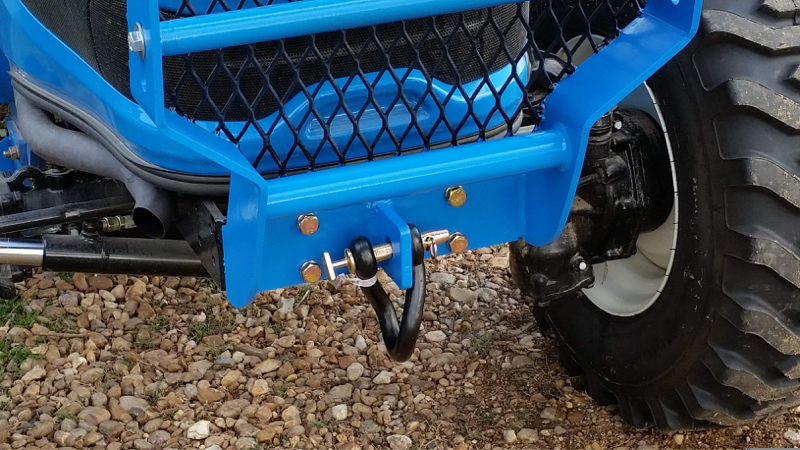

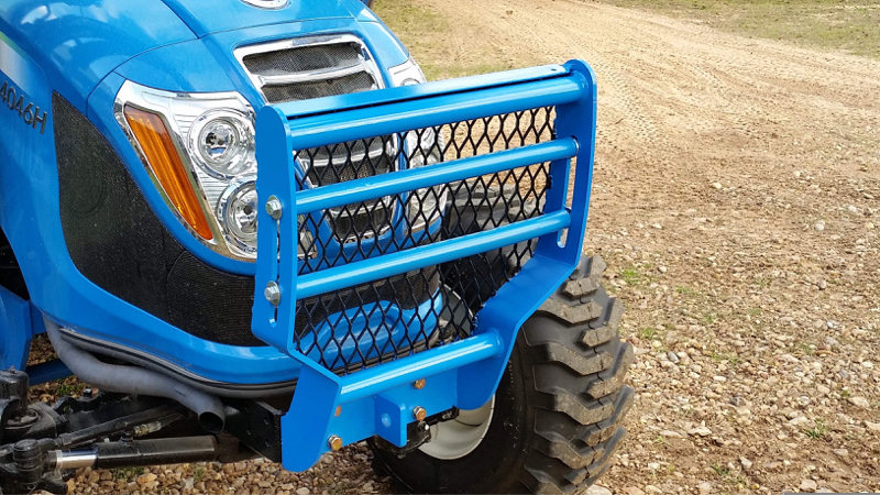

On each side, right at the level of the "tongue" - a pin on each side, so I can fold the guard forward. I took the basic guard to a welding shop and they did the expanded metal and the tongue. It wasn't cheap but then again neither is repair to a radiator/ new battery/etc. Its saved the radiator 2X that I know of and I'm careful to the extreme.
Thank you. My LS has a nice heavy guard, but it is completely open in the front. May have to steal the expanded metal idea.

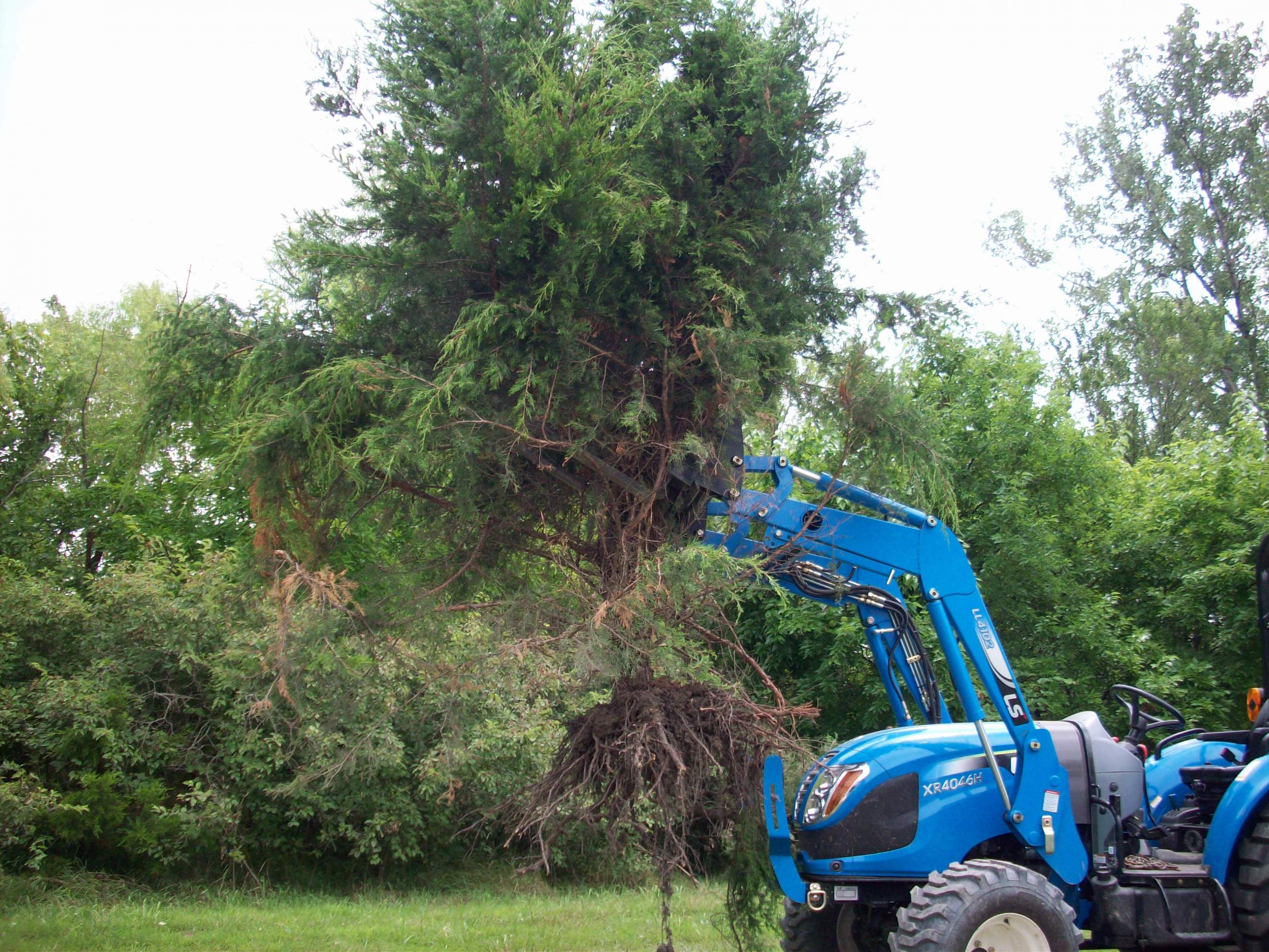

I have a LS xr4046 and bought the 60" grapple and forks from palletforks.com. I can remove cedar trees under 5" trunk with just the grapple. Push the tree back and forth to loosen up the roots and then pull out with the grapple. On the larger trees, I use the forks and dig under the tree to loosen and break roots then I am able to pull the tree and stumps out. Do not cut the tree down before trying to remove the sumps, use the tree for leverage to loosen the stump. I was amazed at how large of a stump I could remove. I like having the oversized grapple and the 2 lids work good for removing and moving brush. The welding on the titan is not real pretty, but I have not broke any yet.

Cedar trees are bulky but not very heavy (relative to hardwoods), especially after they've been dead a while. I've removed a few hundred so far with my stump grapple, which is only a single lid and is very narrow. For just moving downed cedars, any grapple will do the job, which is a pretty easy job. So don't overthink it.
Are you sure you want to cut them off and leave the stumps? The stumps are a nuisance, IMO. I'm removing mine by either pushing them over and ripping them out of the ground with the grapple, or by wrapping a chain around the trunk and pulling them out of ground. For the larger ones I can't push over with my DK50SE, I dig up the lateral roots with the BX23 backhoe and then push them over or jerk them out with a chain.

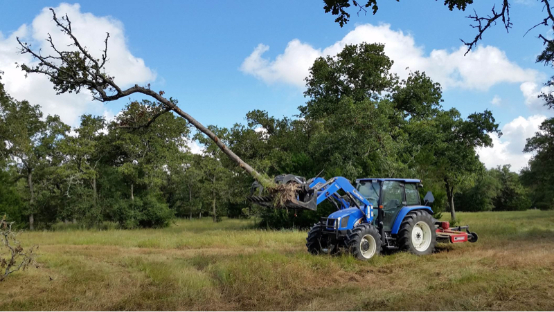

I have an 84" dual lid Blue Diamond grapple and WR Long 3rd Function installed on my New Holland TL100A (96 HP) tractor. After offsetting weight of the grapple (900lb.+), I can still lift over 4000 lbs. net. I regularly push over dead trees with goal of breaking out roots and all so I have a hole to fill and no stump to have to deal with.
My one and only complaint, on this grapple, is the jaw opening is only 34" which somewhat limits it in picking up piles of brush or limbs from tree trimming. I am looking seriously at Everything Attachments new Wicked Grapples for Utility Tractors. They already have a 72" model with jaw opening of 42-43" and should soon have same in a 55" model which is where my interest is to install on my LS XR4046HC. I already have the WR Long 3rd function installed on this tractor as well.
Using one of your rear remotes, to operate your grapple is certainly doable but, once you use one with a true 3rd function you will never go back. You control lift and curl with your hand and grapple with your thumb on toggles switch.
