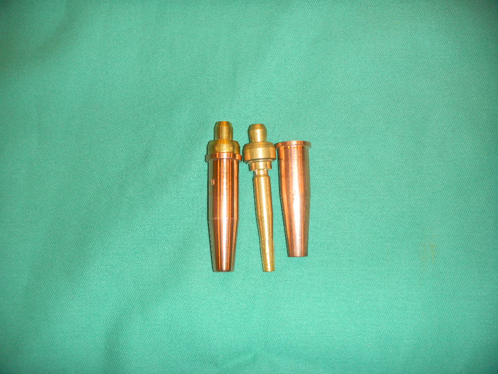

Technically you need to have grade T hose, and you'll need a propane tip. But I'll bet you have a propane tank around some where. Propane takes just a little longer on the preheat, but it cuts very nice.

How about heating tips? Dows the oxy-propane mix properly with a standard rosebud or is that special as well? (Sorry to highjack the thread by the way folks, my apologies)

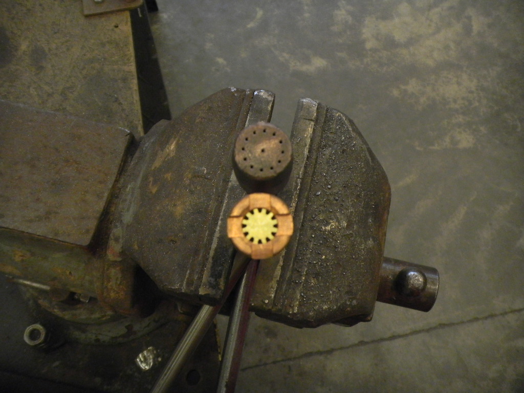

No for propane you need a propane rose bud. Personally I don't like propane for heat shrinking items, but for general heating it works fine. Now a days the majority of my heat shrinking is done with a cutting tip. Back in the day when I had to do beams I'd use a couple #12 rose buds, but those days are long gone.
First picture is a propane, and acetylene rose bud side by side, third picture is the propane rose bud, and third is an acetylene rose bud.
Looks like I'll be picking up some new hose and a couple tips...I've already got a 100# propane for my gas forge...a tee with a shutoff from that in the shop will work well I think. For outside/offsite I'll stick to the acetylene though, that propane's a b**** to move around. Thanks for the kick in the pants Shield Arc!!!
