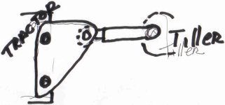

Can anyone help with proper install of that yanmar tiller toplink? I can't figure which way is right side up or not. One way, the horizontal line is at the bottom with the angled line at the top. It also fits the reverse of that. :confused:

There is a short top link needed that will keep the tiller away from the tractor. Check with the dealer that sold you the tiller and ask to see the original style top link for the tiller. it bolts to the back of a Yanmar and is solid for about 12 inches out from the back of the tractor. A short adjustable link connects to this solid piece for pivoting like a normal top link on the tiller. The result is to swing the tiller up and away from the rear tires.
The real trick in attaching it is to make sure the drive shaft will not kink at some point when lifting the tiller. This proved to be the real need for the solid top link.

Tony are the tines hitting the tires when the tiller is raised? The tiller on mine fits real close to the tractor but that keeps the weight close and you don't have to add weight to front of the tractor. I run the triangle part of the Yanmar toplink with the short side on the top and the long angle running towards the ground. The bar (top link) is about 6 to 10 inches long. I will try to upload a crude drawing of the setup. I would hook up and take pictures but am not able to get to tractor right now. Hope that this helps. big dan

Big Dan, man....thanks for the drawing. That does help alot! I have it the opposite way. I'm also determined to break loose the adjustment on the toplink, as that will let it pull in another 1/2" and may do the trick for me. There are some "paddles" connected to a spring inside the two plates for the toplink plate. What are those for?
The tire isn't hitting tines, just the outer case. Not good either way though.
