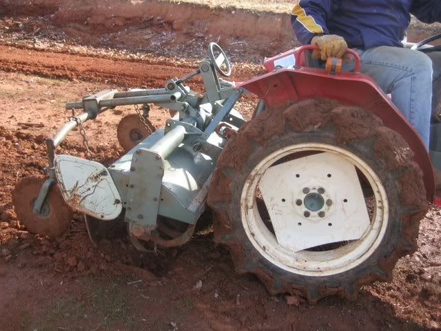

Tony, I'm not home today so working from memory which isn't the best any longer. Think the skectch provided has the orientation correct. There are several different top link mounts. Believe mine has a decal with the various models it is intended to be used with. There is also some info on length for the link itself. Seem to recall the link dim is on a decal on the tiller.
When properly adj'd the tiller pivots as it is raised and lowered. Even with proper link and adj, the tiller come very close to the rear wheels. I've got one of the harbor freight QM hitches and no longer use the Yanmar top link. I modified the mount on the tiller so it complies to cat 1 stds. Works great for me.

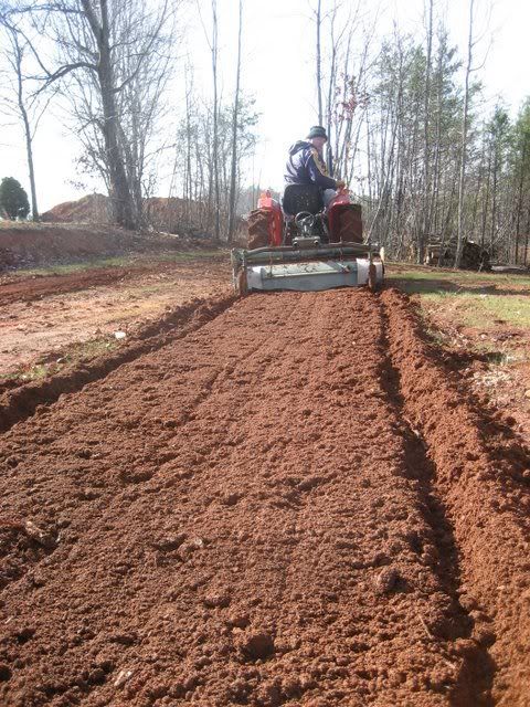

Used the tiller yesterday! I tried every conceavable way to adjust the toplink and bracket, and none mad it any better. Then, I tried using the short 10" toplink without the bracket peice. That was actually an improvement, and I think will work for my purposes. Now it only rubs the tire if in the fully raised position. It doesn't hit when operating. So, I just lift it a few inches off the ground when driving around.
Mickey, there are no stickers on my toplink, but it is likely that mine is not the one for this tractor.
As long as the dirt is smooth, the tiller is. Runs like a dream. It did get to clanking some when I would uproot football sized rock. Thats not the tillers fault though. :)
I think it was stated earlier in this thread, that a tiller is not about how much you use it, but more about how much less you have to use all the other tools. hahaha..... I got my garden fluffed down to 10" in all of 15 minutes. :D

Here are some photos.
