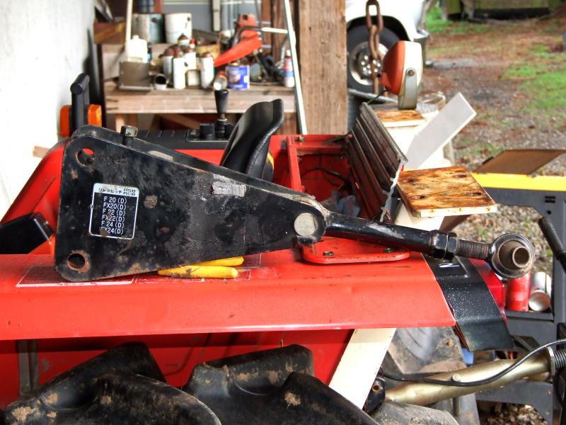

Tony, I forgot this thread. Here is a pic of the top link set-up for my tractor and tiller. I was correct in remembering the various models this link was intended for. There is an adj bolt that needs to be facing up when mounted. The adj is for helping with the alingment of the lower cross mount pins. If done properly, when the top pin is in place, all the holes line up for the lower pin.
You tractor, set-up may be completely different.

I haven't seen a mention of the upper link 'bridge' that is needed to reach out from the tractor to that special short Yanmar upper link. This 'bridge' has two holes and is pinned to the upper/lower upper link holes on the tractor, so the rearmost end of the 'bridge' maintains a constant height. With the short upper link pivoting around this extended swivel point, the tiller lifts high without being drawn forward into the tires. Be sure you get the 'bridge' and its mounting pins, along with the special short top link.

Shimp, I have always had the bridge, but the part I was missing was that "extra short" toplink. I now have that and the tiller is positioned just right! It also runs sooooo much smoother. I had to get off to make sure the tines were turning.
