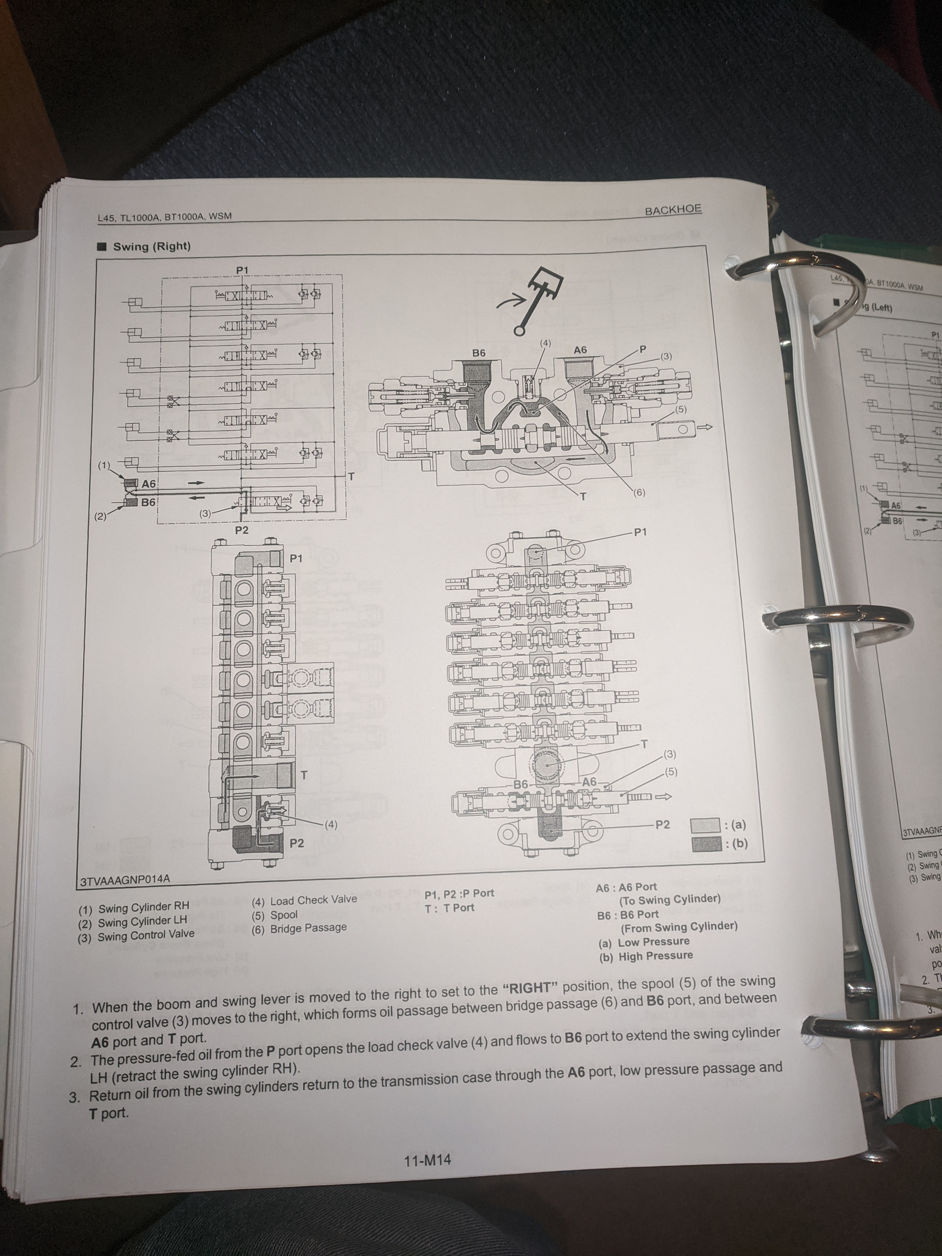

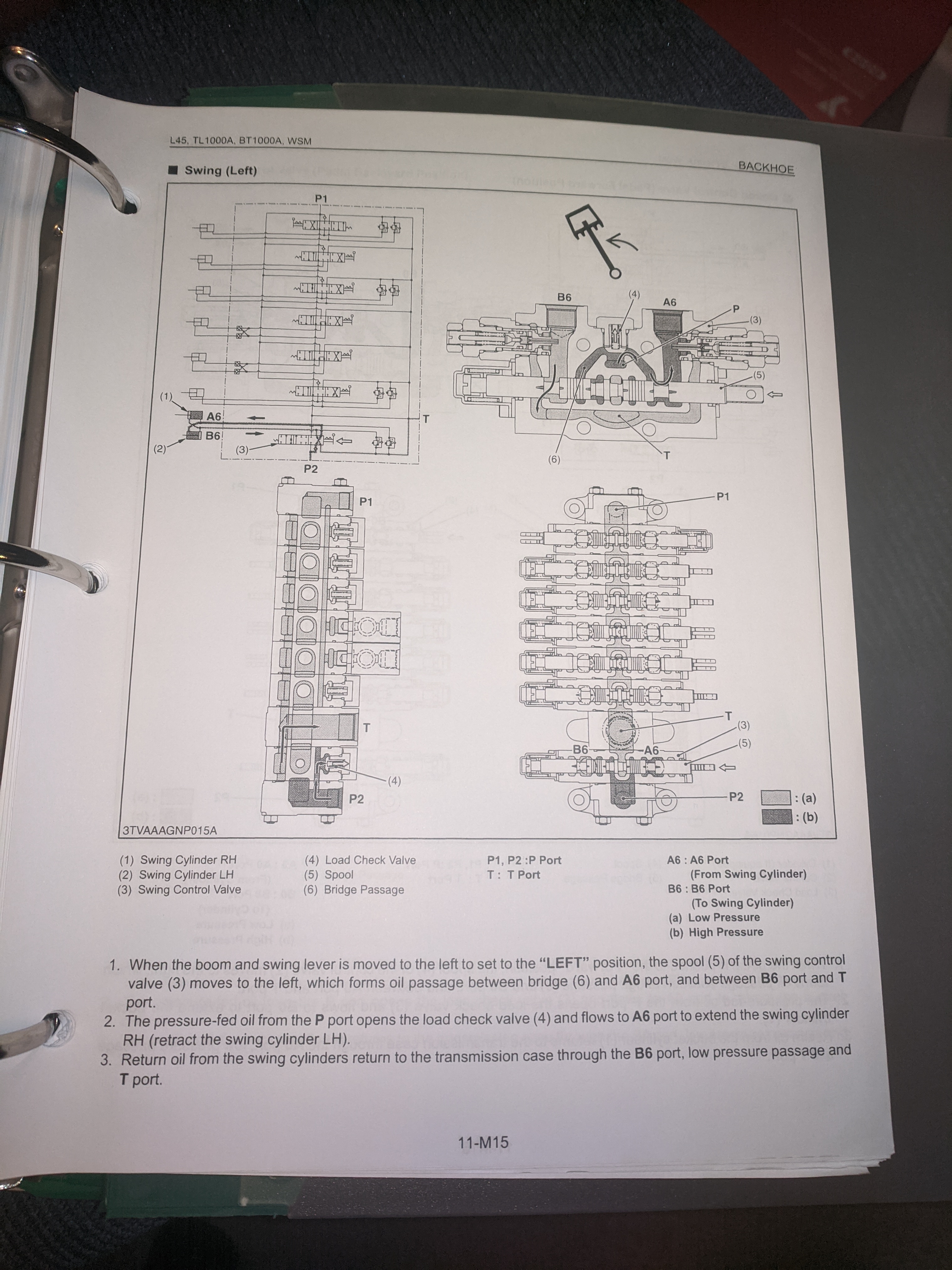

Here are the hydraulic diagrams from the Kubota service manual.

Yes, mine has decent power in swing. No problem moving the whole tractor around with the backhoe; including swing. In fact, I do more sidesweeping than I should just because the swing works so well. But I'm still suspicious. After all, I did have that episode where it wouldn't swing one way even if it was years ago. I am fairly gentle on the backhoe. I run at half rated rpm and don't slam it around.
There are good M59 hydraulic schematics in good resolution in my shop manual.....although the M59 might not be the same as the L45?
I am a novice at reading hydraulic schematics. Just learning.
