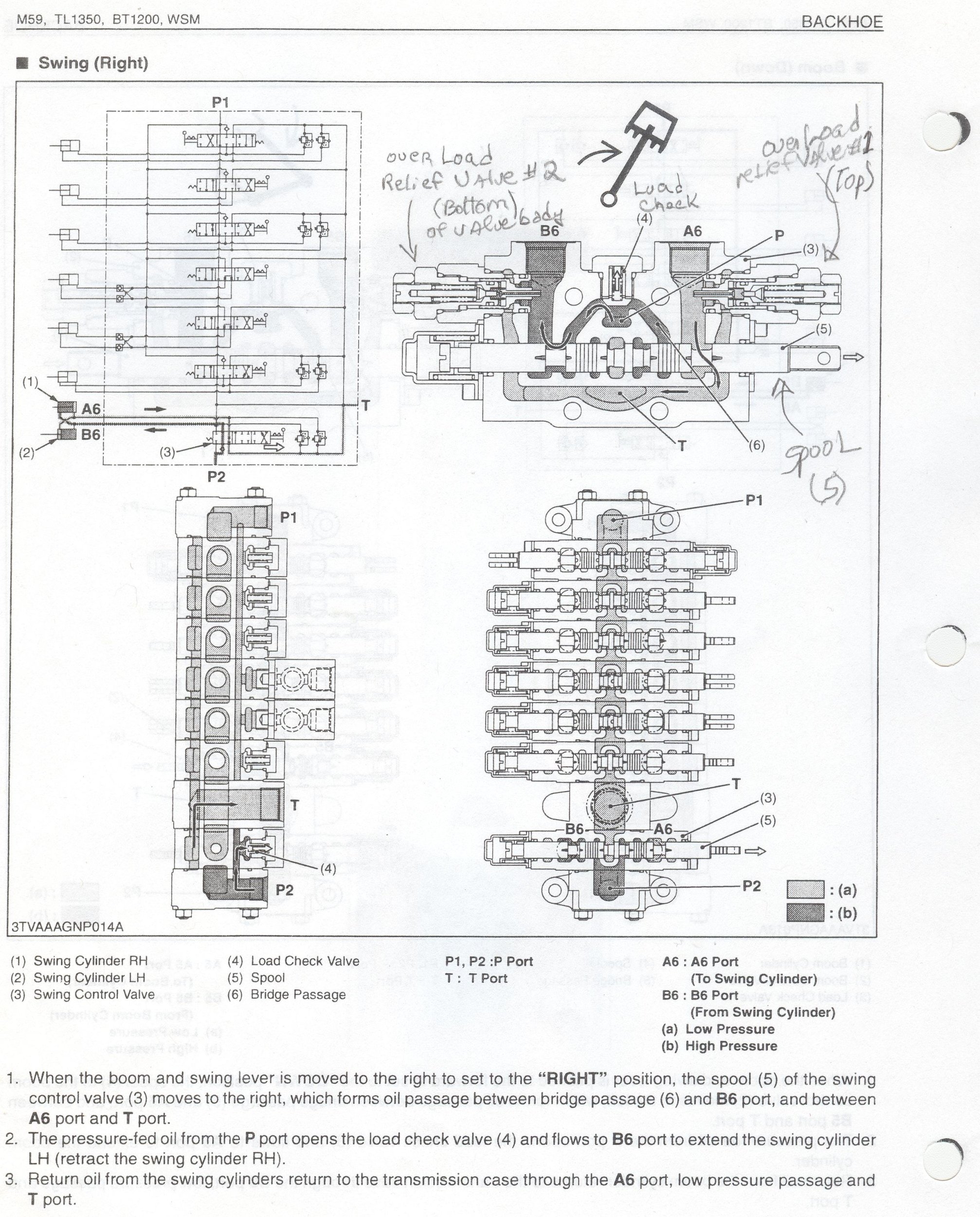

I got a chance to play with this. I just swapped the swing hoses from their control valve onto the boom control valve and vice versa. The problem moved to the boom! I had no power for boom down!
So now the problem is isolated to the control valve or the actual pump? Steering seems fine, and I have power in 1 direction, so I'm assuming the pump and main relief is ok. So I think that means the actual control valve is the issue???

4. Hmmm.....could it be a relief valve? We know people have had problems with relief valves in that circuit before. Is there any way? I need to look at the hydraulic schematic to determine that - more about hydraulic schematic reading below..

Just wanted to update everyone I fixed my swing problem. I ended up swapping top to bottom bottom to top on the valves not the hose. My swing problem changed with the swap. So I looked to see how much a valve was to replace. Way to much money for something that has springs and an o ring so I took mine apart guessing the valve the followed with the problem was now the bottom valve. I was told by kubota it was un serviceable, they are right to extent. There's an o ring and backer ring that sits inside a cup that holds a needle in place. Low and behold a small piece of oring that has been rolled off by the backer ring pinching the o ring. Took to local shop for o ring sizing they were surprised how loose fitting the oring was on the valve. They suspect when the unit is cold the o ring rolls on it self inside and cause a poor seal causing the no swing. Sometimes with the split style backer ring the o ring pinches and well my tore but it worked sometime and sometimes didn't. So I replaced the oring a very loose fit but put it back together and power left and right more then I ever had for pushing the machine side to side. Now I just to rebuild my boom cylinder never ends. But if anyone wants pictures or what I did further feel free to take stuff apart it's only money if you break what's already broken
   / HELP! My Backhoe won't swing left! #60
Congrats on taking it apart and doing it yourself. And maybe you have solved the mystery.
It seems like a piece of O ring holding an overload relief valve from closing would eplain all the things we have seen so far, including having unequal swing power in both directions.
I do wonder about tha oversize O ring you found. It seems odd. There are some fluids that will cause O rings to expand. It might be worth tapping off some of the trans/hydraulic fluid in your machine and putting it in a jar with some O rings just to check.
To see what can happen, coat some standard hardware store O rings with vaseline and put them into a zip lock. Compare with a new one in a few months. Amazing.
Here is a scan of an M59 control valve stack. It seems similar to your L45 valve. Can you point to which O ring that you replaced? Is the split backer ring shown?
Thanks, rScotty
