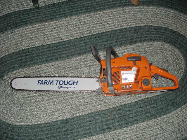

I just bought a Husqvarna rancher 55 20" bar. Started on about the 5th pull. Says to run about 6 tankfulls through it before you adjust the carb. Had a lot of saws but I bought this one because its light 11 lbs and has 3.3 HP.
