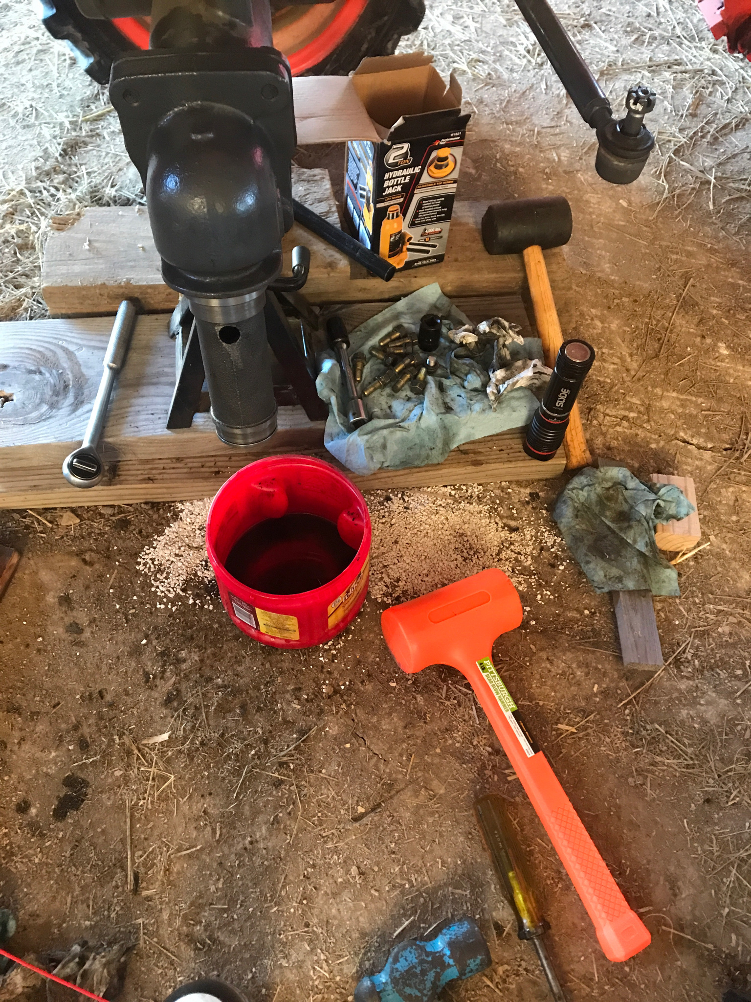

"Don't force it, get a bigger hammer"
That’s what it took, lots of blows with this.

Got the axle case all tore down, time to clean everything up. No metal chunks, everything turns smooth with no slop.
   / Help removing front gear case #24
That's always a good sign. So, for future reference, it took just removing the bottom snap ring and a hammer to remove?
Proper choice of hammer... a shot-filled dead blow hammer like the one he used gives proper force without marring the surface. (y)
True. That, a soft face mallet, or a block of wood in under the hammer all work well
That is correct, probably had to strike it 100 times with that 4# shot hammer, and it came off very gradually.
