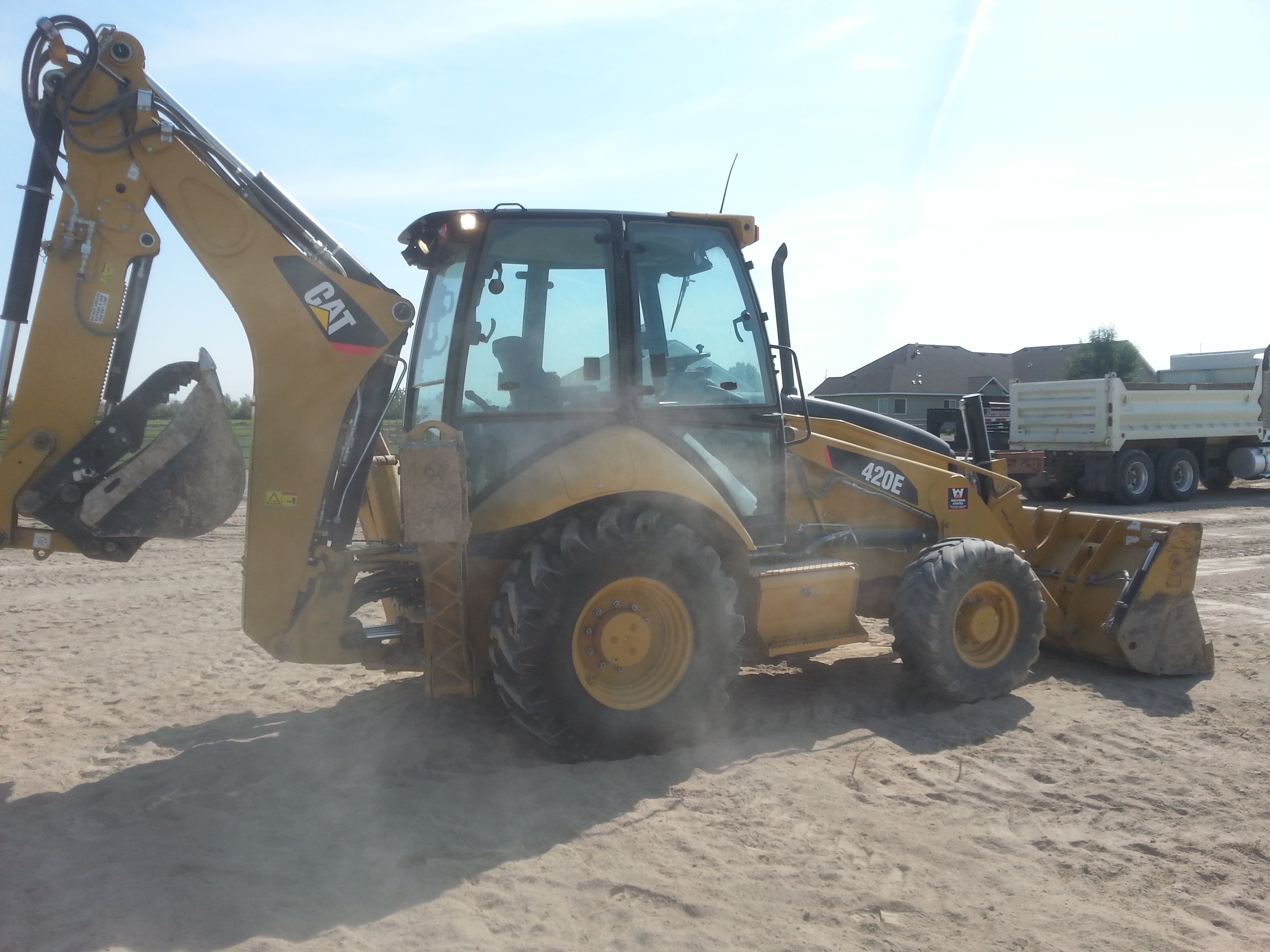

I'm going to be using it to level several acres of a fly-fishing ranch in Idaho. Trout Haven 6-2016.jpg I already have a backhoe (a CAT 420E) so I got the digging and loading work out of the way. 20140913_115659.jpg

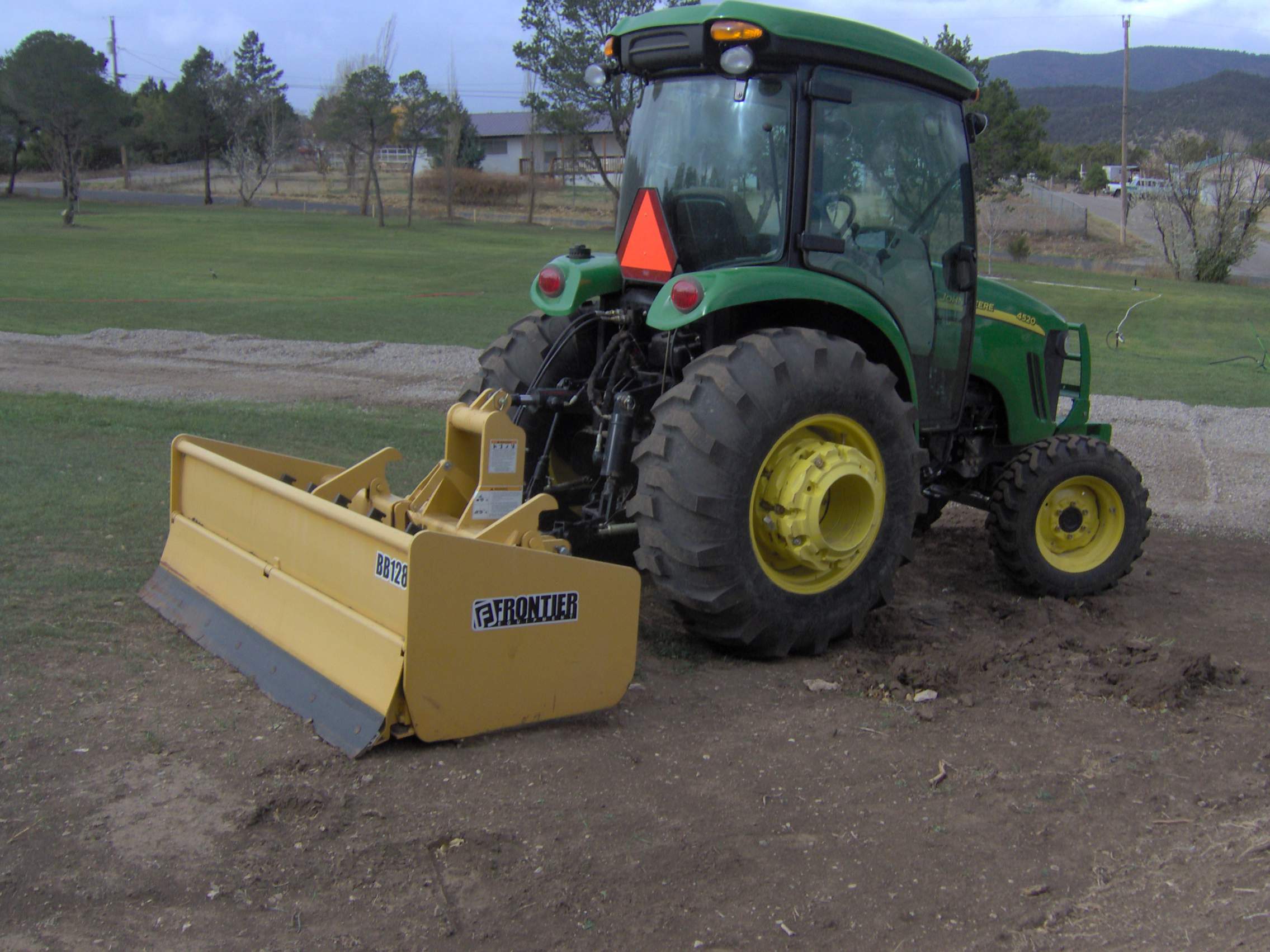

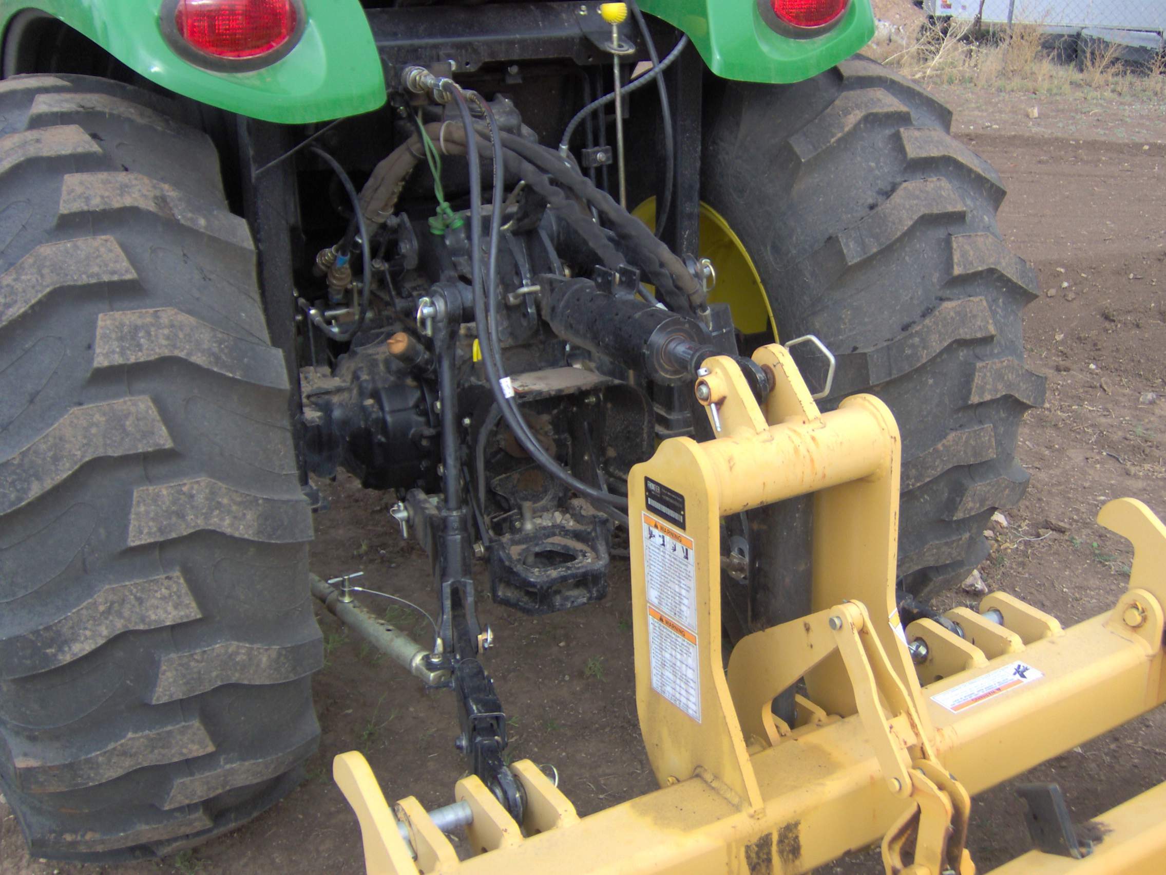

First I would ask you to post a picture of your box blade hitch from the front. Just to clarify the hitch you have, as most of these box blades have a clevis hitch that fits both cat 1 and cat 2 hitches. This is important because John Deere and a lot of other manufacturers do not offer the hydrostatic transmissions in a cat 2 hitch.
I use a Deere 4520 cab tractor with R4 tires triple wheel weights 60hp and the ehydro transmission with good results. Mine is a 2009 and in that year the hp was increased across the model series, so the 2008 and older will have less power. When checking out tractors this is good to be aware of.
I have a Frontier BB1284 box blade made by Gannon very similar to yours but with the hinged tailgate and is 7' wide. I have many hours of seat time using mine for grading fields and other work. I would venture to say a similar tractor would work well with your 6' box blade. I would suggest a tractor of at least 50hp and would prefer a little larger which allows higher ground speeds. When you are grading acres instead of a short driveway travel speed becomes an issue.
Other important considerations would be to get a top and tilt hydraulic hitch (needs two sets of hydraulics) plus one set of hydraulics for the rippers. Would also recommend the optional telescopic links if you need to change implements often. These clevis hitch implements are a bear to change without telescopic links or the quick hitches.

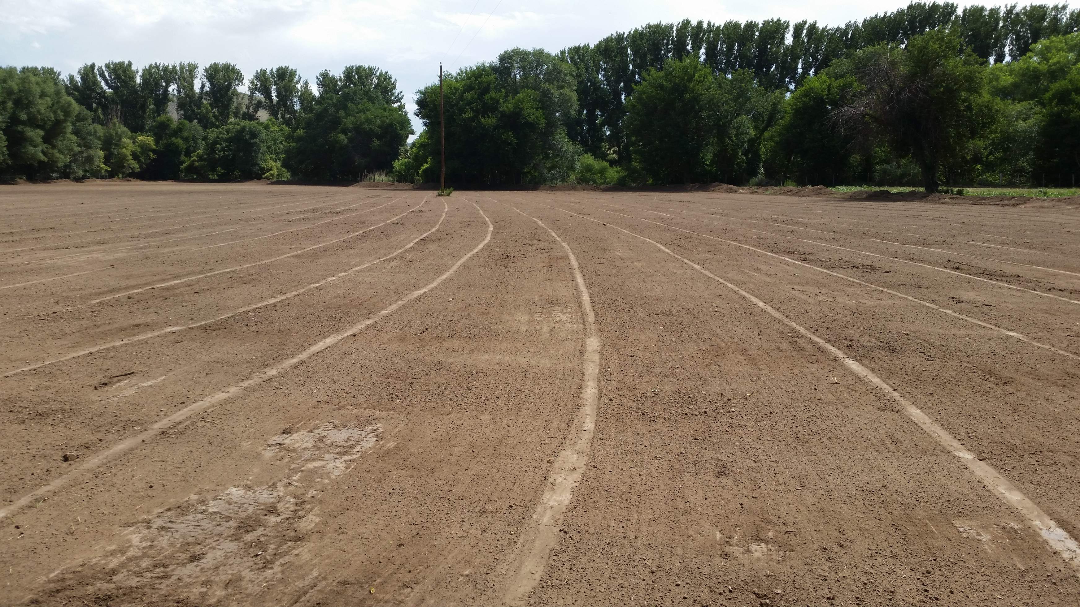

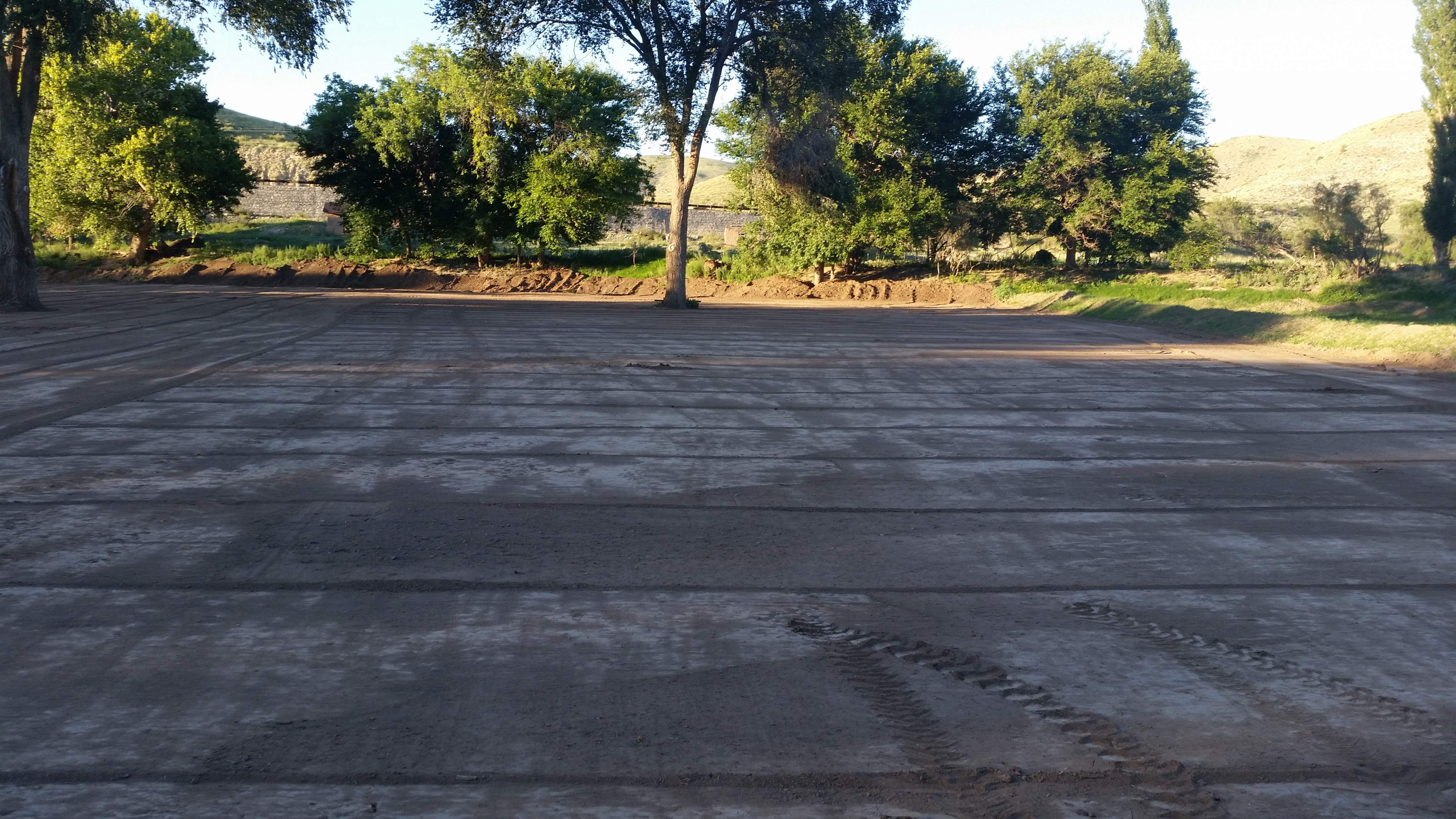

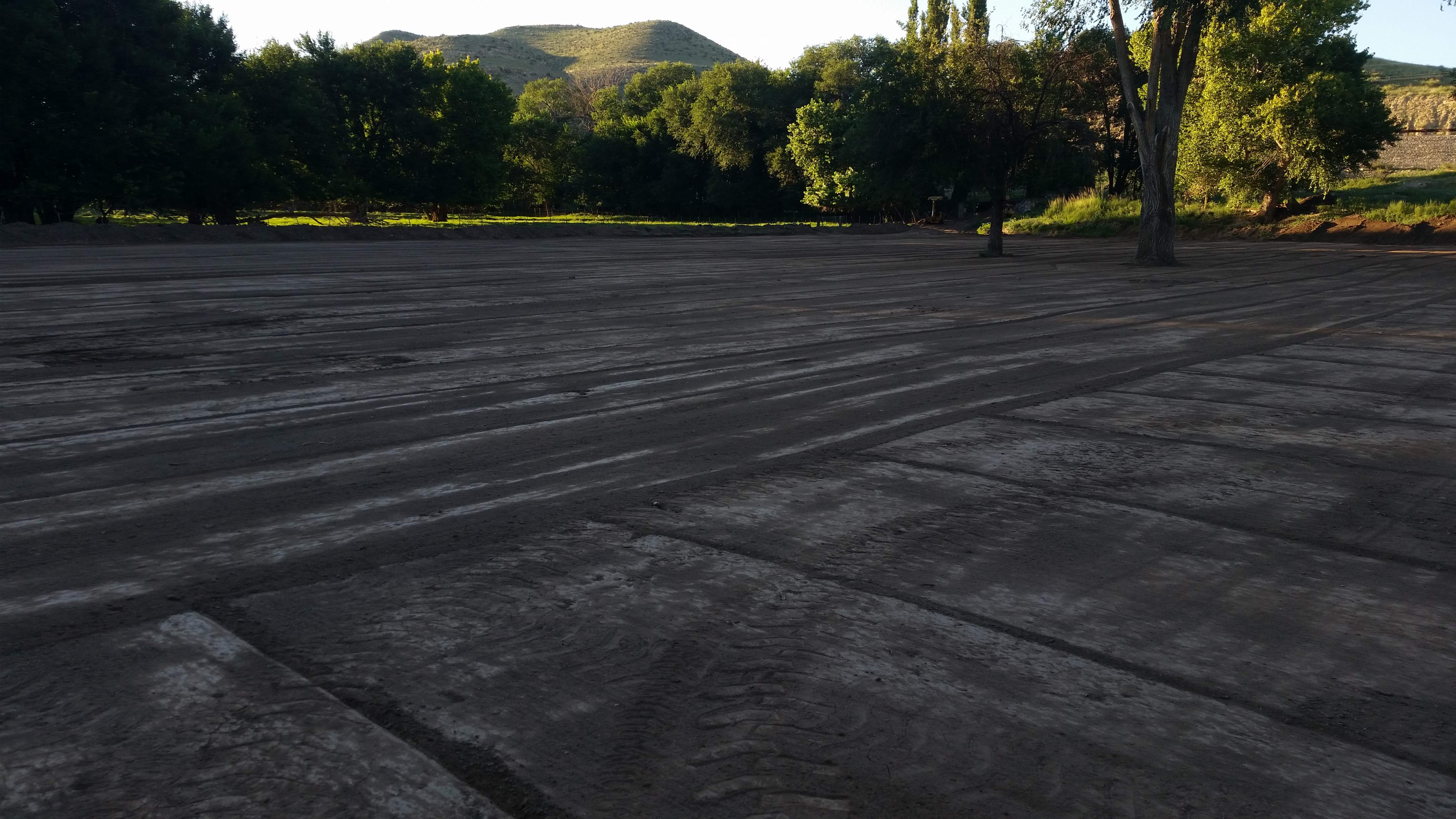

Below are pictures of my tractor and box blade and pictures of some small fields I have used this on.
In the second picture if you look at the hitch you will notice I am connected to the inside hitch clevis on each side this is for cat 1, if you connect to the outer clevis set that is for cat 2.
Hi Jenkins, I'll get a picture of the top of the box blade the next time I'm at the ranch. Wow, I wish my soil was like that in your picture. That's such nice dirt you almost don't want to plant anything on it :laughing: Great information, thank you. I'm thinking the new 5045E since JD is offering free money right now. But maybe the 5055E would be better. Do you know what the difference is in the "E" series vs the "M" series (I see JD makes a 5055M as well).

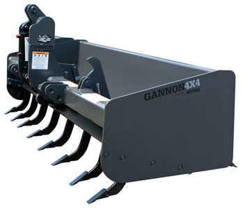

   / Help Selecting a Tractor for my Gannon HSD 72" with hydraulic rippers #28
If you have the double clevis ears then it is a cat 2 hitch. You could have the inside clevis ears/tabs added to go with either cat 1 or 2.
