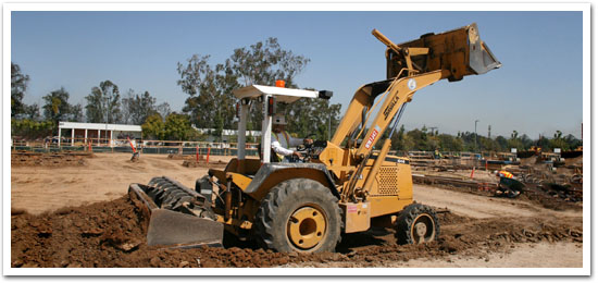

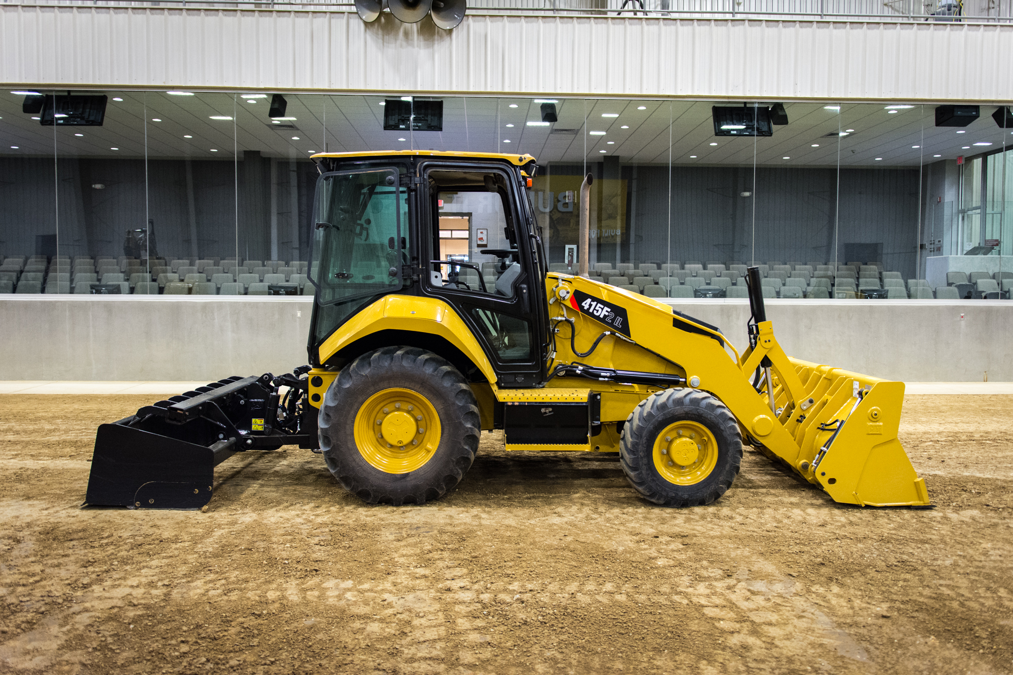

No offense but a 45 HP tractor that weights just over 5,000 pounds with a cat 1 hitch and no down pressure is going to severely limit what you can do with that blade. I owned a 45 hp kioti before my JCB and can't imagine hooking a big blade like this to that Kioti.
That is a big heavy blade and will require a heavy tractor to get the most out of it. Tration will be a major issue with a lightweight tractor using a really heavy blade. That is why I would recommend looking at Industrial type tractors, skip loaders, or TLB type of setups without the hoe. They are built heavier and simply work better for applications like this.
I know it doesn't seem like a big deal as most tractors do not have down pressure but once you use a tractor with down pressure you really see the benefit, especially for this blade or for things like post hole diggers. There is a big difference in the blade sitting on the ground versus pushing down with a few thousand pounds of force. Suddenly the blade is much more useful.
One good indicator of this is looking at what types of tractors come with this type of blade from the factory.
You will also notice that many of these industrial tractors which are already heavy to start with also use extra weights on the rear wheels. Weight is key for getting traction while using a blade like this.

I agree that a skip loader or landscape loader is great for box blade work. But remember this is a 72" box blade and the skip loaders are using 84 and 96" blades. A skip loader is wider than 72".
My box blade is 84" and I pull it pretty well with my 4520 compact fully weighted. A larger skip loader would do better though.
