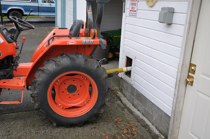

BKBoiss. No unfortunately not. I'm going to pull it of the garage and hook it up to the electrical outlet which is next to the garage (if that makes sense) It will run outside the garage... but stay inside

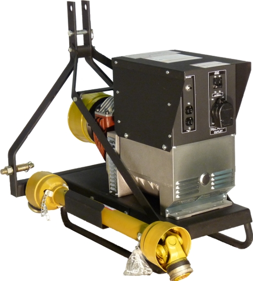

I called Kubota.. they will do my PTO shaft for $10.00. I can't go wrong with that. I like window shopping there anyhow.. so its a win win.
The one I purchase was the IMD 16 KW with AVR, 3 point hitch assembly and PTO shaft.. All out the door was $1852.02 USD.
IMD 16KW PTO Generator
This is what it looks like. Same setup
It already has a platform.. I just want to make it mobile. So that is why I'm adding the dollies.
