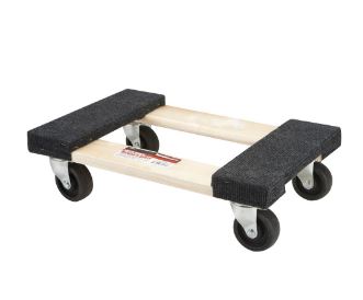

/ Help setting up tractor for multiple attachements #17
Although 2 dollies like Parton would be a nice addition to my work area upkeep is expensive.
For the OP I suggest getting a pallet to set the equipment on and a couple of Harbor Freight's
dollies for rolling things around.
I've two under my 5' box blade, 4 under my Jinma 8" chipper. Those and a set of Pat's Easy Change make positioning and hitching rather easy.
I wait and get the HF dollies on sale for about $7, and with 5,000 square feet of concrete in my workshops they are well worth the $7.

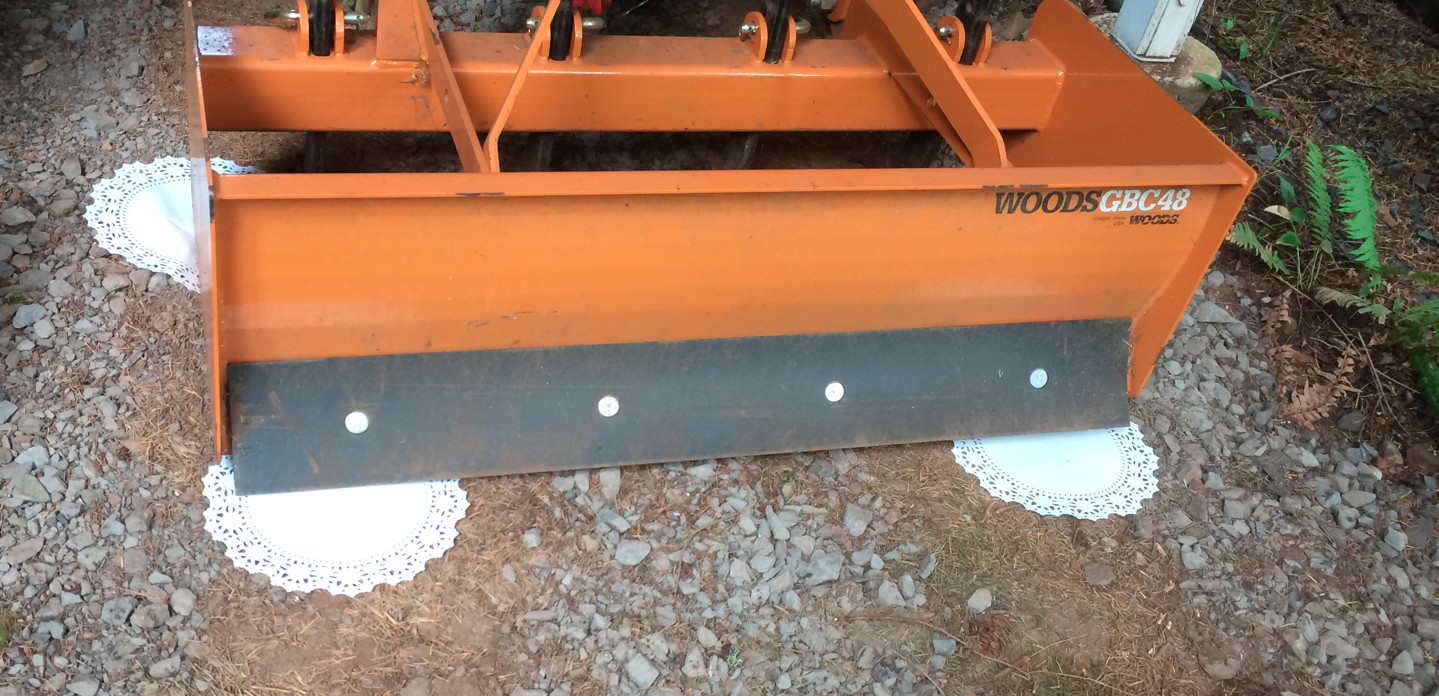

/ Help setting up tractor for multiple attachements #20
Interesting play on words with dollies/dollys/doilies.
