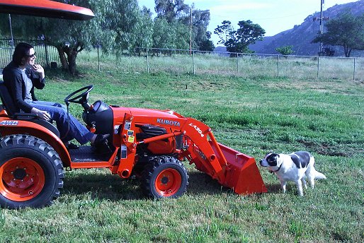

I went B2320 mostly because I didn't want the "limited" PTO category. It was delivered yesterday (with FEL and box scraper). So, now I am an expert. :laughing:
This little tractor is awesome. I had some immediate issues with the Gearmore RFM but the dealer response (Pauley in Escondido) was excellent and we are squared away now. In fact, they are going to comp me some loader forks for my trouble, which were really dealer prep related.
I had the same concern about the tires but they talked me into the R4s and there has been no scarring of turf. Unless you have a golf course or cemetary it doesn't seem to be an issue.
I should be getting some serious seat time today. For me, it came down to B2320 vs. JD 2320 and the dealership was the difference, along with the Med gear speed. Here on day two I am really happy. Shortly I will begin mowing the neighbors 2 acre fire hazard and I will probably be somewhat wiser and "even" more experienced by the end of the day.
I considered the BX but the front axle height (I think 7.5" vs 12") was another factor in my decision. I can see where a smaller property with slopes might suggest a tractor with a lower center of gravity, but other than one little area, I don't have that issue.
