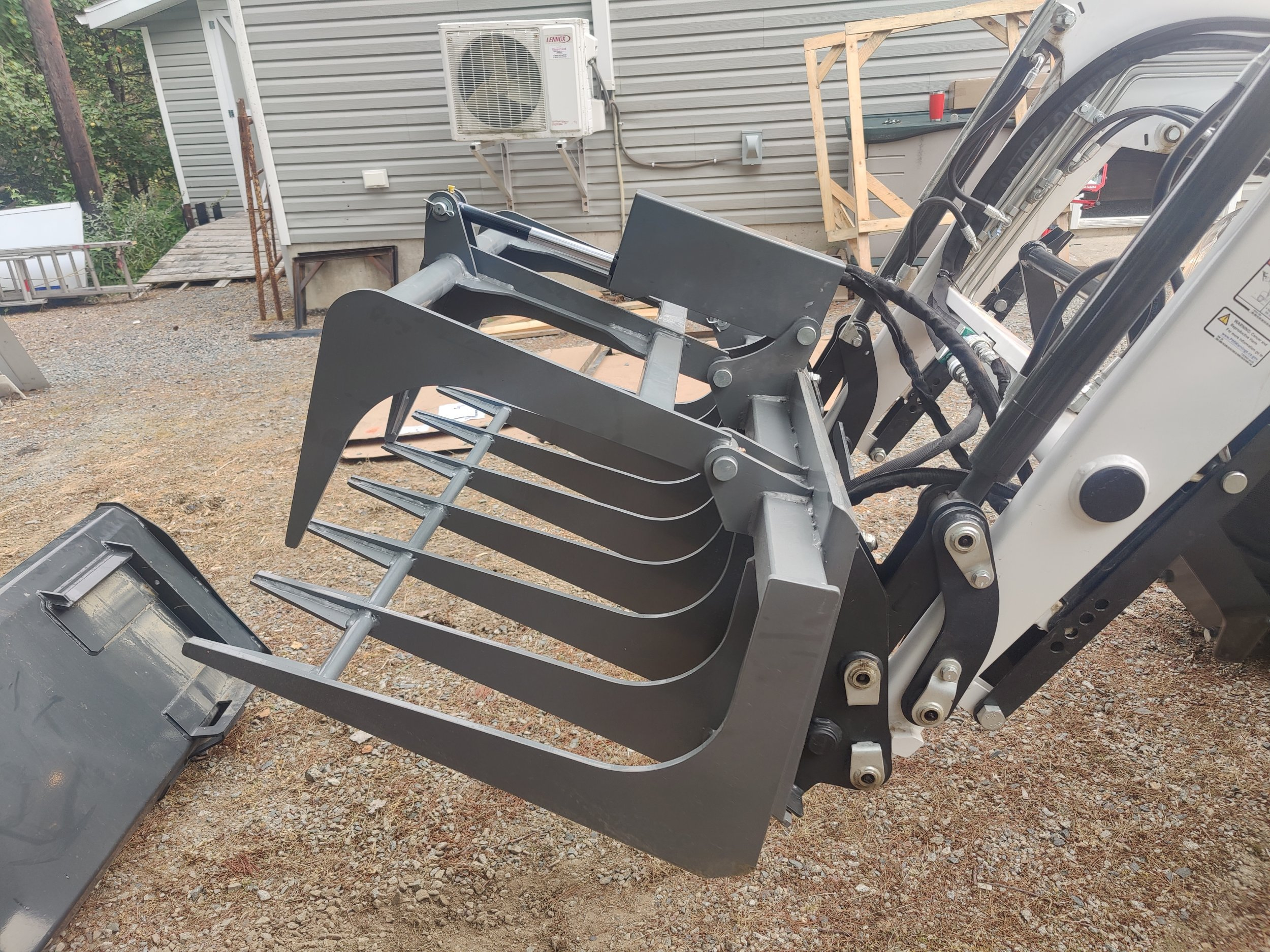

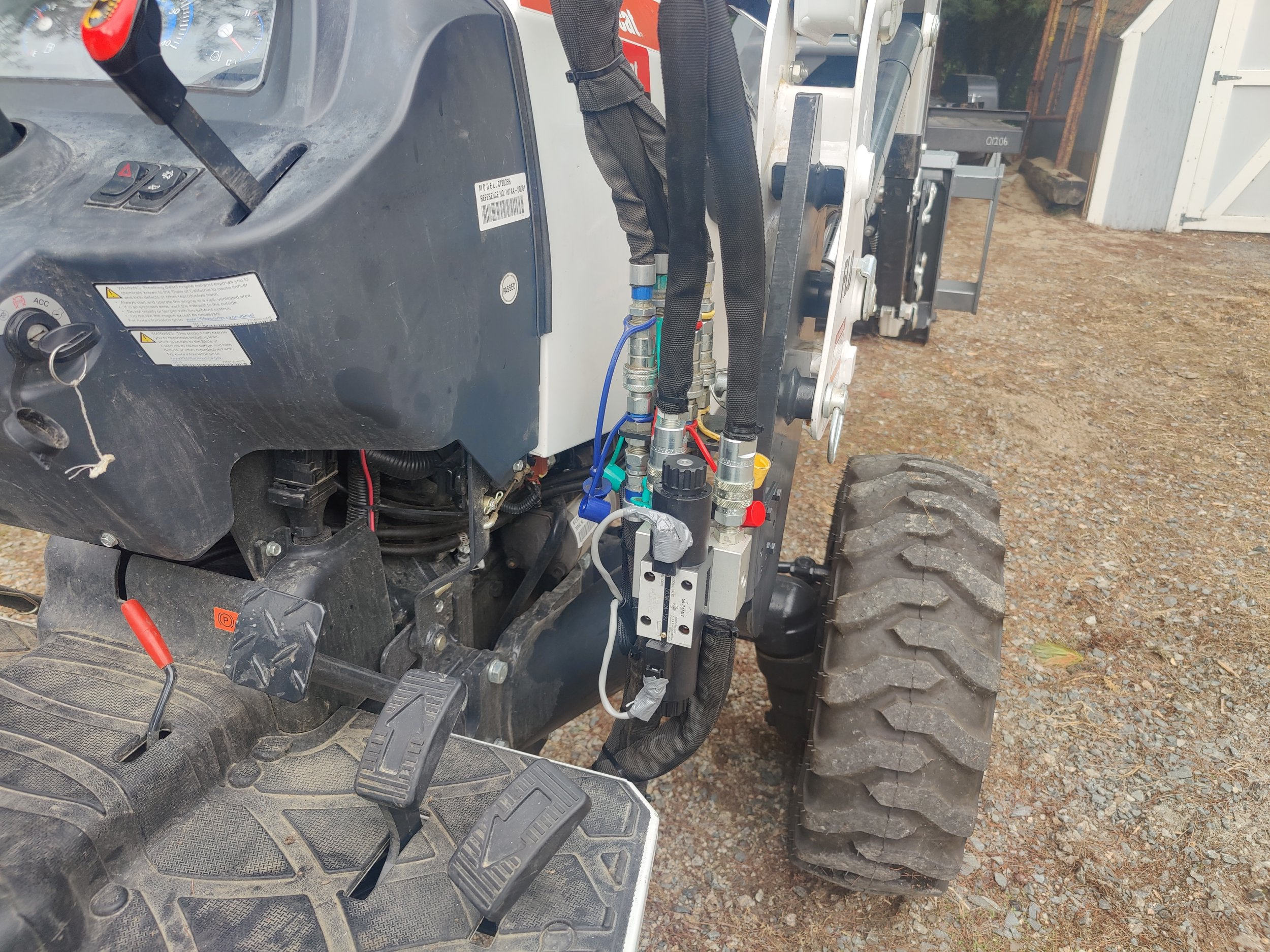

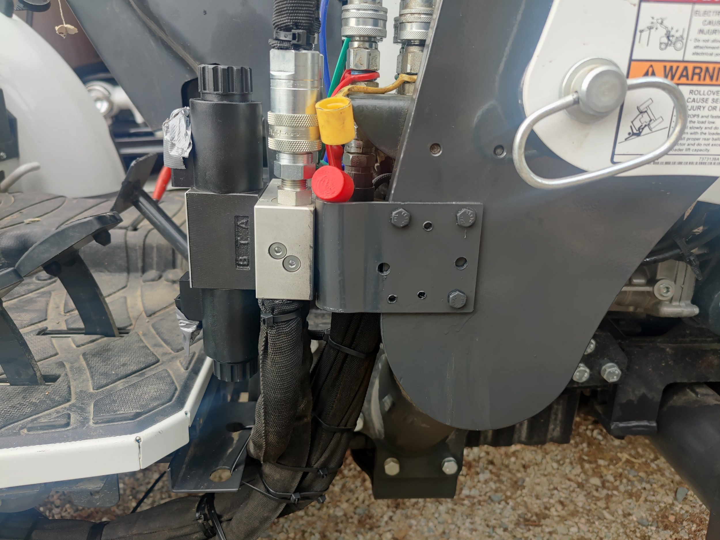

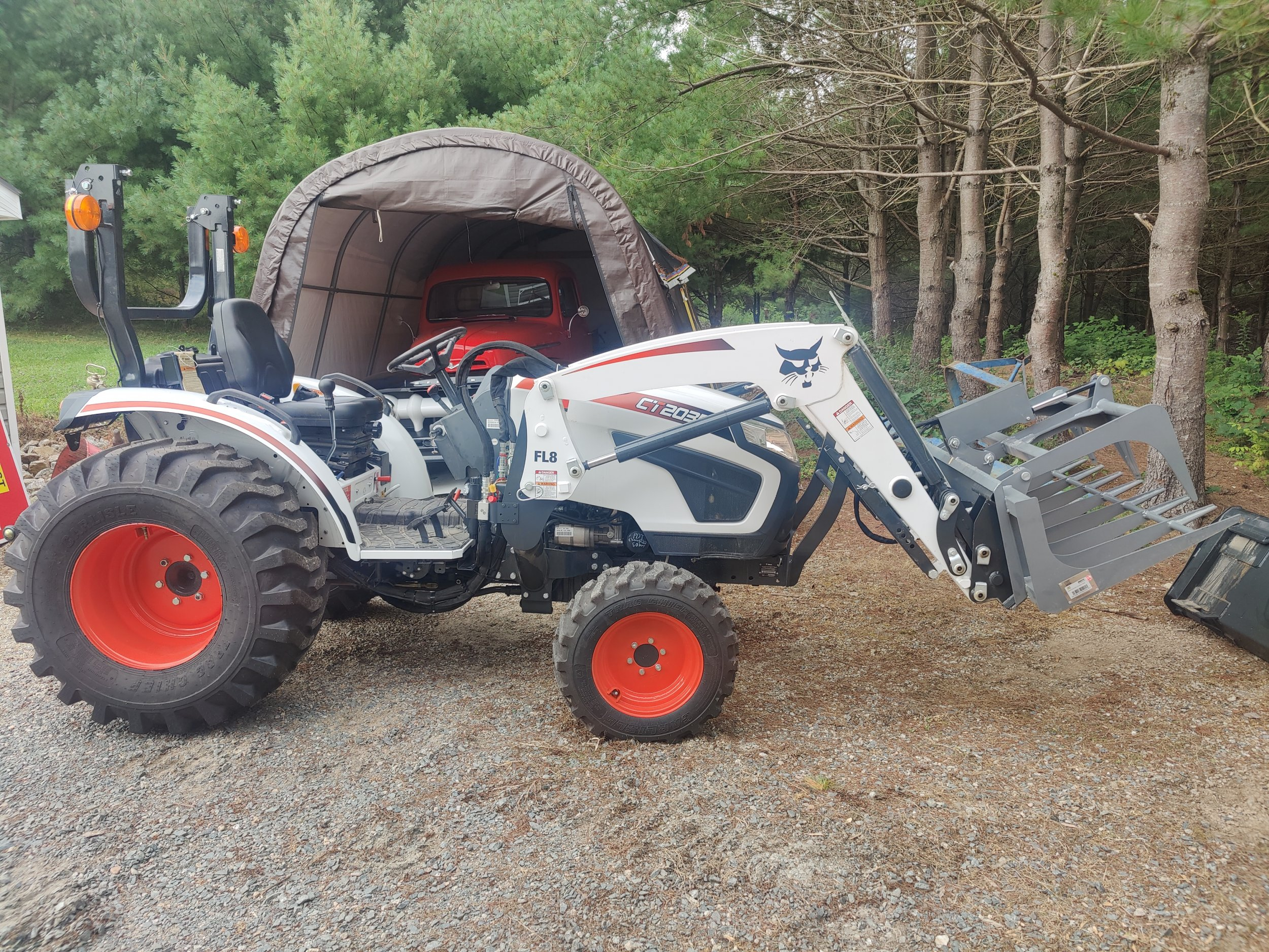

Ok finally got around to reconfiguring the install to work how WR Long does it. What I had worked, but this is much cleaner and easier to remove the loader. Pretty happy with the install. A bit of paint made it look almost factory. Haven't put it to work yet, but liking the grapple from peavey Mart too. At $1400CAD, a good deal, even if it isn't as nice as the EA one.

Thanks. I bought a Kioti 3rd function kit which fits ok, much cleaner than some of these universal kits.... but I can't seem to find the power connector everyone is talking about? Is it not on the BobCat? If I can just connect into a fused circuit that would be much cleaner.
   / Help with 3rd function install
#20
We added a fuse to the fuse box and ran the power to that fuse. The universal kit I got said to run it right to the battery and had an inline fuse. But I figured it would be cleaner to use the actual fuse panel.
