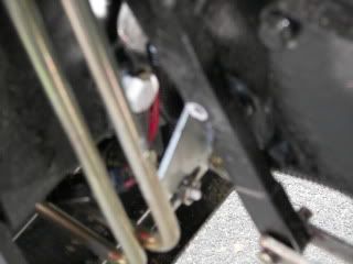

I know that when I push in the clutch all the way my PTO stops, it rein gages about 1/4 release , hard to tell with my foot...
now I only have 10 hours on it,, and when shifting into 1,2 or 3 it will grind in ,, my brake is on I am stopped, I even throw my clutch in all the way and let the PTO stop.. and no matter what I do I can't get it to stop grinding in.. shuttle shift some times...
any ideas

If this is your first gear type tractor, perhaps you don't realize that there are no synchros - either for the tranny for the shuttle. Shifting the tranny on the fly requires a lot of practice to minimize grinding, and even with double-clutching a "grind free" shift is not a given. Shuttle shifting MUST be done with the tractor at a COMPLETE halt.
The 1/4 engagement does make it sound like a clutchpack alignment may be in order. But one other simple adjustment may avoid having to split the tractor. If it still grinds putting the tranny into gear with the (running) tractor at a complete halt, the problem may be in pedal travel. When you push the clutch pedal all the way down, it strikes a stop bolt sticking out of the side of the bell housing. If that's out too far, the pedal doesn't make full travel - and the drive clutch will not fully disengage. Loosen the lock nut on the stop bolt, turn the bolt clockwise a few turns and try again. If/when you find the point where the grinding stops, dog down the lock nut.
Understand that there are variations between/among many of these Chinese tractors, so this description is generic. It's compiled from what I've seen on those KAMA/TaiShan/Foton/Jinma tractors that I've worked on over the years. But hopefully it's close enough to your setup to be of some assistance.

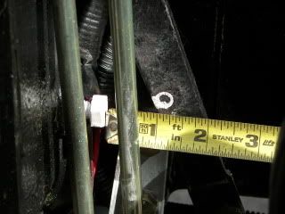

I adjusted it to it's maximum throw, and if you notice the start switch is at its min. length , for me to have the arm move any farther in, I have to move the switch/ Becket to some place else... the clutch does disengage , but the gear chirps/grinds to stop the gear rotating as it goes in...
I am well aware of the straight gearing in the tractor, and it doesn't have syncs,, the funny part of it is I can up shift on the fly, ( on the move)
without any grinding... but stopped it will chirp every time...
please explain what a clutch pack alignment means and how you go about doing it.. and what measurement you use...and where you get the info from...

It involves setting the stack height, then leveling the two sets of fingers so - once the tractor is reassembled - the two sets of fingers will be equidistant both from each other, and from the TOB face. In some cases this is done on the bench, in others you can do it while the clutchpack is still bolted to the flywheel. But I've never seen an inspection window big enough to do one from the outside. Splitting the tractor is pretty much a given.
As far as the specs, it's unsafe to assume that the ones I gave you (for my clutchpacks) apply to yours. There's an overall stack height, there's the distance between the two sets of fingers, then there's the fine tuning to equi-distance each of the six fingers. The numbers I gave you earlier actually came from my operations manual (not the parts manual). But it appears that your clutchpack is newer than the operations manual that came with the tractor. Tommy and Ronald are clearly in the same position as you; new style clutchpack, no specs.
