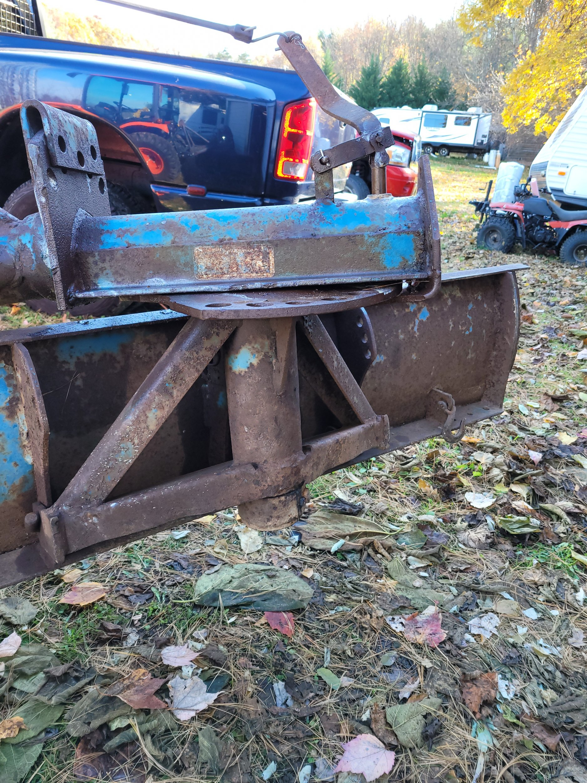

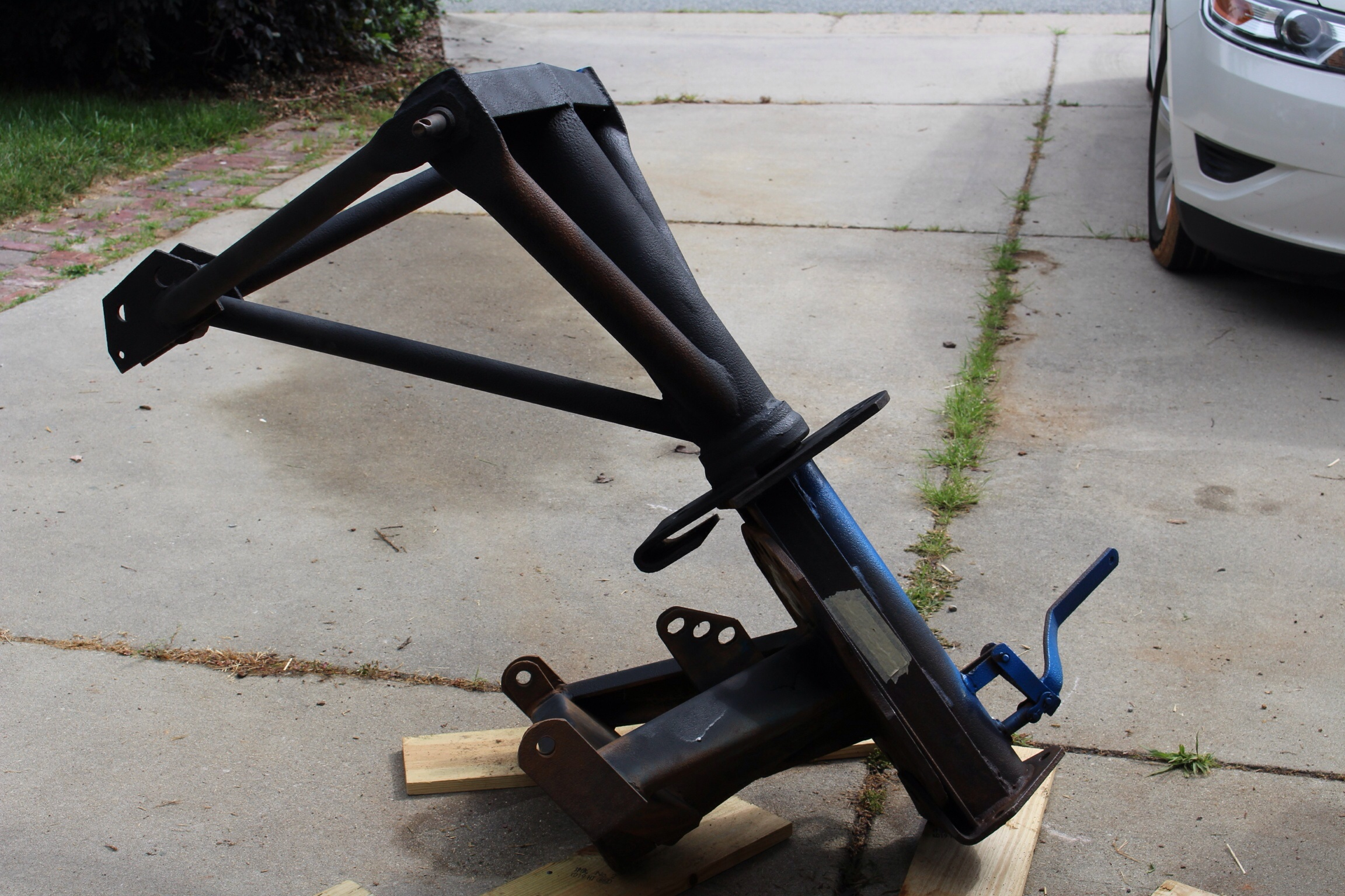

Hello all. Its been a good while since I have posted anything here. Good to be back though. I am in need of some help. I got myself in a mess. I got this old ford blade and I am hoping someone here can give me some pointers to getting this thing apart. It is rusted up inside. I can get the blade to spin on a flat axis by bumping trees and bottle feeding it PB Blaster. I plan to pull it apart but I cant see how the get the tilt apart. Any suggestions? These pics are from another post but the fella never got much of a response. Mine is just like it though.

Heat, candle wax, PB, movement is all I know.
I believe that for many of these scraper blades of this design disassembly involves cutting the welds off. I can't see enough detail to be sure on yours.
FWIW: I have an oil injector for "frozen" zerks that is quite effective at forcing light oil into otherwise fixed surfaces.
All the best,
Peter

Agree that it likely isn't made to come apart.
The outer round tube where it tilts.....hit it with a hammer all the way around. Don't have to whale on it....but decent hits all around. Knock some rust loose.
Keep feeding oil

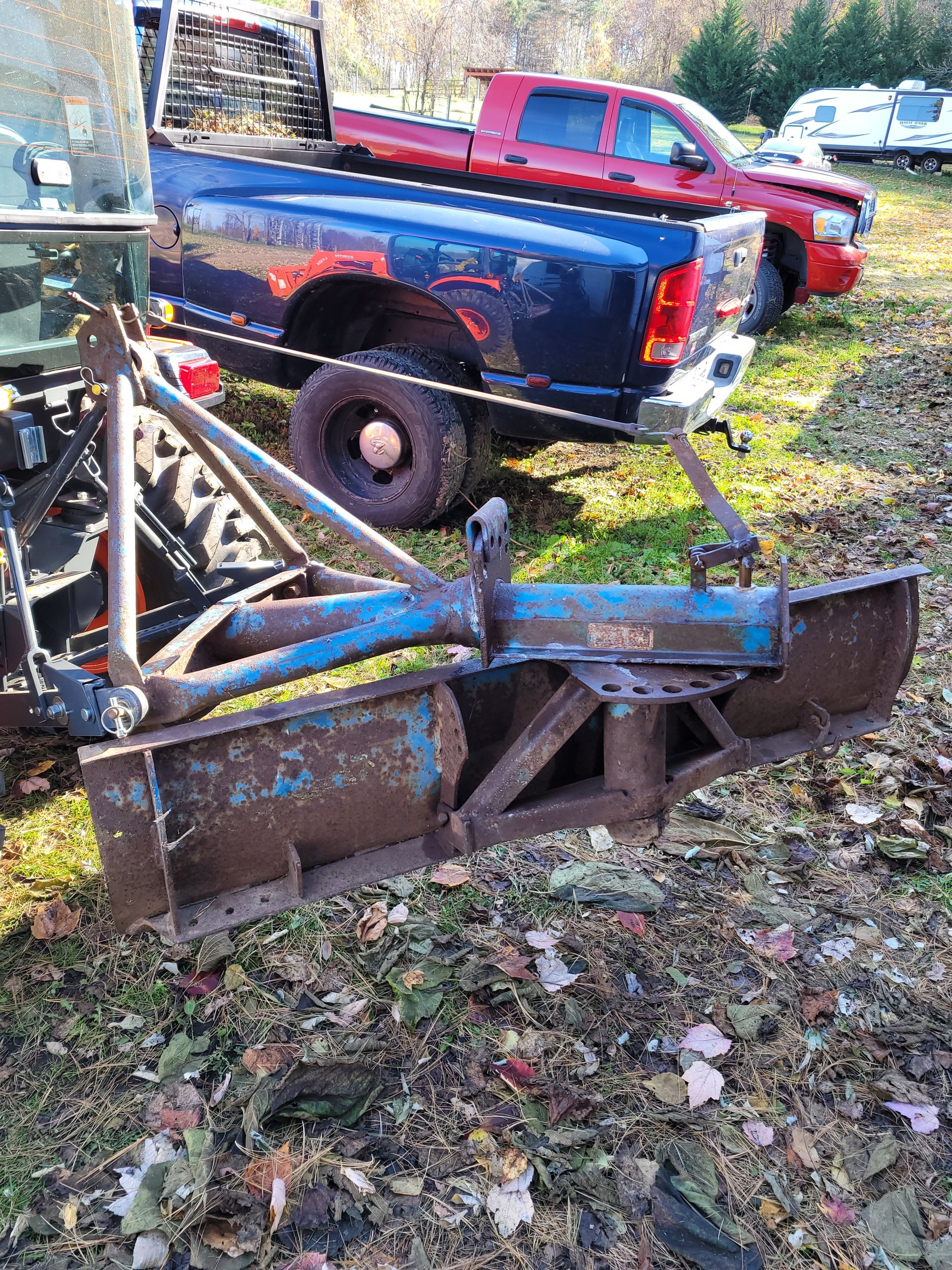

/ help with a blade
Here are a few pics of my blade. She was thirsty this morning so I finished off a can of PB. More banging and still not much progress. Can't get it to spin perpendicular so I can start trying to pull it off the shaft. My little yanmar and my kubota just don't have the ...you know to swing it around. I think a torch set up needs to be in the mix. It's just not in the budget right now

In my limited experience (photo above) tilting the blade side to side by lengthening one side of the 3-pont lift didn't do anything. Friction against the road surface offset that adjustment.
Adding ballast to one side (photo) helped some.
So for this project, I wouldn't consider the tilt a priority and would concentrate on the horizontal angle. Possibly after your blade has had some use, the tilt might loosen up.

/ help with a blade #16
Gonna pick up a few cans tonight. Found a bud with a torch. Hopefully in a few weeks when our schedules mix we can get down to business on this old thing
Meanwhile, Harborfreight sells a half million BTU propane torch that I have found to be quite useful. Pretty good for weeds as well.
I would second @California's comment about hooking it up as is and using a roadbed to work things loose.
Looking at your photos, I believe that your design does disassemble. For the left/right, I think that there is a bolt on the bottom cap that needs to come out. Some versions that I have seen unscrew at that point and some come off. For the top (yaw), I think you need to rotate the plate beyond the flange.
