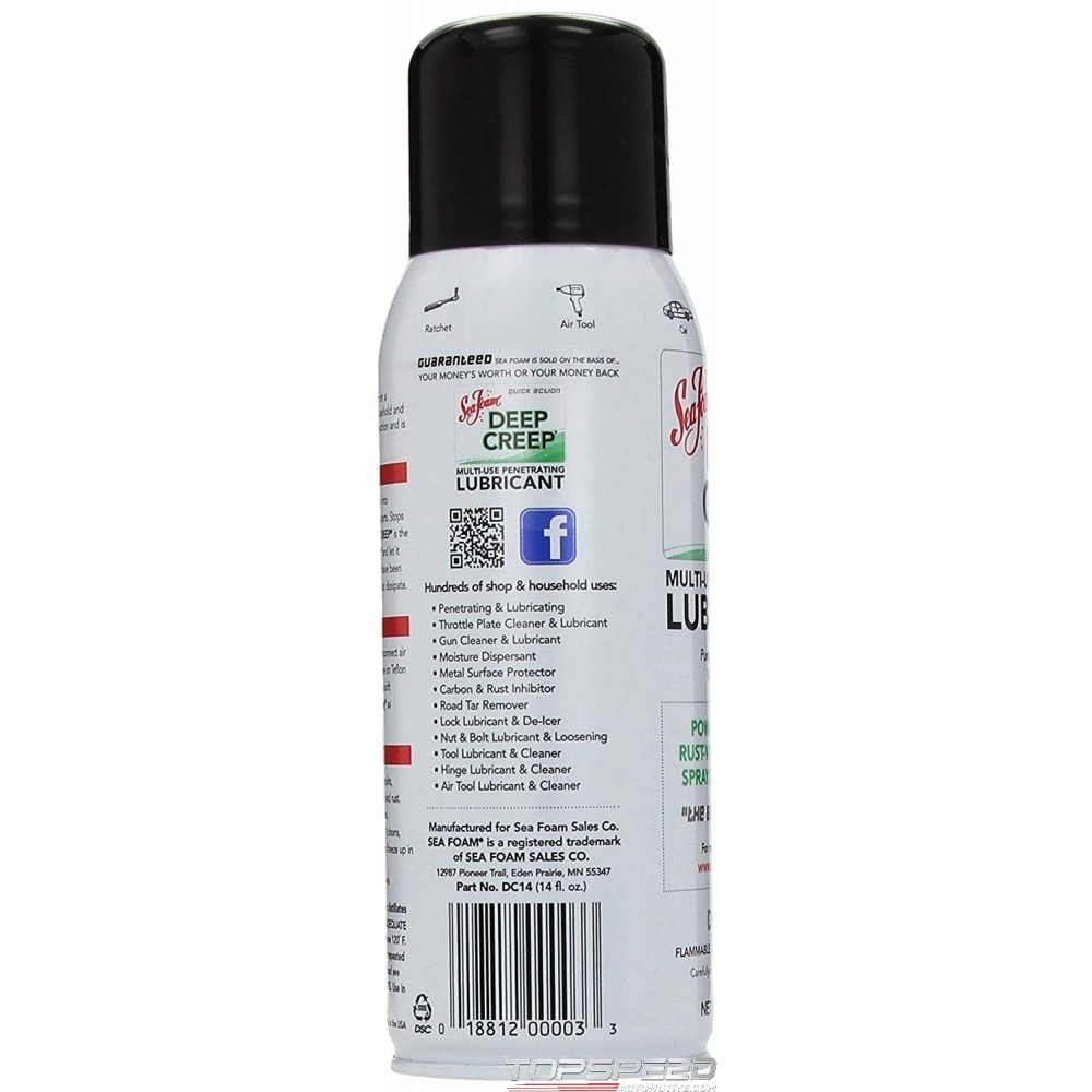

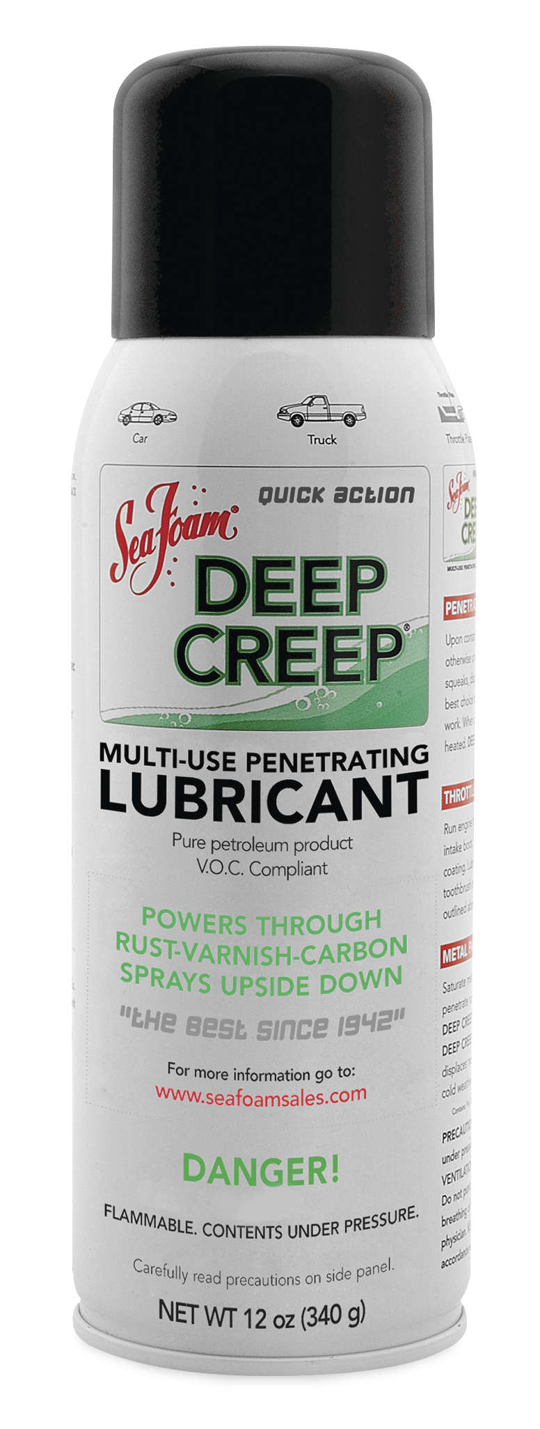

I completely agree with LD1 regarding roll of the blade being less practical than yaw. It would be nice to have it functional and operating as it should though. The roll has loosened a bit and I actually had to knock it back in place by about a half inch. The yaw is what I am primarily concerned with so I can rotate around to push or pull snow, gravel and all the other things people push and pull. On this blade there is a cap at the bottom of the shaft. The blade mount slides over the shaft and the cap retains the blade mount. I can't tell if it is threaded. It had a 3/4 pin through it. If the cap does screw on I will just cut it off and repair it later. I am going to mix up a batch of ATF and acetone and alternate it with Deep Creep for a week or 2 and see if lighting an acetylene fire under its ..you know, will get it moving. I was trying to visualize a press of some sort but cant come up with much right now. I have a 20 ton air over hydro jack. I'm not a welder but I did save a lot of money by switching to Geico, and I know a guy. In the mean time I am going to re grade every darn gravel drive I have. I found this reply on a post on Bob is the Oil Guy and thought it was interesting. For the old salts here you all probably already knew this. Hey maybe it will help someone who didn't know though.
