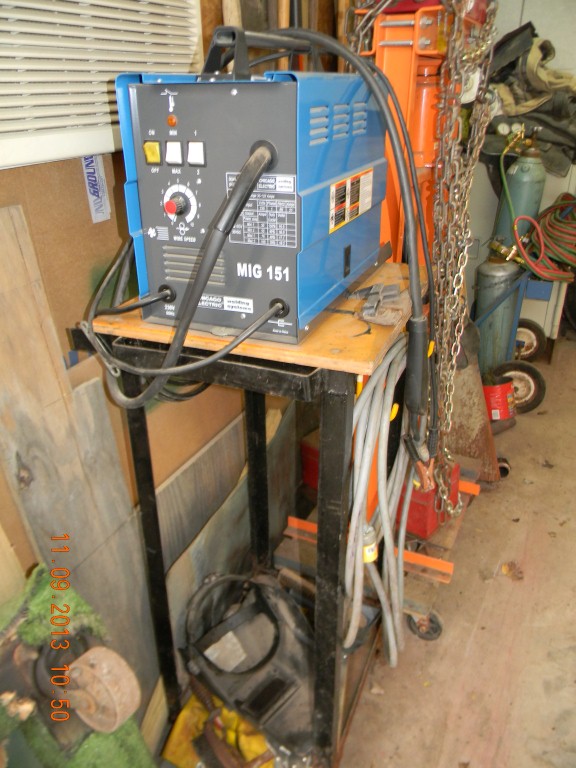

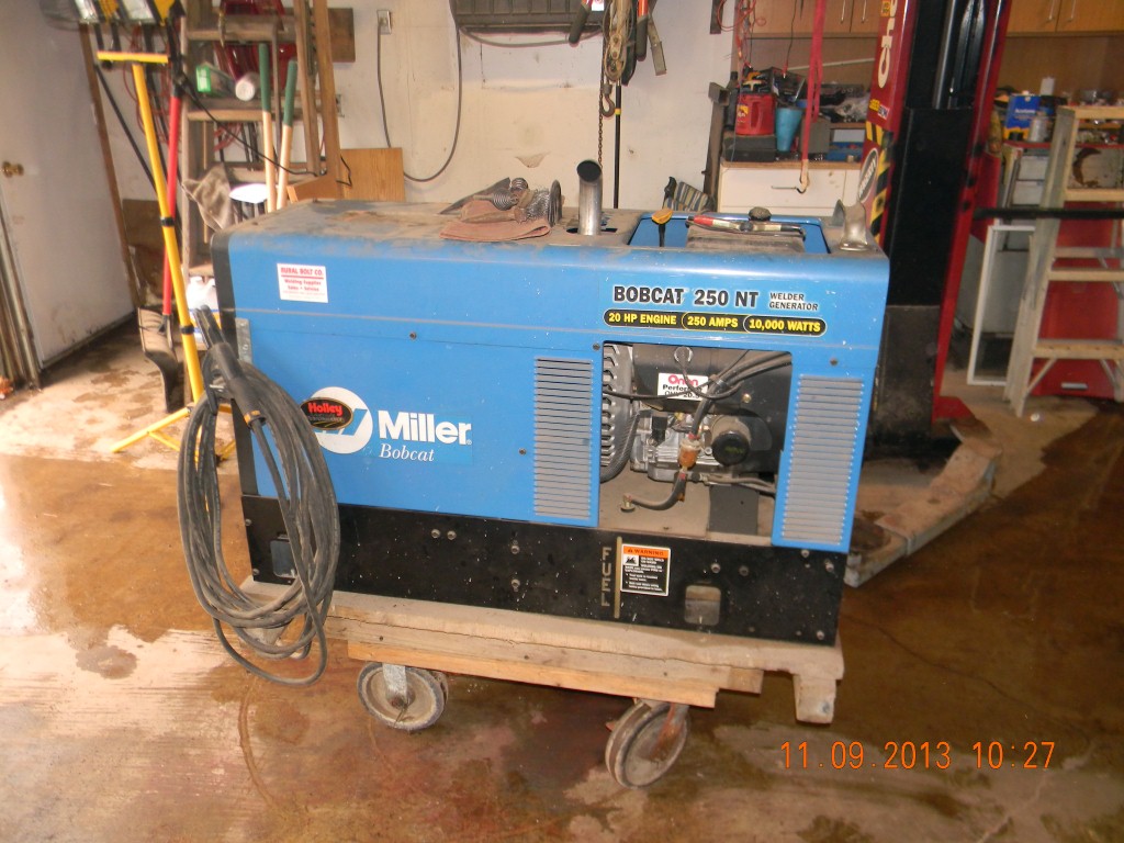

If you buy a separate generator and 220V welder the generator will need to be large enough to power a 220V welder. I have a Miller Bobcat 250NT welder generator. It is a 10KW unit and does power my entire house when needed. My previous 5KW gen would not power the whole house with A/C running. I mounted the gen on wheels to move it around but is very noisy using as a generator. As a welder it does have the idle down circuit when you pause while welding. I don't like using it for small welding jobs due to the noise. The nice part is I have 40' leads to get away from some of the noise and can use it in the field if needed.
I also have a 220V welder I bought a few years ago at a flea market and a cheapie HF wire feed mig welder.

Yep I think the Harbor Freight mig welder might be all I need. I forgot all about the noise issue with those big welders.
