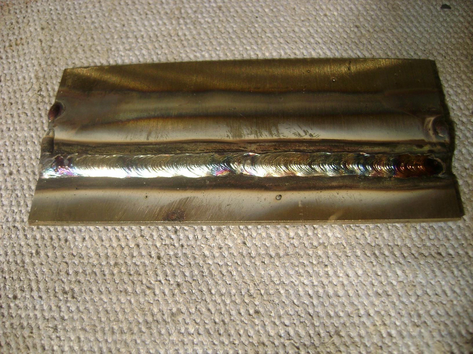

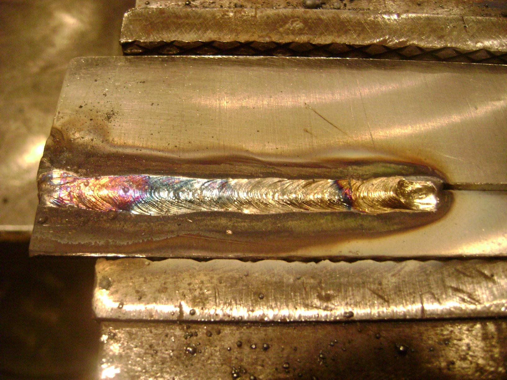

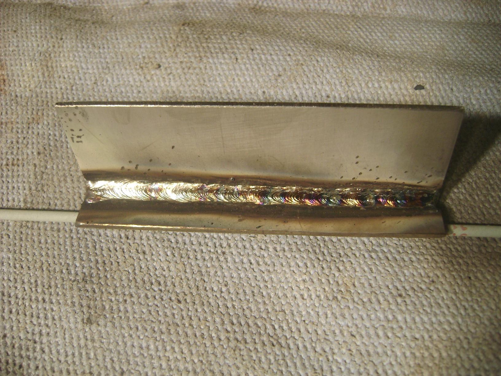

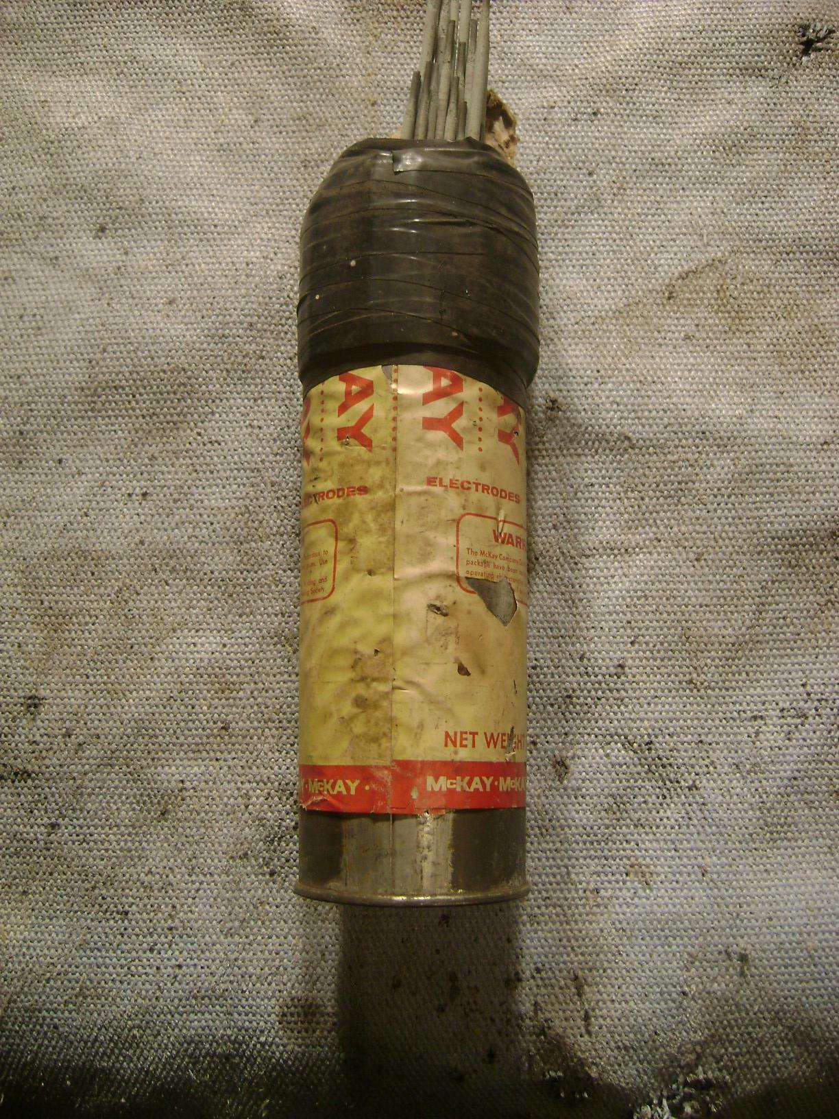

Here is some 316L-16 I got in the early 1970s, couple years ago I came across it and gave it a try.
