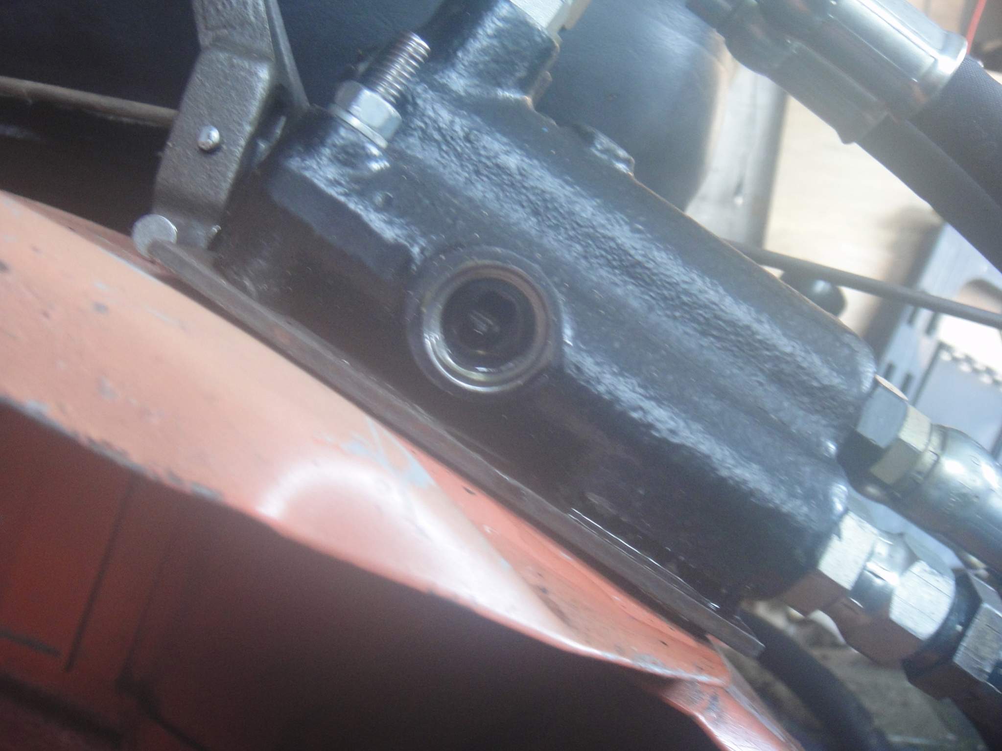

I replaced my old 2 spool valve with a new eaton 31922. It works fine but squeals when not in operation. This is a KB 7100 tractor . To operate the loader you pull a lever under the seat back. WHen I do that, I hear a squeal. In lift or curl, no squeal. Eaton says this is an open center valve, so what have I missed? Thanks

Take PB fitting out and the plug you put in move it to the valve body where you took the PB fitting out. You are not using PB.

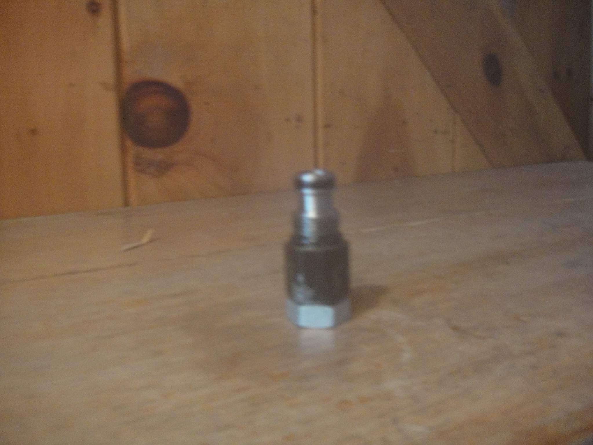

I took the valve to my local tractor shop and asked for a plug for the power beyond port, and they handed it back to me with the plug and sleeve installed.
I took it as making do with what was on the shelf, without thinking it might cause a problem, as it appears to do.

Here are the photos of my plug- I begin to see where you were going with this.
A simple plug would have been more to the point. I think the dealership figured the groove in the fitting would suffice for the outport, but if I understand you, it didnt! I will try and find a proper plug today. PLUG.jpg

That is exactly my point.
If you want to use that valve as others have suggested by just plugging the port you can certainly do it, but the manufacturer recommends to run the OUT port to tank because of the about 500 psi limits on the internal parts of the valve.

Did you try the plug that is still in your PB fitting? It just might fit, some well.
Might save you a road trip.

Immediate problem resolved!
Replaced the fitting in my PB with a simple plug and now the FEL works as it should.
