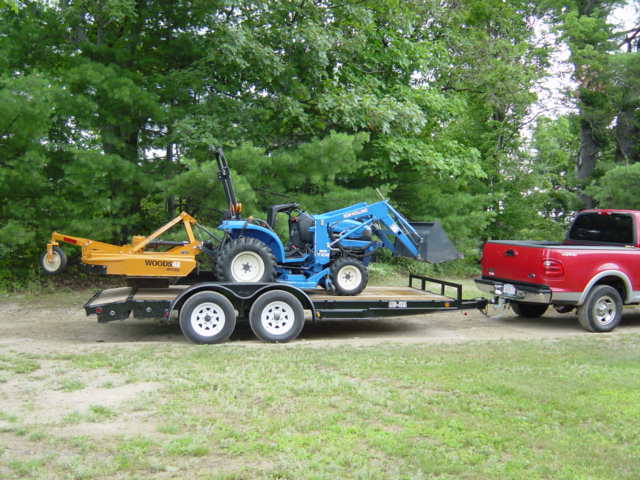

PS: You do pull your tractor with this truck, right? (Obligatory tractor content.) /forums/images/graemlins/grin.gif

Yes I do trailer the tractor with it see pic.
