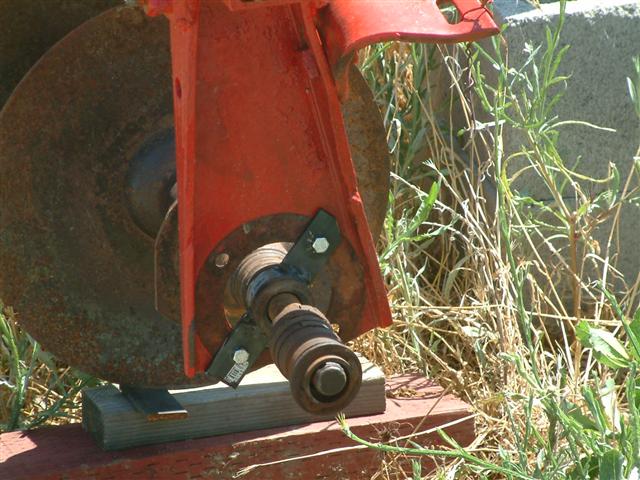

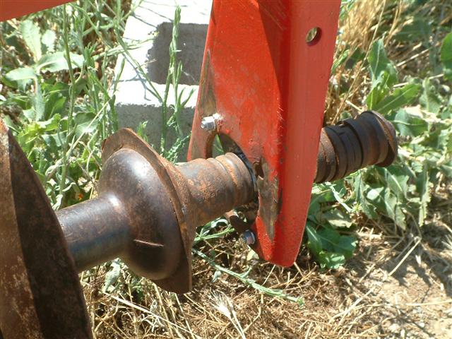

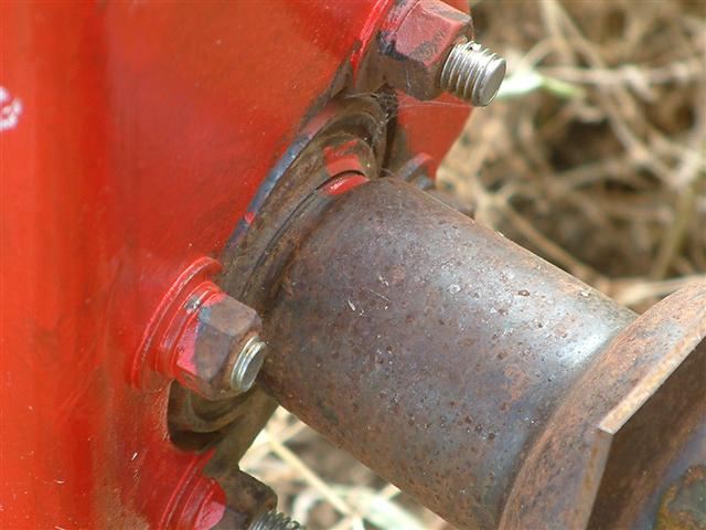

I ran into a similar problem with my Minneapolis Moline KS-1300 wheel disc a few years ago. An outer bearing was a mess. Couldn't find a replacement. So I rigged up a bushing.
IMG_0339 (Small).JPGDSCF0314 (Small).JPGDSCF0006 (Small).JPGDSCF0007 (Small).JPG
Good luck.
View attachment 245379View attachment 245380View attachment 245381View attachment 245382
Good luck.
looks like it is a 1" shaft you should be able to go to any indrustrial place that carry bearings and get a flange mount bearing self aligning, you may have to fabricate a plate to bolt it on these bearings are very cheep
