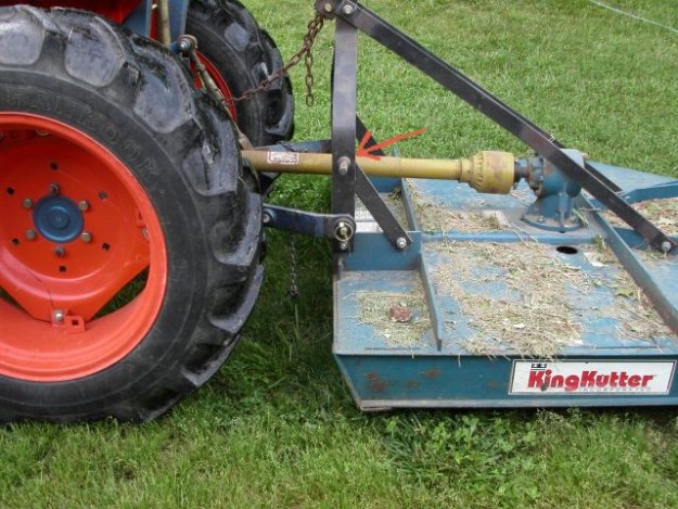

   / Help with top link adjustment for rotary cutter. #37
Here is a picture of the modification I made to my 5ft KK brush cutter. You will notice the original pins much higher. Also see how level the 3 ph drag links are. Can you imagine how high they would have to go with the original pins. It was the same setup with my Kubota L.

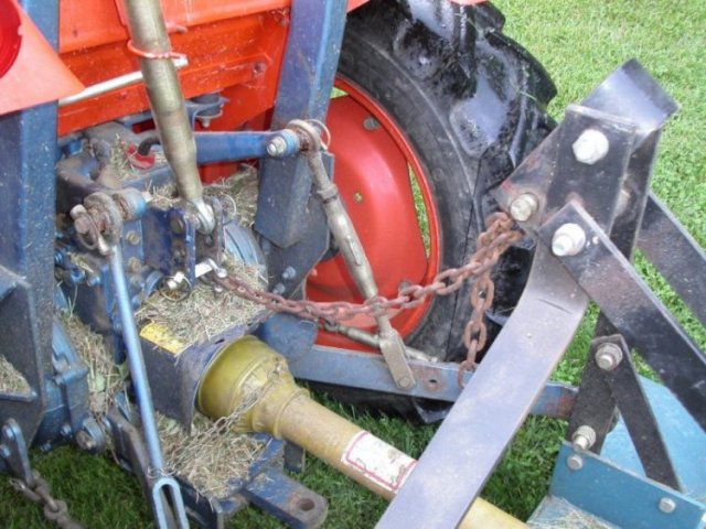

   / Help with top link adjustment for rotary cutter. #39
Here is one of the chain used for the top link.
