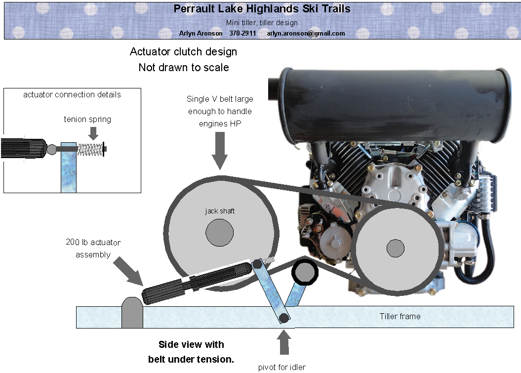

Folks, I'm not a ME and don't play one on YouTube. :eek: I'm putting together a 35hp power drive and need it to be clutched. Since the engine could also use some load shock protection, I thought a few V belts attached right on the engine might work. Lets say 5" sheave on the output shaft but any size could be used, and 5" also on the secondary shaft. Of course an idler would be used and actuated, so as to give it a clutch. This would be operating at 3000rpm or nominal gas engine speeds and in cool temps, like below freezing. Bad or good idea?? And what size V-belt (more than one?) should be used? Thanks!

It will work but also will wear over time.
Alignment will be critical and you'll also want some sort of guides the keep the belt/s in position.
What U describe is a fairly common procedure.
There also exists centrifugal clutches that accomplish the chore but at 35 hp ??? ($$)
I'd suggest looking at snowmobile clutching systems as they are in your HP range.

Clutching under no work load?
Are you starting a high inertia load and what rpm does the load run?
Are you able to start in a throttled down condition then go to working speed?​

Yes, the engine could be at idle or low speed, for engagement. And yes, the clutch would be engaged while not doing any work.
Not sure this is a high inertia load or not, maybe mid?

I'd guess we can get away with one or two C sized standard V belts and keep the tension on the low side for 'emergency clutching" action...
Or are we wiser to stay with just one belt, large enough to not routinely fail? I now see 9" is the minim diameter sheave for this size of belts....

A pair of 5vx belts on a 5.5" or larger pulley will work fine
As far as I can find on google, these belts require these slightly more narrow sheaves? copied below. Thanks!

a single A belt is used as a clutch/power for many 20 hp lawn tractors, and lasts quite long. a single BX or 5VX belt would be good for your 35 HP..
/ Help! with V belt sizing #17
A single b or bx "sized" belt is used on many 25 hp zero turns. But they aren't a typical belt. Mower belts are different. Put a commercial grade B on a mower of 25 hp and they don't last.
Now we are talking an extra 10 hp.....
If it is actually gonna transmit 35 hp.....stick with the formulas. Pair of 5vx like I said earlier. And go a little bigger on the pullies

My concern is that V belts would be susceptible to slippage due to wet as in snow.
Granted snow sleds use belts but generally the protected cab area.

the Idler is on the wrong side, should be on the other side not the side that is pulling, but the side is Idling, check out a belt clutch lawn mower,
the other possibilities I think may work is a electric clutch, or even a centrifugal clutch, of course they would have to sized to the power produced,
hydraulic drive,

The idler will be on whatever side is not under tension. Snow blowers and 100's of other machine types do fine in snow will belt drives. I looked for an electric clutches with shaft sizes that would be appropriate for these 35hp-+ engines and couldn't find much. If you can locate one for a CH1000-2026 40hp Kohler Command Pro Horizontal Shaft Engine, please point it out. Nonetheless, my actuator clutch system can be assembled for $100 and rates as a KISS assembly in my book amateur ME.. A hydrostatic drive will lose in the area of 25% of the engines HP and force the tiller to be that much shorter, than I'd like to use. This is why we'd not consider that type of drive.
