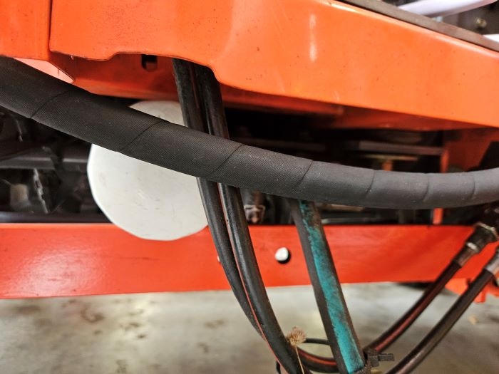

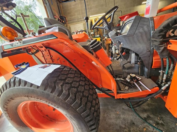

I had to replace the hose that was attached to the PB port on my loader, using W.R. Long's longer hose to run from the PB port to the P port on W.R. Long's valve. I did that. Routing is a little crude, but I can fix that.
1. The hose that used to be attached to my PB port runs to a T fitting under my floorboard. The W.R. Long instructions say to run a hose from that T fitting to the T port on the new remote valve. The supplied hose is pretty short, and the distance from the T fitting to the T port really requires maybe 5 feet of hose. I am not sure how familiar W.R. Long's people are with my tractor.
2. My PB outlet is very close to the floorboard of my tractor. The new hose actually touches it and applies a little pressure. Should I get a fitting to go around it? Will the pressure of the floorboard against the hose cause damage later on?
