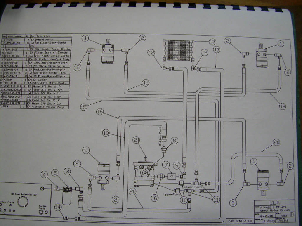

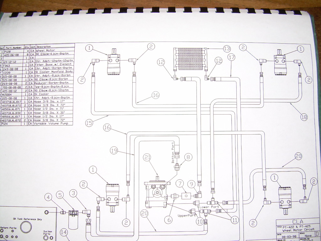

Hi Kris,
Would you scan post those hyd schematics as a file or pictures? I would like to take a look at them
Hey JJ, Ill try to do that tonight....it requires the use of my lovely wife, Im just not computer savy enough to do it myself.
Kris

A series of articles that describes, among other things, the pros and cons of filtering at differing points in a hydraulic system can be found at Hydraulic Tutorials.
They are well worth reading before you start modifying the hydraulic system.
Thanks for the link. Reviewing the section on hydrostatic transmissions Is this problem destroying your hydrostatic transmission? I think I found the cause of my pump failures. Cavatation as a result of stalling out the tram circuit.
When picking up my tractor Terry said to work it hard while it was under warranty and I did. Well I guess I need to back off a bit :D.

Well I found it. My 2008 model 422 has a Bondioli NT10 tram pump. A Bondioli sales rep in Virginia was very helpful with both identifying my pump and finding a local repair facility I can work with if it breaks again.
Once I knew the model number I was able to find documentation on the NT10 via the web. The documentation does not help much with my issue but at least I have something!
  • BondioliNT10 Pump.pdf
/ Here I go again #47
